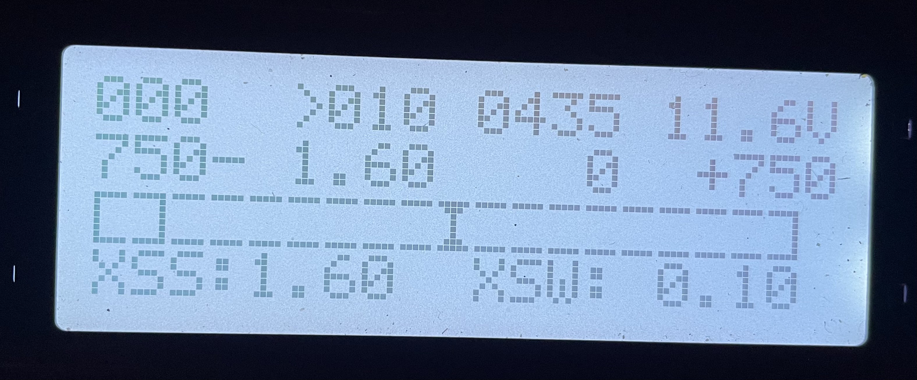

                      • Click image for larger version  Name:	IMG_2881.jpg Views:	0 Size:	985.3 KB ID:	441054
                        I've spent a bit of time on the firmware source, and had really wanted to have a bar graph for showing the balance. And to have the encoder use interrupts. After spending many days using AI and tweaking the code, I've made something I like. Encoder doesn't feel fast, though I once had the code to a point where it did. It's not perfect, but attempts to show all useful variables while also adding a somewhat useful graph-like display.
                        It took me a bit of tweaking to get full sensitivity, or at least, better than before. The design is very sensitive, when build as intended. I used some slightly different parts in mine and it’s taken me a bit to work out
                        After spending much of my spare time trying to improve on this detector, and finally having it work nearly as good as it’s supposed to, I can appreciate something that was talked about in the book ITMD 3, where it said something like ‘shoot the engineer’, meaning it’s time to actually use it

                            I'm not sure what the reaction to gold is like. I had to tune my XSS. But I was also using modified firmware with too large of a Tx pulse. Now my detector seems to finally detect a large silver coin at 10cm. The last time I had gold, it couldn't detect it because my settings were wrong, and I was using modified source code. It was a tiny amount in a small container.
                            This is an updated version that includes a major change in audio and target response. Sine wave calculation sample array has been increased from 128 to 1024. MAGPI008_v1.4b.zip
                            Audio tone needs tweaking, but sounds better when increased.
                            ADC conversions now use interrupts instead of polling. Encoder turning needs tweaking
                            Auto ground balance tracking is included, as well as a different way of doing the exponential target response. Varying coil swing speeds are somewhat accounted for. The exponential rise gives reasonable responses for slow movements, and isn't quite as responsive on the faster movements. It's impressive how fast you can swing things past the coil and hear the response. The detector design is quite good. I like looking at the schematic and learning about it.
