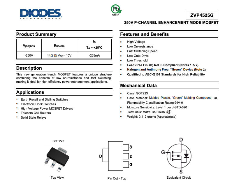

    • There's a potential replacement MOSFET for the BSP230. I had trouble getting genuine ones, though BSP225 can be bought from Digikey. But the DMP45H150DHE-13 appears to be similar enough in terms of low input capacitance, 250mA current and 450Vgs. The biggest difference i can find is Rds On, original is 17 Ω, this one is 150 Ω

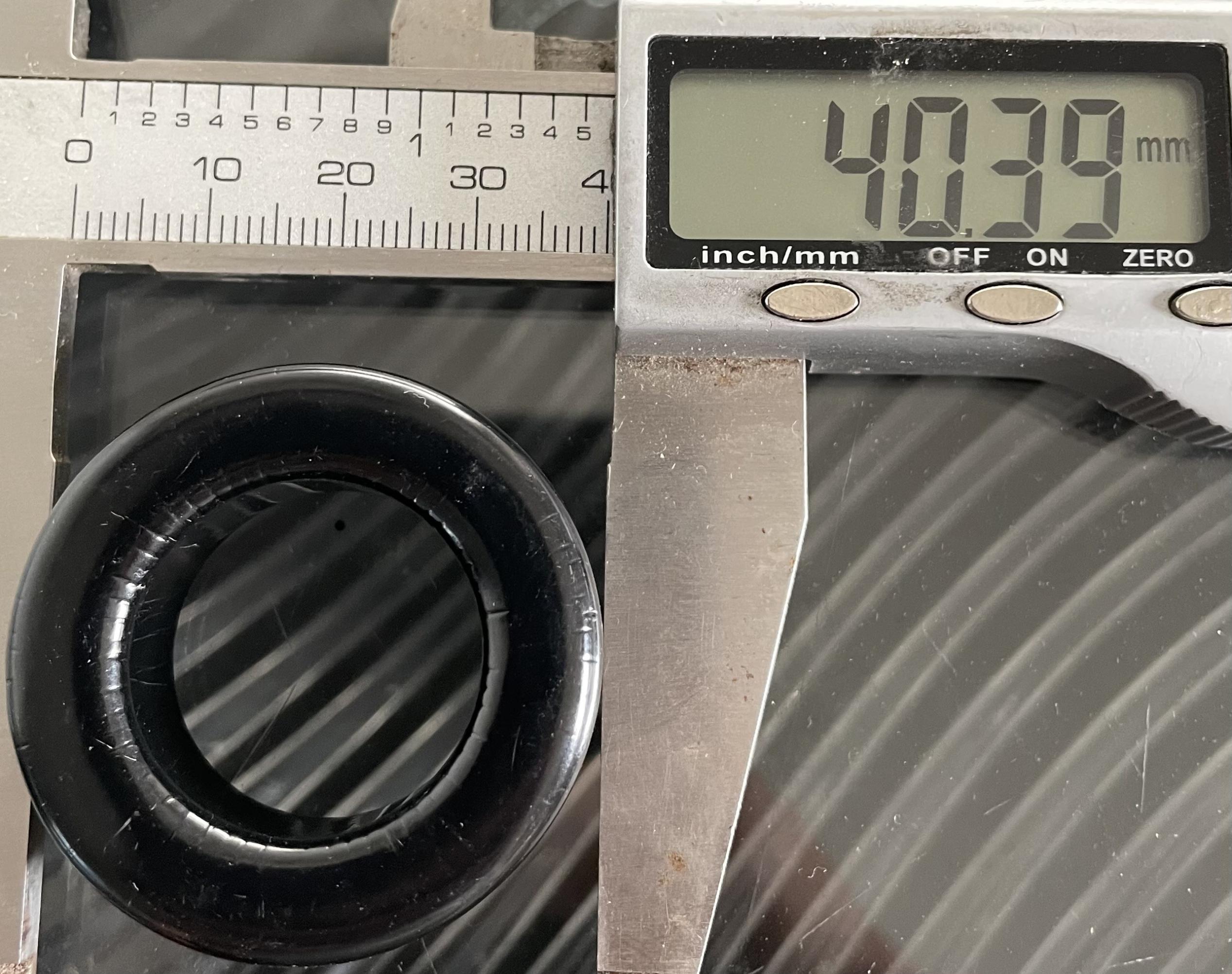

            You have disconnected the 4th leg of INA 125. I have read the whole topic but have found nothing. Where can I find out about this? My reaction to a ferrite with a diameter of 15 mm and a length of 40 mm is 15 cm, I don’t know if this is normal. What is yours?

ID:	440238 I have a toroidal ferrite with a diameter of 40mm and a thickness of 15mm. It’s barely detectable at 10cm. It gives a weak response, even at 0cm from the coil. I can detect some copper PCB, 100x150mm, at 45cm maximum. Very strong when closer. An aluminium empty panadol packet, 8x5cm, can be detected at 35-40cm. Very strong signal when closer. A silver coin of 40mm diameter can be noticed at 11cm. It doesn’t give much response, not like aluminium and copper

                  I've tried a few different mosfets, convinced i'm unable to get a genuine BSP230. and so far, the genuine BSP225 performs the best. For a while I had the damping resistor R12 at 470, based on old advice for increasing sensitivity, but 330 works much better. Next I will try with a 180 - 200 ohm R12 to compensate for the "DMP45H150DHE-13" - Rds On resistance of 150 ohms. But this will require unsoldering the BSP225 and to risk destroying it and loosing some sensitivity. I have yet to test the coil voltage and to see if it is avalanching because of the bsp225

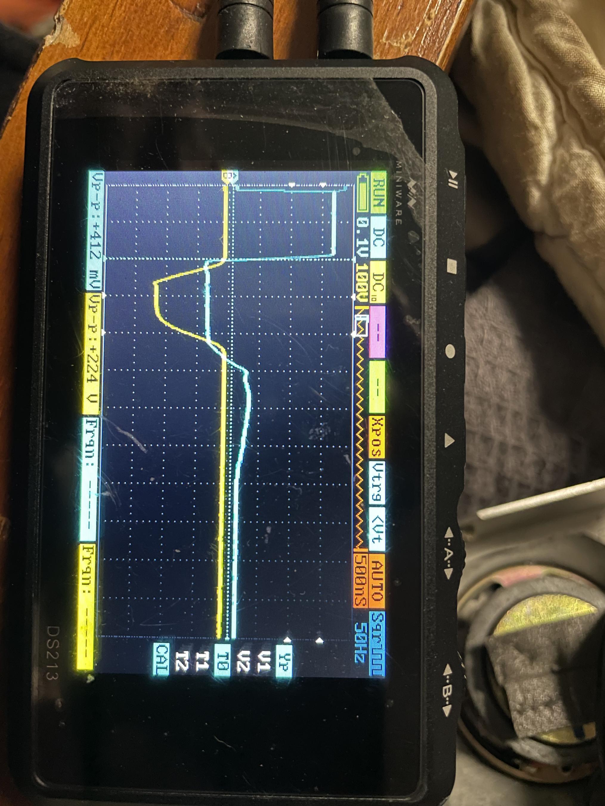

                      • Click image for larger version  Name:	IMG_2626.jpg Views:	0 Size:	562.4 KB ID:	440335
                        I think my BSP225 is avalanching, or i’ve chosen a wrong component. It seems to be 1us or less that it’s quenched in, with both 330 ohm damping and 2x parallel 330 ohm resistors for 165 ohm damping
                        channel 1, blue, should actually be 1v/div, i’m using x10 probe switch for both channels but didn’t properly set the scope for it
                          yup ... that is definitely avalanching ..... the MAGPI uses a constant current damping principle ...which is non linear in respect of voltage and current. If you add a damping resistor ( linear in respect of voltage and current ) then the faster non-linear damping will be affected ( feedback loop is no longer sensing current properly ).
                          Make sure the TX time on is not too long and causes flybacks that will avalanche the damping mosfet.
                          if you are having trouble finding the BSP225 ... try this ..

                              Aah, I thought there was something a bit off with my setup! I've ordered some BSP230 from Alibaba, hoping to get some genuine ones. BSP225 is currently easy to get from Digikey, but i suspect that the 50v less Vds is why it's avalanching. The part you've used originally is BSP230, which is a whopping 300Vds P-channel. The closest replacement I could find with the same or higher voltage was DMP45H150DHE-13, with 450Vds, and also a reasonable 60pf input capacitance. The biggest difference I found was Rds On, at 150Ohm. Which I ordered a few of, hoping the resistance wouldn't matter. Then I got some 180 Ohm resistors to use for R12, hoping that would give me an equivalent circuit function to your original design. I've been thinking of R12 as a damping resistor, though now I realize that a damping resistor would be fitted before the constant current damping, and I should've said R12 instead.
                                You are right about the low capacitance input and generally you dont want the TX or the damping mosfet to avalanche. So a 300 volt mosfet is better than a 250 volt ...however with constant current damping the Rds on wants to be in 10s of ohms not 100s as there will be an issue as the flyback voltage decays below the IR ( amps x resistance ) point where amps is the damping current and resistance is the Rds on.
                                The R12 ( I am not looking at the schem ) mops up the small residual leftover damping in a linear way after the diode to ground off the source of the damping mosfet stops conduction.
                                There is a way to reconfigure this arrangement very simply to create an "ideal" diode off the source of the damping mosfet .... can you see how to do it ?? This will give make the active damping even faster.
