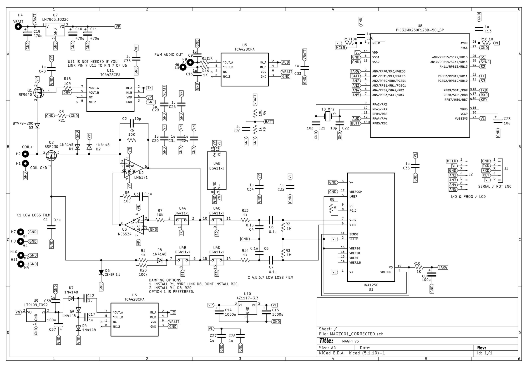

        • If you want the increased stability and sensitivity as shown in the video of post #338 these are the required hardware changes.
          Click image for larger version  Name:	image.png Views:	0 Size:	1.01 MB ID:	422774​1. REMOVE R6 ( DO NOT FIT )
          2. CHANGE R7 to 100K
          3. REMOVE D6
          4. CHANGE R13 & R14 to 10K
          5. CHANGE C5 & C4 to 1 uF ( FILM CAP )
          6. REMOVE R1 ( DO NOT FIT )
          7. REMOVE D8 ( DO NOT FIT )
          8. CHANGE R20 to 10 MEG ( metal film 1/4 watt )
          9. CHANGE C1 to 1uF ( FILM CAP )
          10. CHANGE C3 to 0.22 uF ( FILM CAP )
          These changes will increase the preamp gain from 100 to 1000 ( from 40 db to 60 db gain ) and baseline stability is greatly improved.
          Now I did say that you would not have to cut a track on the original PCB .... but you may or may not have to.
          So if you make the changes above but the sensitivity is not what it should be ( as in the video of post #338 ) then I will advise the track to modify. Let me know if required.
          I will also be changing U2 .... but waiting for parts to test ... the video demo in #338 uses the LM6171.
          Should work with the 1.4 firmware but will be releasing 1.5 shortly when I get the U2 part.
          • WHOOPS ... one additional change I need to include.
            We deleted R6 .... but you must add back in R12 ( see schematic in post #1 and PCB in post #2 )
            I have use 470 ohms. ( Metal film 1% )
            Click image for larger version  Name:	image.png Views:	0 Size:	18.3 KB ID:	422776
            so the change instructions are now ..
            3. REMOVE D6
            11. ADD R12 470 ohms.​

                      Here is my AC model for the PI preamp.
                      The gain is set by R6 / R7
                      The low pass cutoff by C3
                      The high pass cutoff is set by GBW / gain
                      C4 compensates for opamp input capacitance ( normally only a few puff ) which will form a pole with R6.
                      It totally blocks DC
                      This configuration prevents the negative feedback elements of a conventional inverting amp from messing with the input impedance ( esp in overload )
                      The MAGPI has a demodulator switch to break the feedback R6 from the output during TX cycles this so that TX modulation ( overloads the amp ) will not be "remembered" by the filter cap in the feedback path.

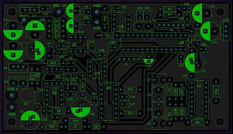

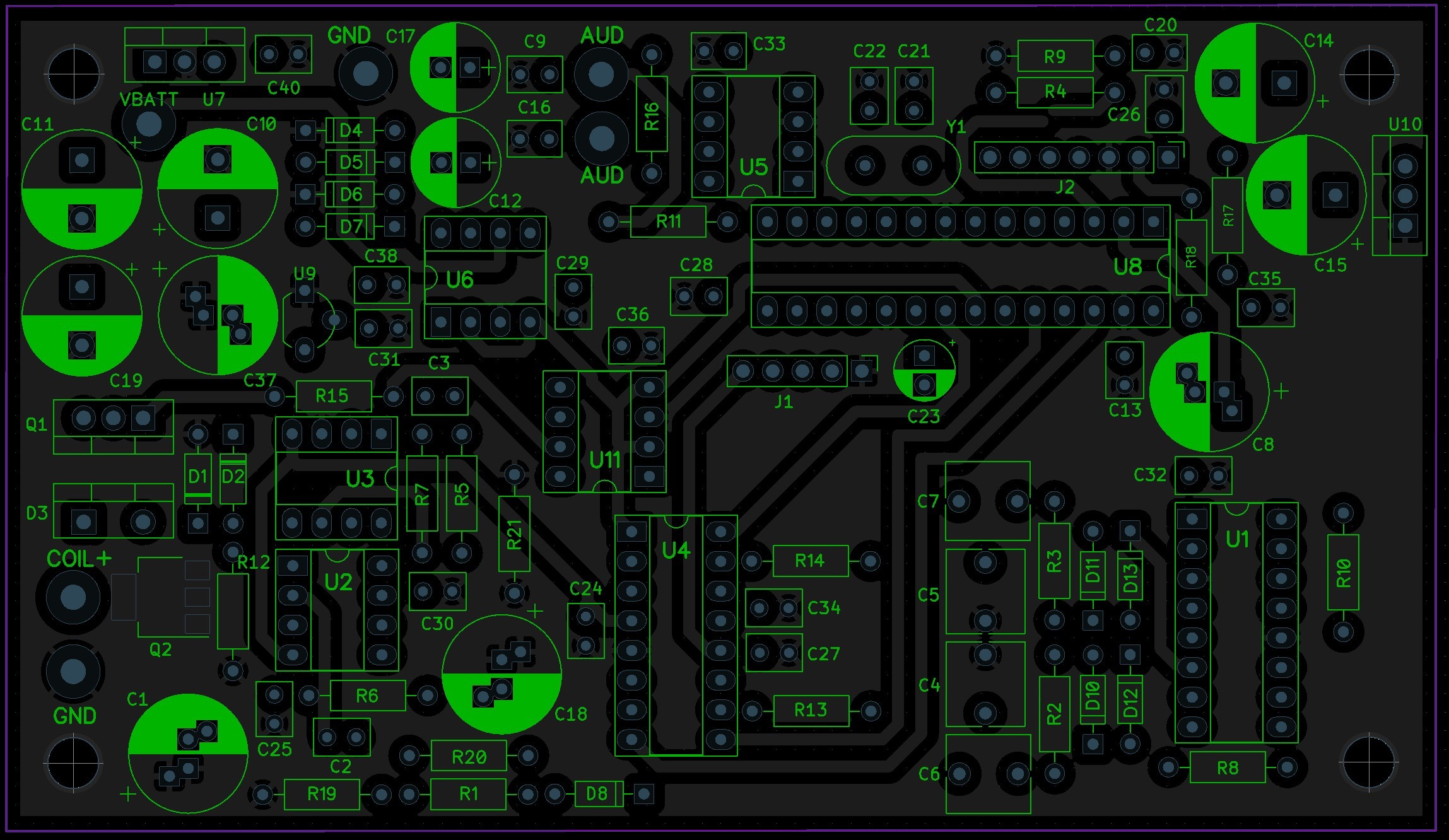

                          • Here's one I prepared earlier, figured this might be of use to someone
                            Click image for larger version  Name:	MAGPI V3 Silkscreen.jpg Views:	0 Size:	645.5 KB ID:	422798

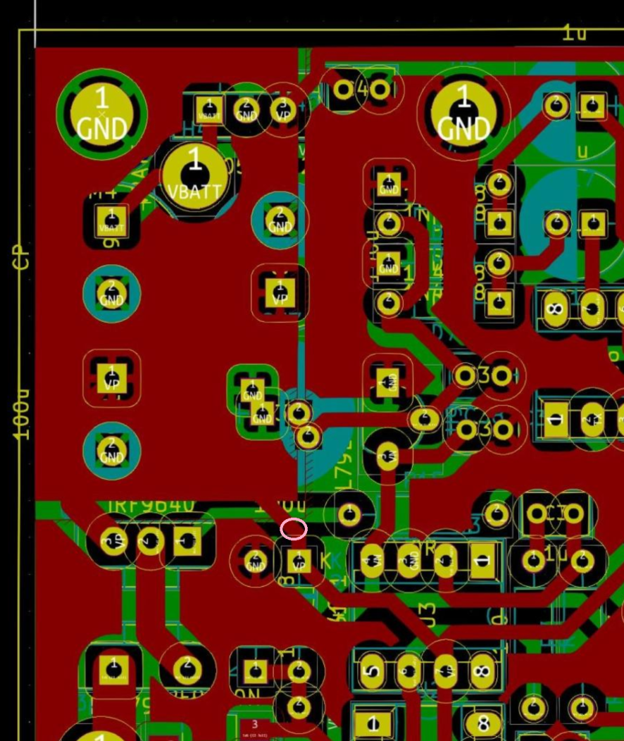

                            • Good work ... I better let you know about which track might require cutting in the updated version of V3.
                              The main TX supply is 5 volts ... this supply also powers the front end opamps and the DG411 switch.
                              In some conditions ( sample settings etc ) the 5 volts is not high enough ( as the op amps are not rail to rail ).
                              So the 5 volt analogue supply to the frontend (not the TX ) needs to be re-routed to battery voltage VBATT.
                              This involves cutting a track and jumpering the opamp supply to battery volts. ( input to LM7805 regulator ).
                              There is a pink circle over the track to cut.
                              Note this is a last resort ... dont do it if the detector is working ok.
                              Click image for larger version  Name:	cut track.png Views:	0 Size:	1.07 MB ID:	422836
