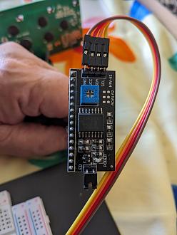

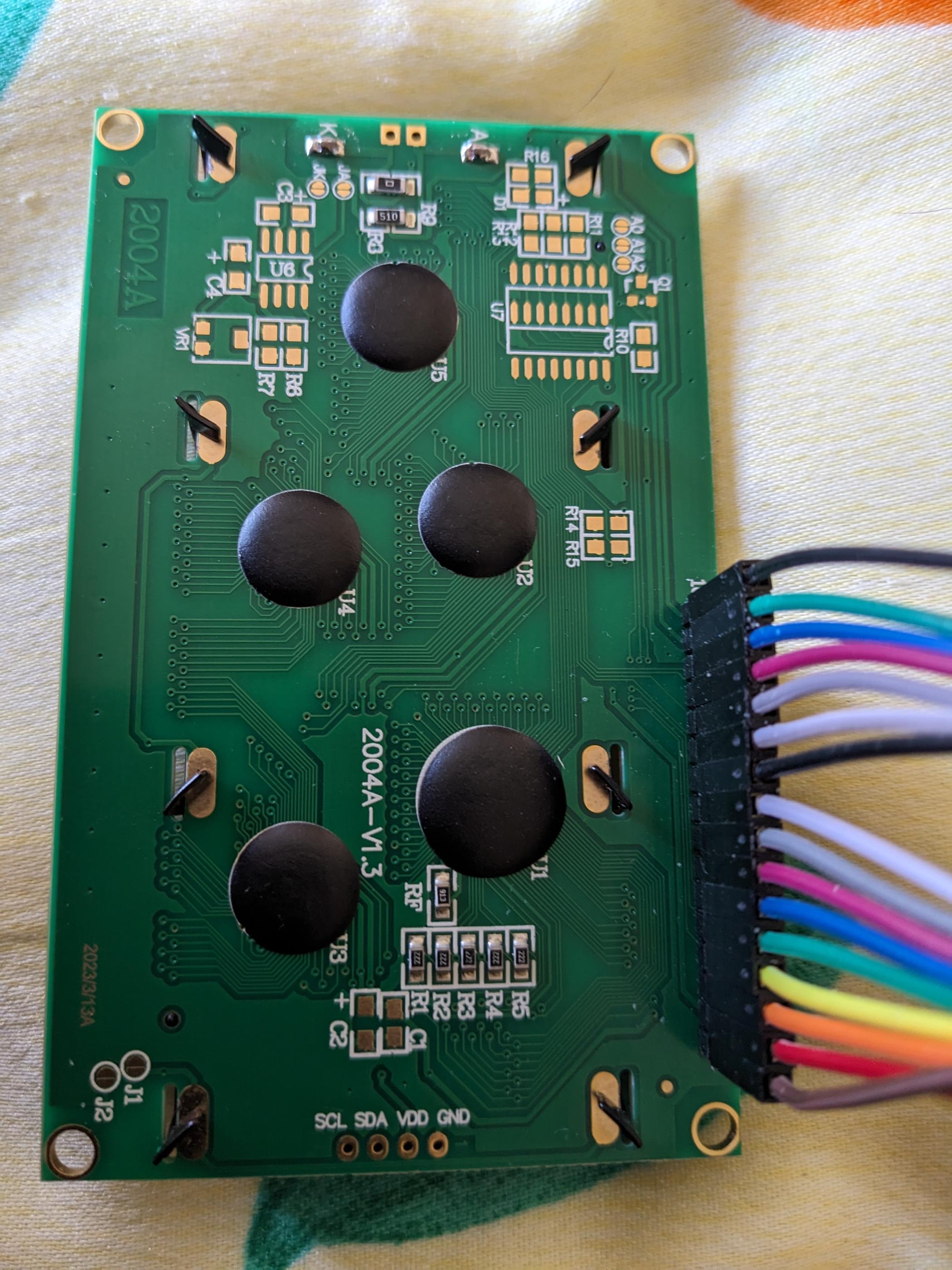

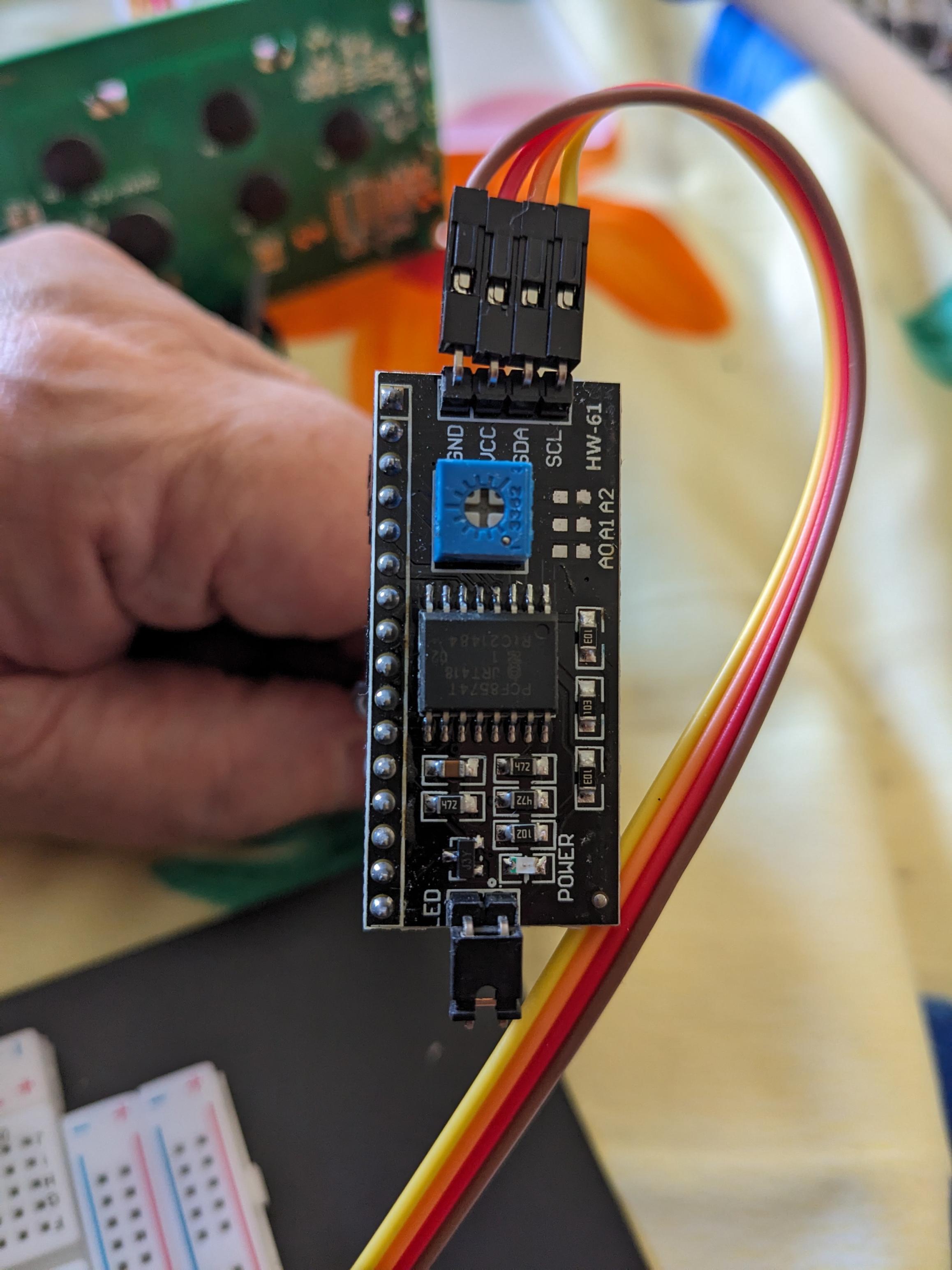

                          Should just work ...provided connections are good. Can you post photo of back of display ?
                          • Here's my display and I2C adapter. Click image for larger version  Name:	PXL_20240409_134112697.MP[1].jpg Views:	0 Size:	444.9 KB ID:	422745 Click image for larger version  Name:	PXL_20240409_134039865[1].jpg Views:	0 Size:	580.0 KB ID:	422747
                            The display works fine over I2C on an Arduino Nano project @ 5v.
                            • Every time I have problems with I2C it's always the device address. I can see three empty jumpers on the black pcb, marked A0,A1 A2. Maybe check Moodz's code for the device address and then short the correct jumper?
                              • I found that there are two versions of the PCF8574 IC. One is PCF8574A and the other is PCF8574T. If moodz wrote the code for the "A" version, your "T" may not work without changing the address in code.
