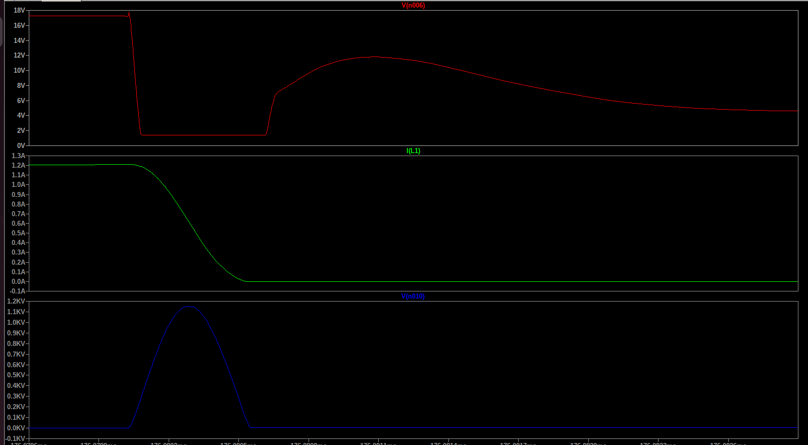

        • Just about to commence laying out a PCB from the breadboard. Maxed out the TX power and speed that will reasonably work with off the shelf mono coils. The final figures for the MAGPI V3x will be something like 10 Khz TX frequency with 1.2 Amps peak current and 1.2 KV flyback. Damped in 650 nanoseconds and two channels ( one for discrim and one for "all targets" ). The waveforms are near perfect damping.
          Preamp is 100X - red trace. Flyback and coil current shown.

                  • Hi pito,
                    Yes, the peek voltage on Tx coils is 1600V. I measure this voltage on the lowest resistor if the 4 resistors TX coil's damping chain. Where is the problem?
