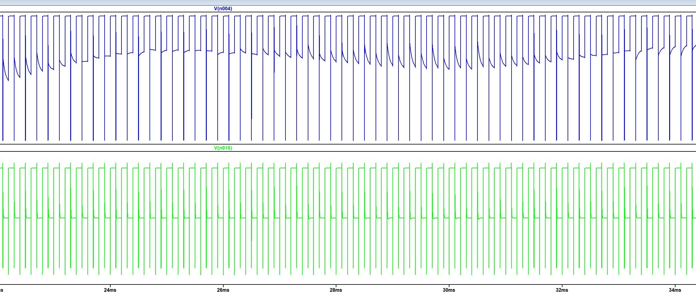

    Loop2 ... noise and offset reduction loop
    The TX pulse is used as a control sample DG411 during the RX period to feed a noise / DC offset error correction via the NE5534 to the "ground" reference of the LM6171. This removes substantially all DC offset errors and low frequency mains / magnetic field influences etc in the signal.

      Hi moodz,
      Is that loop worth it? Is it really reducing noise? Isn't more noise (generated by the DG411 switching + noise generated by NE5534) injected into the LM6171? I think I've seen this in other PI circuits and always wondered if it really does any good.

        Hiya Lucifer ... refer the two circuits below ... identical except one amp is only referred to ground. There are white noise sources in each coil.
        The top blue trace is the grounded amp. :-)

          Thanks. Is that what happens in practice too? I don't always trust simulations. Is your preamp's output nice and clean?

              The sampled feedback forms a comb filter with the response
              H(f) = 2 |sin(π f Ts)|
              where Ts is the sample period. The response looks like:
              You get a perfect null at DC, plus nulls at every 1/Ts. You can calculate the exact amount of EMI suppression using the equation. For example, at a 5kHz pulse rate the 50 Hz mains is attenuated by
              2 |sin(π*50Hz*200us)|​ = 0.0628 = -24dB
              It's not a complete panacea because some EMI frequencies also get boosted; this is where a variable pulse rate is valuable. If the sample is taken after the target signal has decayed to zero then it has no effect on the target response. But for high conductors that have not fully decayed there is some attenuation which depends on the delays of the target sample and the feedback sample.
              This technique has exactly the same effect as the classical EFE subtraction sample. The advantage here is that it's applied to the preamp so that you never have to worry about offset headroom problems. The disadvantage is that the nulls are set by the TX pulse rate, and with EFE subtraction they are set by the difference of two sample times which gives you more flexibility in placing the nulls. You could combine the two methods and get the best of both.
