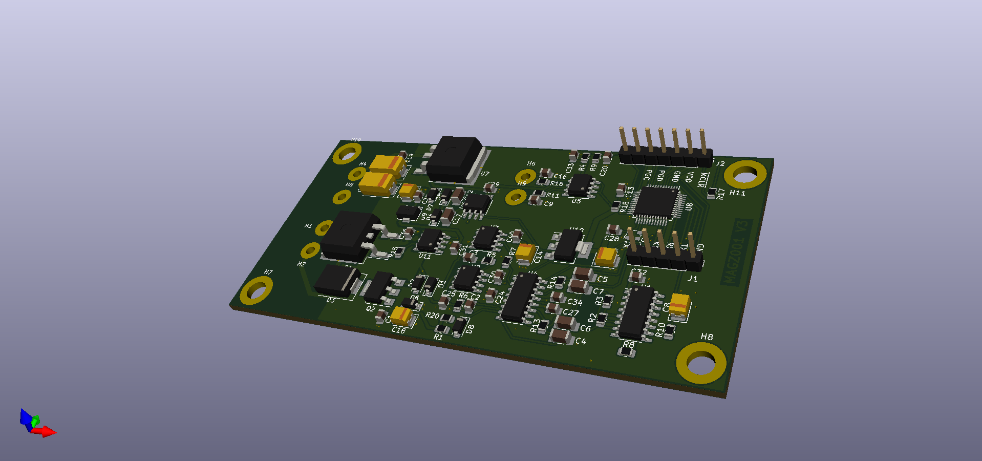

                        First iteration of a miniature MAGPI v3 in SMD. Board is 100 mm x 50 mm.
                            Really excellent work ... one thing I might mention is that the filter for the balanced PWM audio is a simple RC low pass. ( x 2 ) ... though a single leg can be used to ground with a DC blocking cap ( non polarised ) of suitable value.
                            If an RL low pass is used then considerably more audio power will be delivered. ( ie louder ) I have used a 5.6 mH inductor with 10uF cap or 1 uF cap for higher freq response for 32 ohm headphones.
                            Might be worth allowing for the inductor or resistor option in the filters .... the inductor packages will generally take up a bit more space than a resistor.
                            moodz
