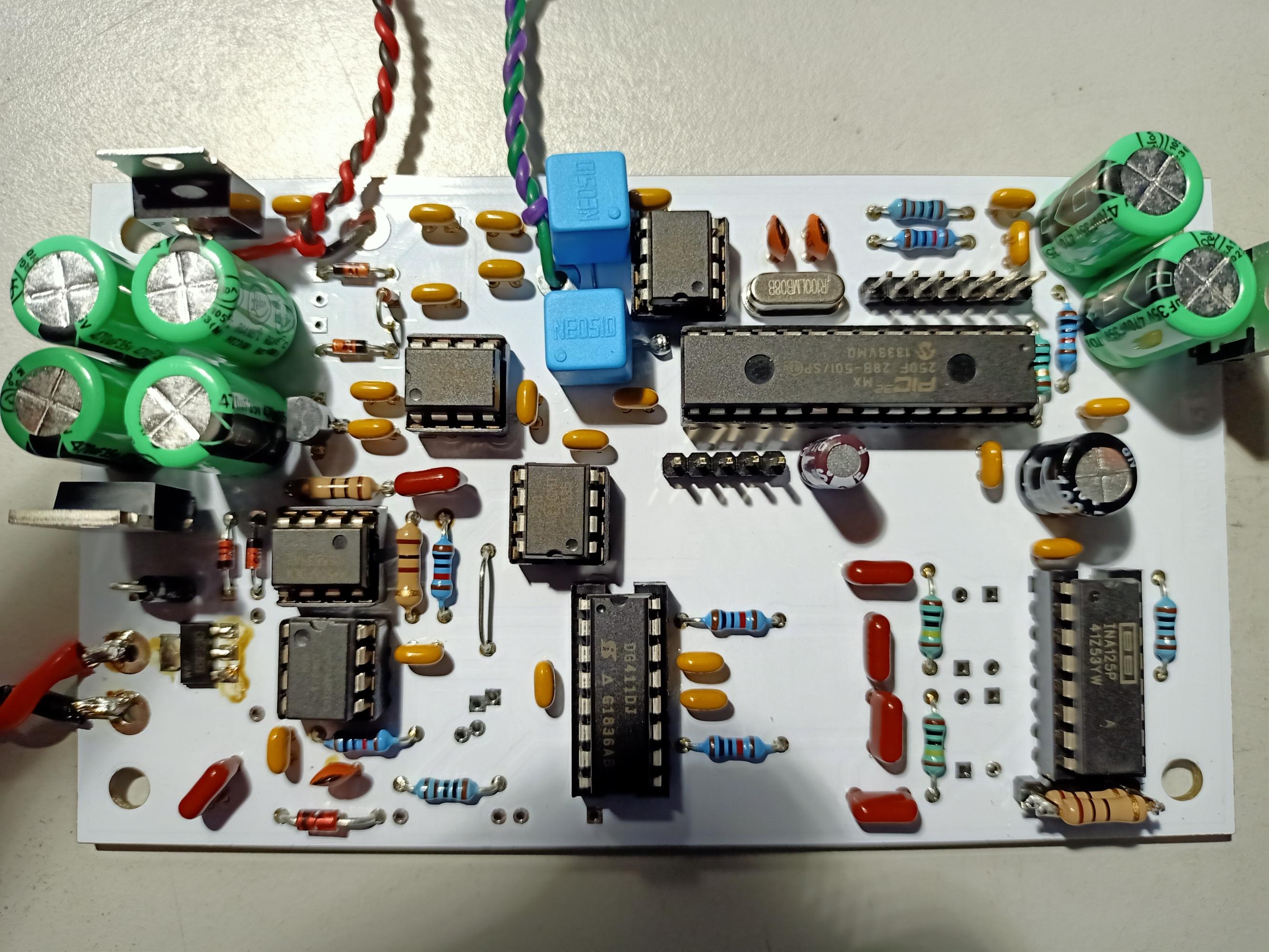

        I have just built up unit no 4 ... 3 previous no failures yet. This one is fitted with the 5.6 mh inductors on the audio filter.
        just noticed for the Erratum list ... I am using 10K for R13 and R14 instead of 1 K. and the big filter caps are 470 uF..... the filter caps are not super critical with linear regs. They need to be there of course.
        ... and the 9.1 volt zener across the bsp230 bias cap. :-)

        Click image for larger version  Name:	v3unit4.jpg Views:	0 Size:	551.5 KB ID:	410002
