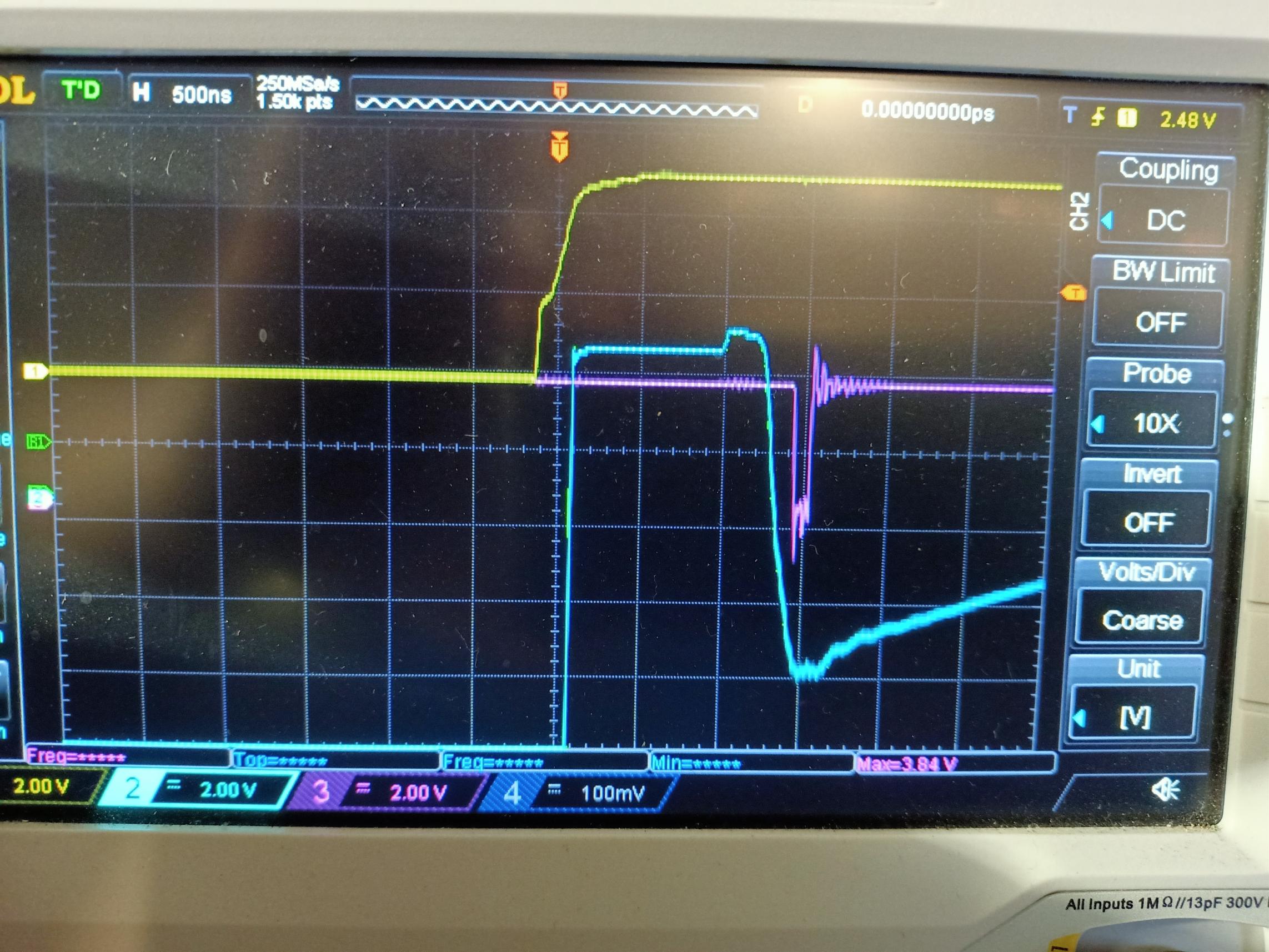

      That board that was just built up on the CRO with a minelab 10inch mono ...
      Zener installed ( stored trace green ) and Zener uninstalled ( live trace blue ) overlayed ...
      ... I dont think I can resolve a meaningful difference ???
      The pink pulse is the X sample pulse from the CPU ... ( bit of ringing there .. but no biggie ... the hyst on DG411 is not bothered. )
      moodz

        Sorry Dean .. my explanation was not clear ... the yellow trace is the TX control ... the pink trace is the X sample ... the blue green trace is the Zener fitted / not fitted trace exactly on top of each other .. the zener has no impact on the ouput.
        The zener has no impact on the output.
        However if people dont want to fit it ... OK. Its more of a safety feature for those who might be probing around on the board whilst it is operating.
        moodz.

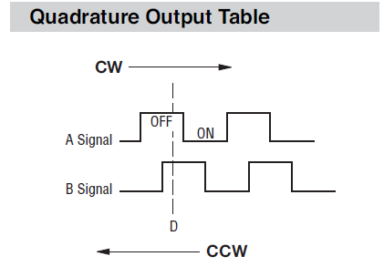

            Originally posted by Dean Sarelius View Post
            Ok will take a closer look at the source code although normally a rotary transition should be used to generate an interupt either from A or B and the routine will read the state of the other pin to determine the direction.
            Still trying to think how direction would work with only A as the input signal and have a hunch it may have somthing to do with what is happenning on the common pin.

            Hi Dean ... yes I had a look at the rotary wiring and you are right I have wired the C ( common ) to the B switch Good Pickup !
            So I changed the wiring to AB and C to common and its still works OK ... so I guess the code and the wiring is foolproof :rotfl by accident.
            I have never used interrupts for rotary encoders ...if you have some other more critical loop task ( like the TX interrupts ) then if the loop is fast enough to sample you get a rotary encoder or multiple REs with very little code overhead plus free debounce.
            The less interrupts the better I always say.
            moodz.

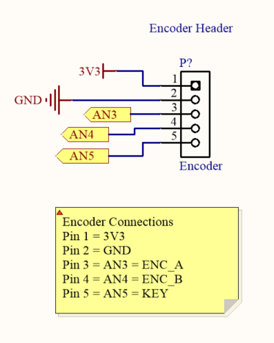

                      moodz.
                      Hi Moodz,
                      Thats great that it still works so assume the mapping is A=AN4, B = AN2, C = AN5 and the Switch = AN3...?
                      Some interupts are good some are bad of course but I guess if you are going to use the encoder to adjust some values you kind of accept that there may be some interuptions to the regular operation.

                        Hi Moodz,
                        I just noticed that you made a second revision of the circuit where you used a voltage doubler to assist with the lower battery voltages. I will remove the schottky bridge and replace with discrete schottky diodes.
                        Regarding the mapping for the encoder have set up as below.
                        ​​Click image for larger version

                          Hi Dean
                          The revision is so the detector will run OK from 2S Lithium Packs ( 2 x 3.7 volts ).
                          The schottky diodes dont really matter as the 5 volt linear regulator will run out of volts input before the voltage multiplier does on low battery.
                          Changing the -9 volt regulator to -8 volts may or may not be problematic as the -9 volt rail is required for the damping control loop.
                          The op amps are not rail to rail so you have to have enough headroom in that voltage rail to generate adequate bias for the damping loop - I have not tested at -8 volts.
                          Note that where the rotary encoder attaches is also the programming header on the original schematic.
