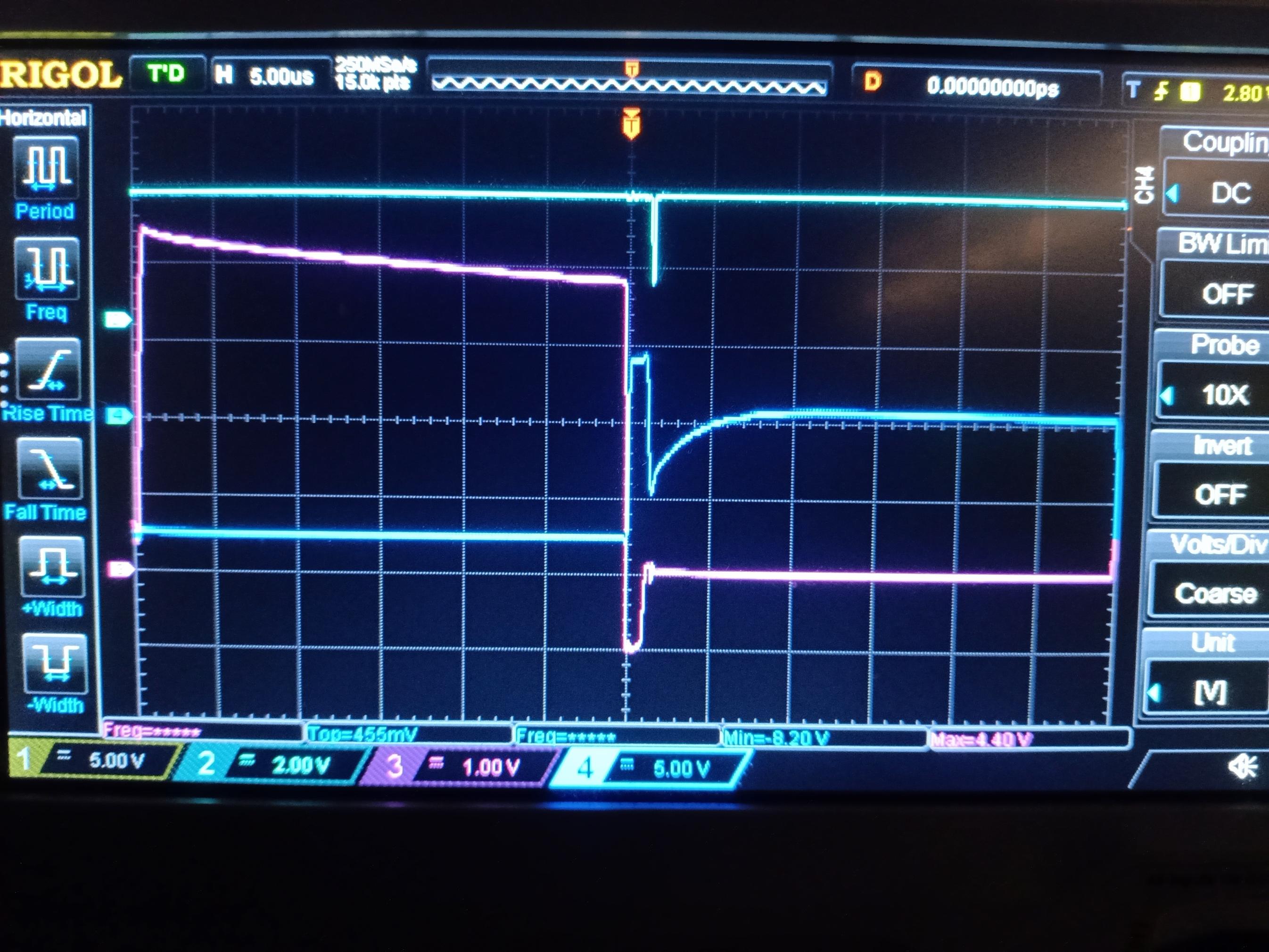

                  • #84
                    Hi Dean I have scoped out the actual signals at the input / output to the preamp on the V3 for a complete transmit cycle ( 30us on / 30us off ) and the X sample pulse from the PIC32.
                    The top Light Blu trace is the X sample pulse.
                    The Pink trace is the input to the preamp.
                    The Darker Blu trace is the preamp output.
                    You should be able to see that the input to the preamp never exceeds 4.5 volts positive and 1 volt negative. This is because there are two diodes ( one damping and one protective to +5 volts ) across the input to the preamp.
                    So the input to the preamp never exceeds the supply rails and cannot due the diodes.
                    Hope this clarifies.
                    I can see you have gone to a fair bit of trouble to simulate the circuit. The coil I use is 0.5 ohms possibly 0.6 ohms. but this should not affect the result.
                    Cant tell from your results but was the damping control loop settled when you measured ?
                    moodz.
                    Click image for larger version  Name:	preamp.jpg Views:	0 Size:	527.5 KB ID:	410199
                    • #85

                      Hi Moodz,
                      I think I know where the issue is and it is with respect to charging the gate capacitor C1.
                      Without the bias there is no damping of the flyback hence the flyback is able to fall deeper than it should.
                      I can see on your scope the flyback is settling around zero volts where it should be however in my simulations it is passing the zero volt line and heading into the 6V region.
                      For some reason I am having issues to get the DG411 model to sample the pulse at 1.6us for the bias cap and am still working through it.
                      Hopefully will have it working soon.
                      Thanks again for your help..cheers

                              Hi Moodz,
                              Succesfully simulated your circuit with and without the buffer, I must say this is a very interesting circuit I would really like to know where you got the ZPD concept from..?
                              When comparing the results there doesnt appear to be much of a difference in the performance both circuits perform exactly as expected providing the much needed negative bias voltage for Q2.
                              The bias voltage settles at around -4V and it takes approximatley 90ms to reach this value with and without the buffer.
                              Below are screen shots results with the addition of a buffer using the NE5532 A and B one for the buffer the other for the TX feedback replacing the NE5534.
                              Since the buffered circuit works I will make these changes to my design and start laying out with the new schematic.
                              Simulations were completed with Multisim.
