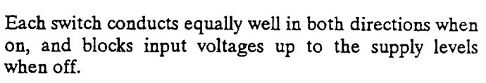

      The switches are bidirectional so it doesn't matter whether the input is on S or D.
      • #93
        Hi Carl
        Yes I agree with you in principle but as I said the DG411 all the test circuits are applying the input to the source pins so best practice dictates that you should follow the test criteria.
        • #94
          Not if you know it doesn't matter. I hook them up according to what makes the layout easiest.
          • #95
ID:	410408 from pdf
