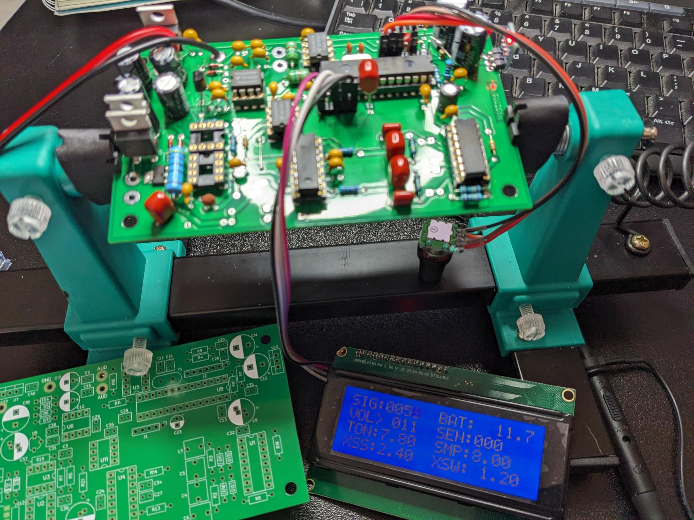

        • Thanks Moodz, board is 99.9% done and just waiting for your final deliberations on opamps etc.

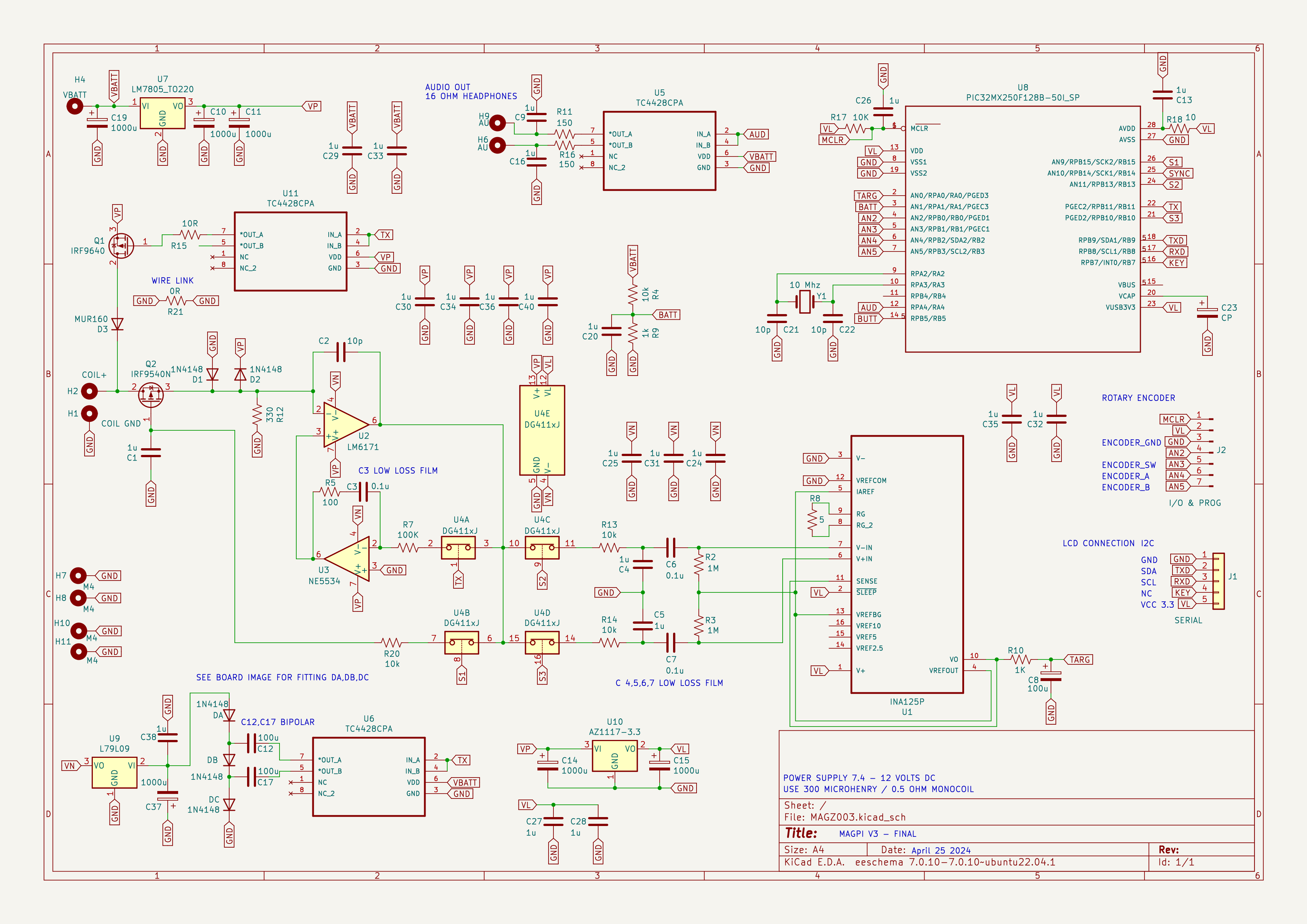

          • This is the FINAL version of the MAGPI v3.
            There are NO changes to the PCB layout. ( ie use the originally published PCB )
            Some components were added. ( Originally not fitted to PCB )
            Some components were removed. ( Originally fitted to PCB)
            Some component values changed. ( Originally fitted but must be changed )
            The original choice of opamps was the best ... ( others were tried ... they died ).
            ie LM6171 for U2 and NE5534 for U3.
            CHECK THE SCHEMATIC.

            • doh ... typo on the damping mosfet ... Here is the FINAL FINAL schematic.

              • Hi Moodz is the change to D3 purely due to higher breakdown voltage or some other reason. I have a MUR460 in my box of bits with a 4A, 600v rating so presumably that would do?
                Is R12 coil dependant and if so what is the selection criteria/formula?
                • Originally posted by Gunghouk View Post
                  D3 can be almost any fast recovery diode rated for higher than 250 volts reverse and less than 1 volt forward voltage at 400 mA.
                  MUR160s are cheap and available ... MUR460 should work fine too.
                  R12 is set to "safe" value of 330 ohms .... the coil should be 300 microhenries +/- 10%.
                  R12 mops up the residual damping when the diode D2 stops conducting after the damping current stops flowing.
