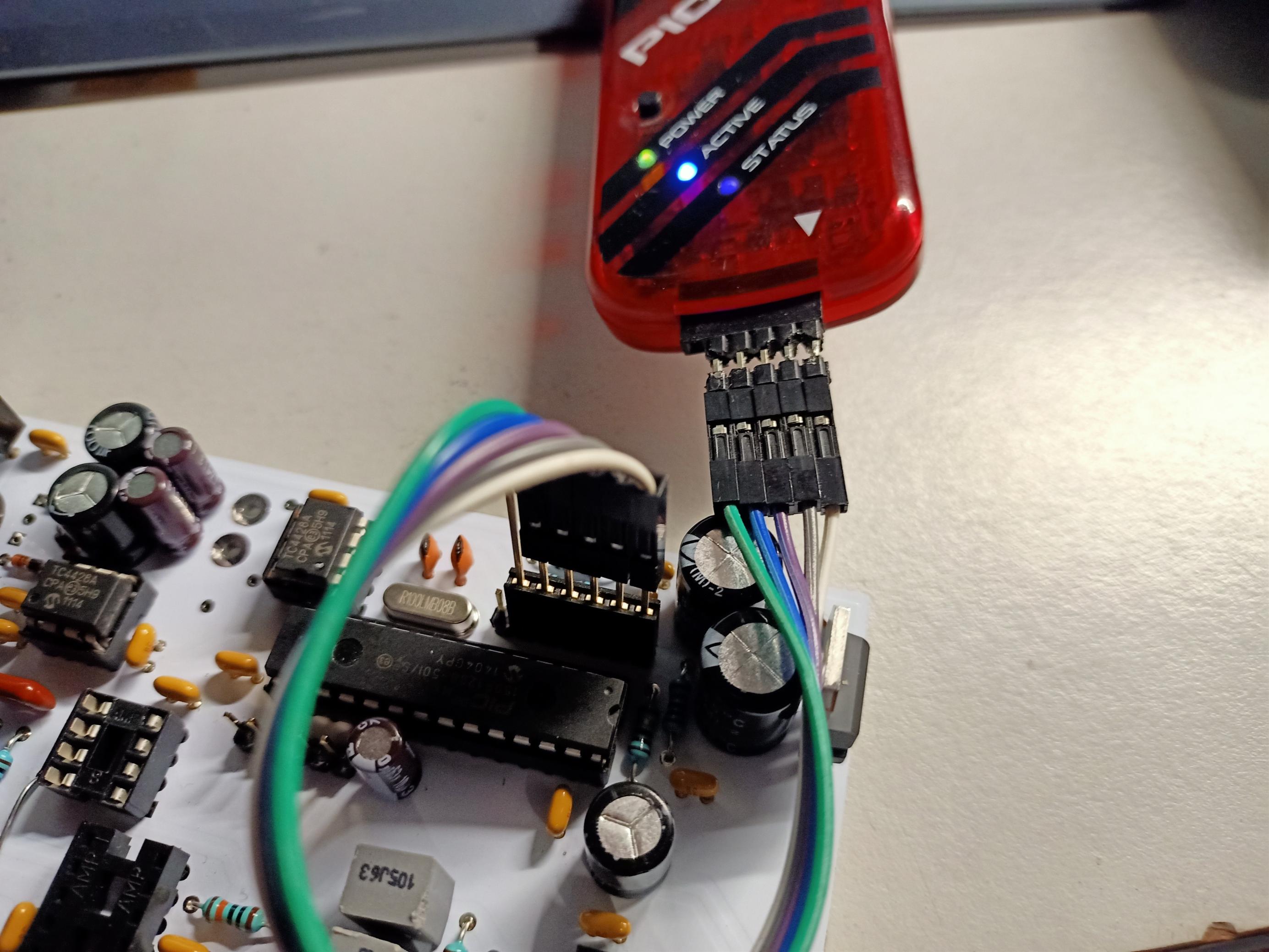

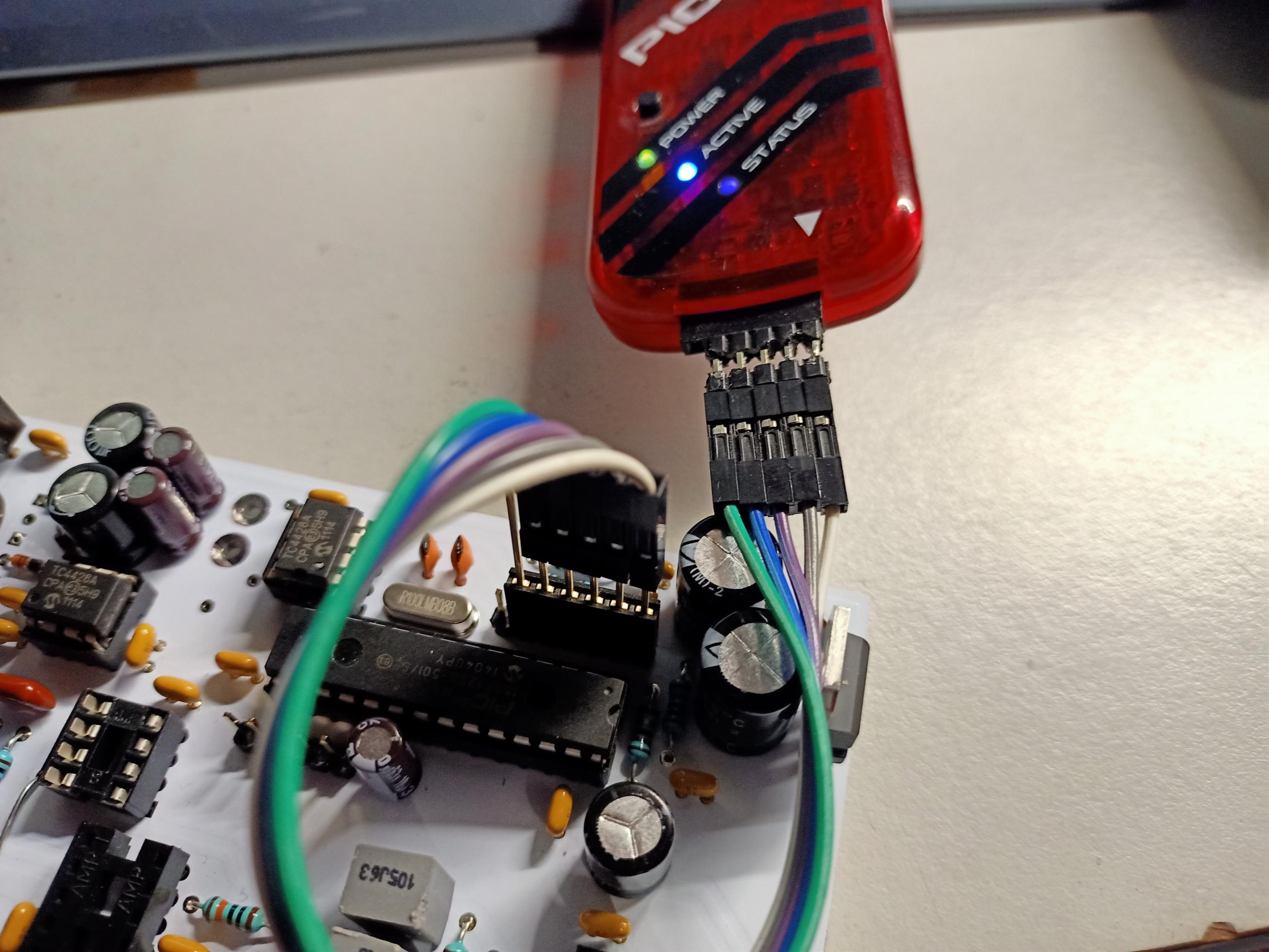

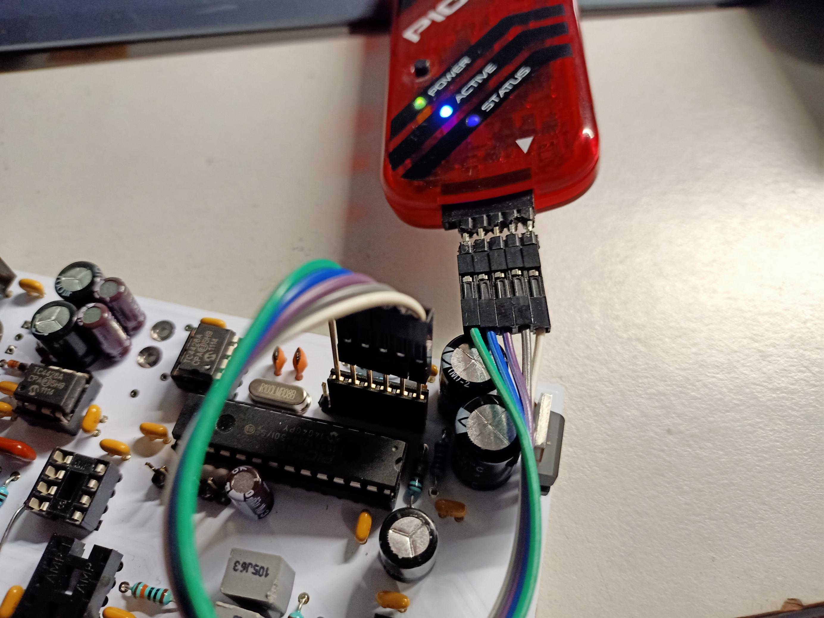

      • Paul I tried reprogramming the existing 250F by hitting the program button and switching the detector on at the same time and having the detector running then hitting program and all I get is Target Device Not found (Could Not detect Target Voltage VDD) I have tried to PM you but it does not seem to be getting through to you can I give you a ring for instruction.

          Hi Ian .. I program it as follows ...
          1. Turn detector ON ( no coil )
          2. Connect programmer ( I use Pickit 3 )
          3. Program
          4. Remove programmer
          5. Turn detector off
          done.
          Call me if you get stuck.

                      Thats weird ... I checked the programmer and it was set for 250MX orginally so I sent you the 150 code incase.
                      However here is the 250MX firmware ....
                      MAGPI008.X.production.V1.2_MX250.zip

                          Hi Paul Bingo got it second try will keep you informed how it goes when I have leant how to drive it.
                          Regards, Ian.

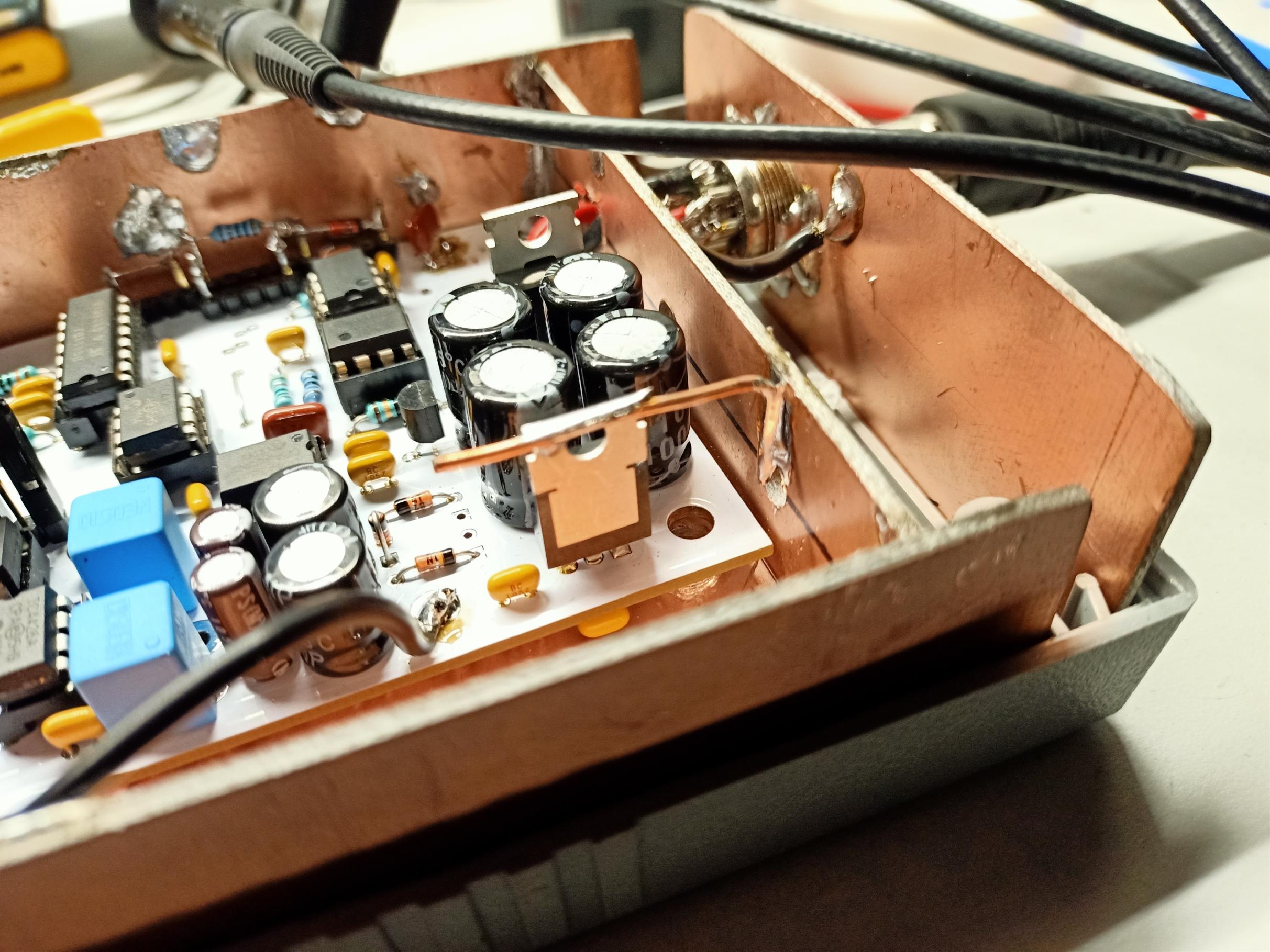

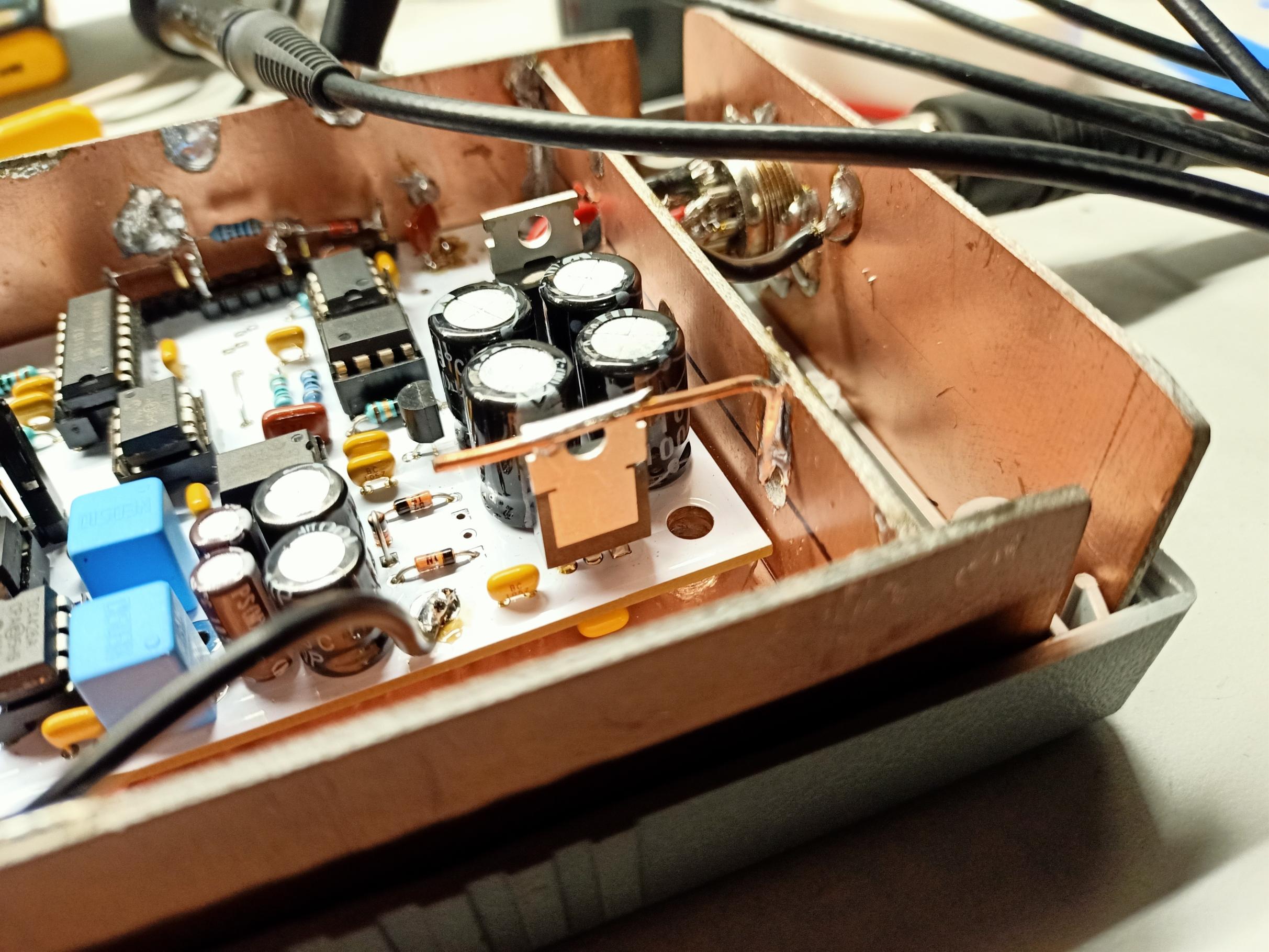

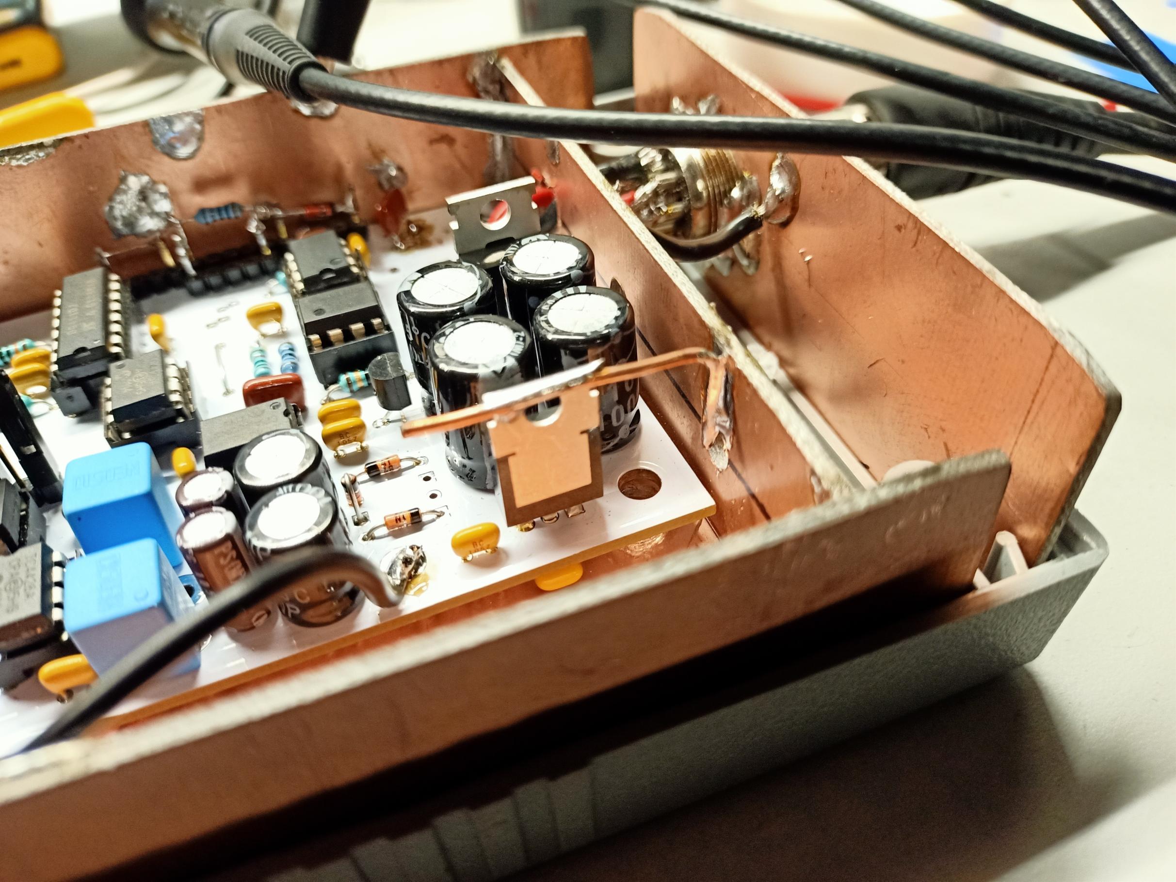

                          • Originally posted by tpet93 View Post
                            UPDATE, I increased the TX time to the full 15us and the warbling has significantly reduced, sensitivity to small nuggets after tuning out ground is better now.
                            I will need to re-do those graphs.
                            Tony
                            I had a detector that warbled alot and another that was rock solid .... even though both had exactly the same components. After about a week of changing components in and out etc ... it turns out that there was stray capacitive coupling from the TX circuit to the linear 7805 regulator. The fix was simply soldering the tab of the 7805 to the shielding ground. This feedback was causing slight variation of the regulated 5 volts hence causing a warble as it would have been modulating the TX current.
                            This feedback also caused burst oscillation in the TX mosfet on turnoff .... also solved. The heatsink was orginally bolted ... hmm
                            moodz.
