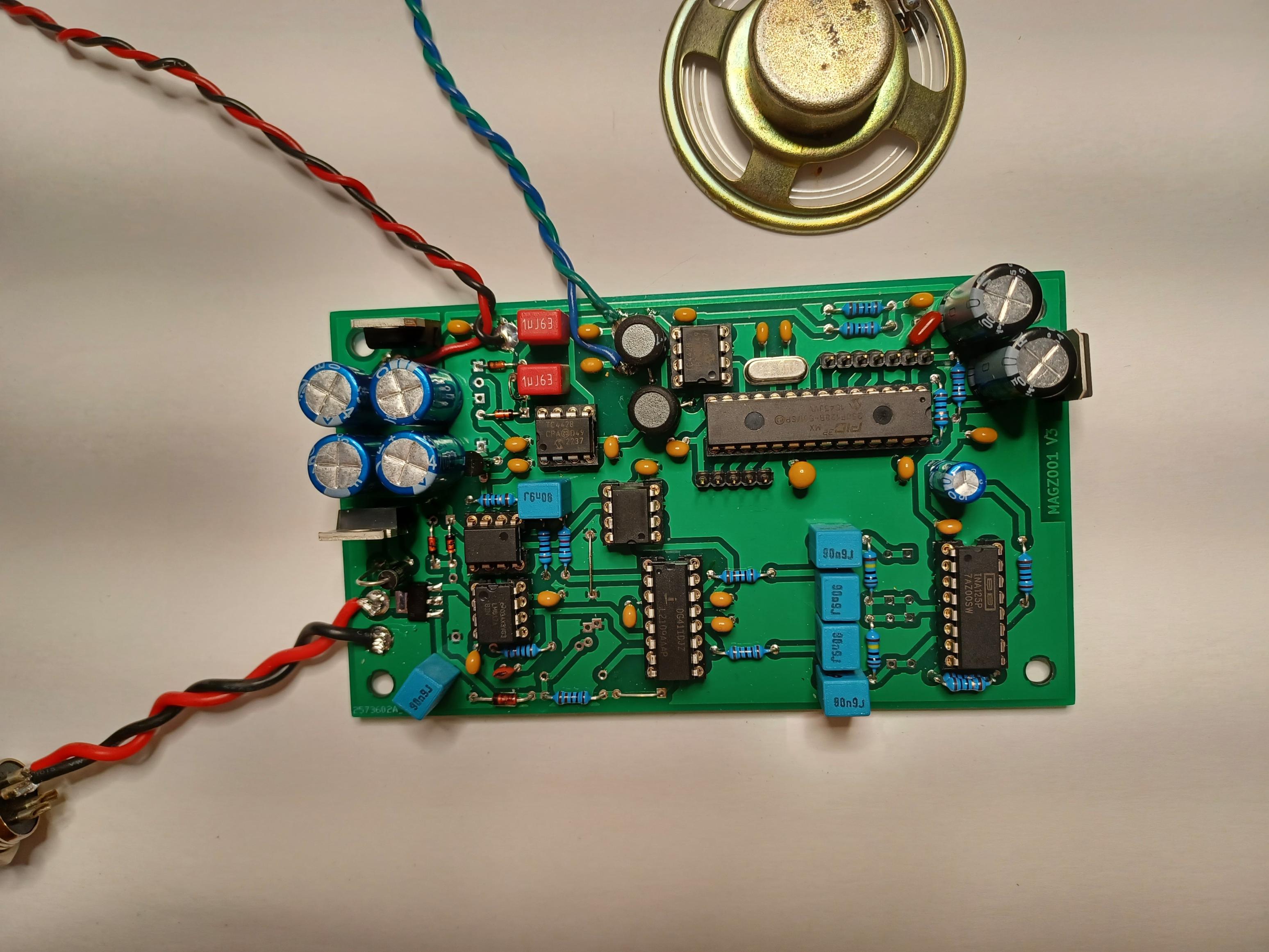

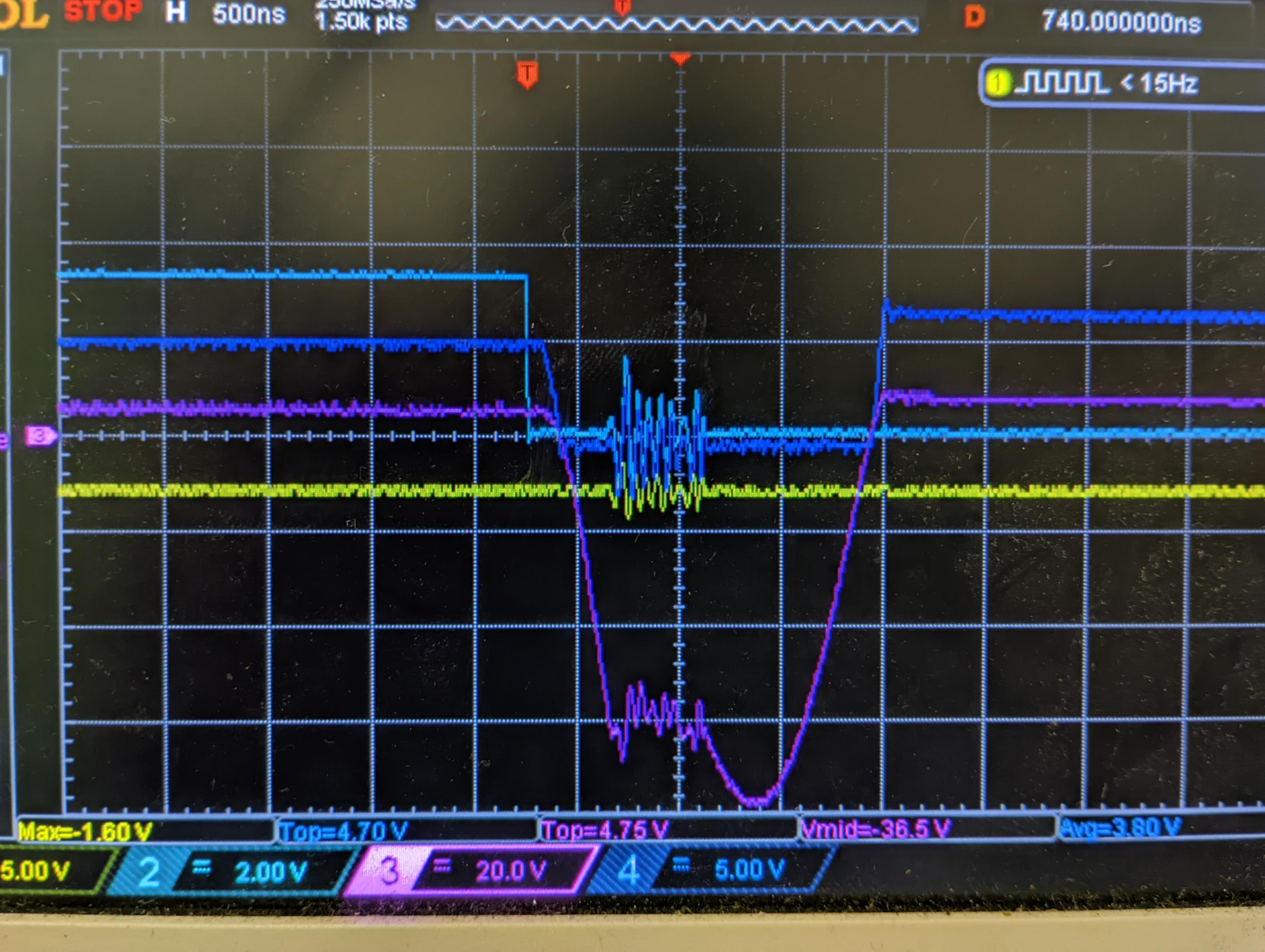

                          • I was getting some high frequency ringing on the damping mosfet.
                            It would appear whenever trying to get close to critical damping. I was using a bench supply to adjust the damping loop voltage for testing.
                            After a bunch of trial and error (and all but one of my BSP230s) I was able to resolve it by placing a 10R resistor in series with the bsp230 gate.
                            Running it connected to a de-tech 8" coil. Had to drop the tx time down quite a bit to lower the flyback, will have to wait for more mosfets before trying to increase it again.
                            Light blue: tx signal Dark blue: bsp source
                            Pink: flyback/ bsp drain
                            Yellow: damping voltage/bsp gate
                            Pink flyback, light blue tx signal, dark blue drain (bsp230)
                            • Originally posted by tpet93 View Post
                              Just checking if you managed to improve on the ringing..?
                              • Yep, adding the 10R resistor in series with the gate of the damping mosfet fixed the ringing.
                                still getting some warbling and bouncing around in the final output signal, unsure how much is expected during normal operation.
                                This is my first venture into high performance metal detectors so i don't really have a baseline to compare to for noise and sensitivity.
                                I was getting some significant dc offset in the output signal coming from the INA125 (capacitor leakage or amplifier input current leakage?) swapping to another INA125 reduced it.
                                swapping out the LM6171 with a fresh chip seemed to reduce some of the warble/bouncing.
                                I'm still running quite a short 12us tx pulse until i get some spare bsp230s so perhaps a stronger transmit signal will make the signal more consistent?
                                As a note for others troubleshooting, when using a speaker and 2*18650s, as the battery's got low, the output started to slowly oscillate at ~0.5hz. I put this down to the speaker drawing more current at low frequency's and causing one of the voltages to drop creating a feedback cycle.
                                could be tricky to troubleshoot without headphones or a screen attached.
