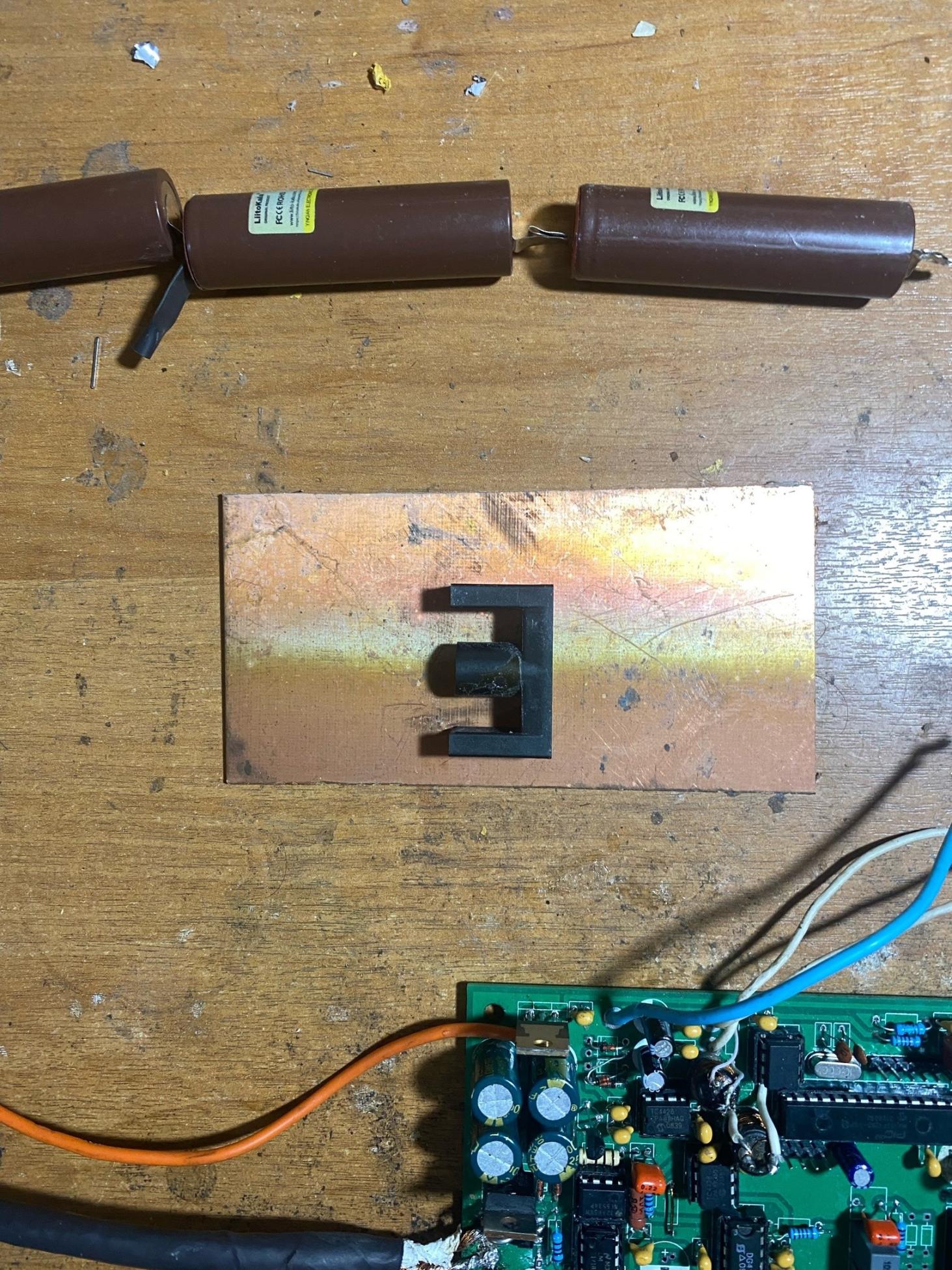

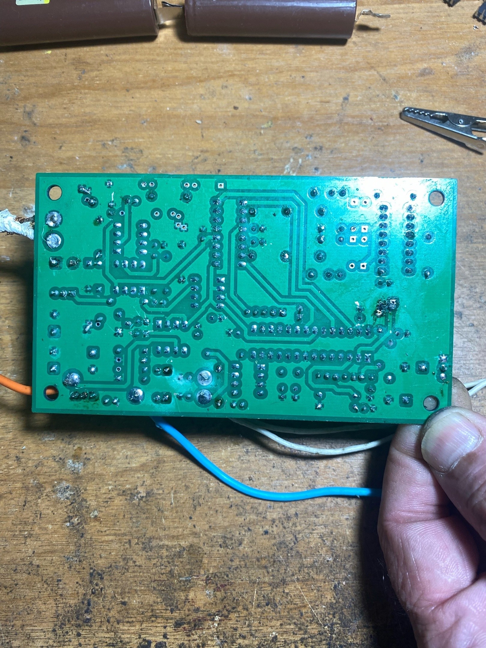

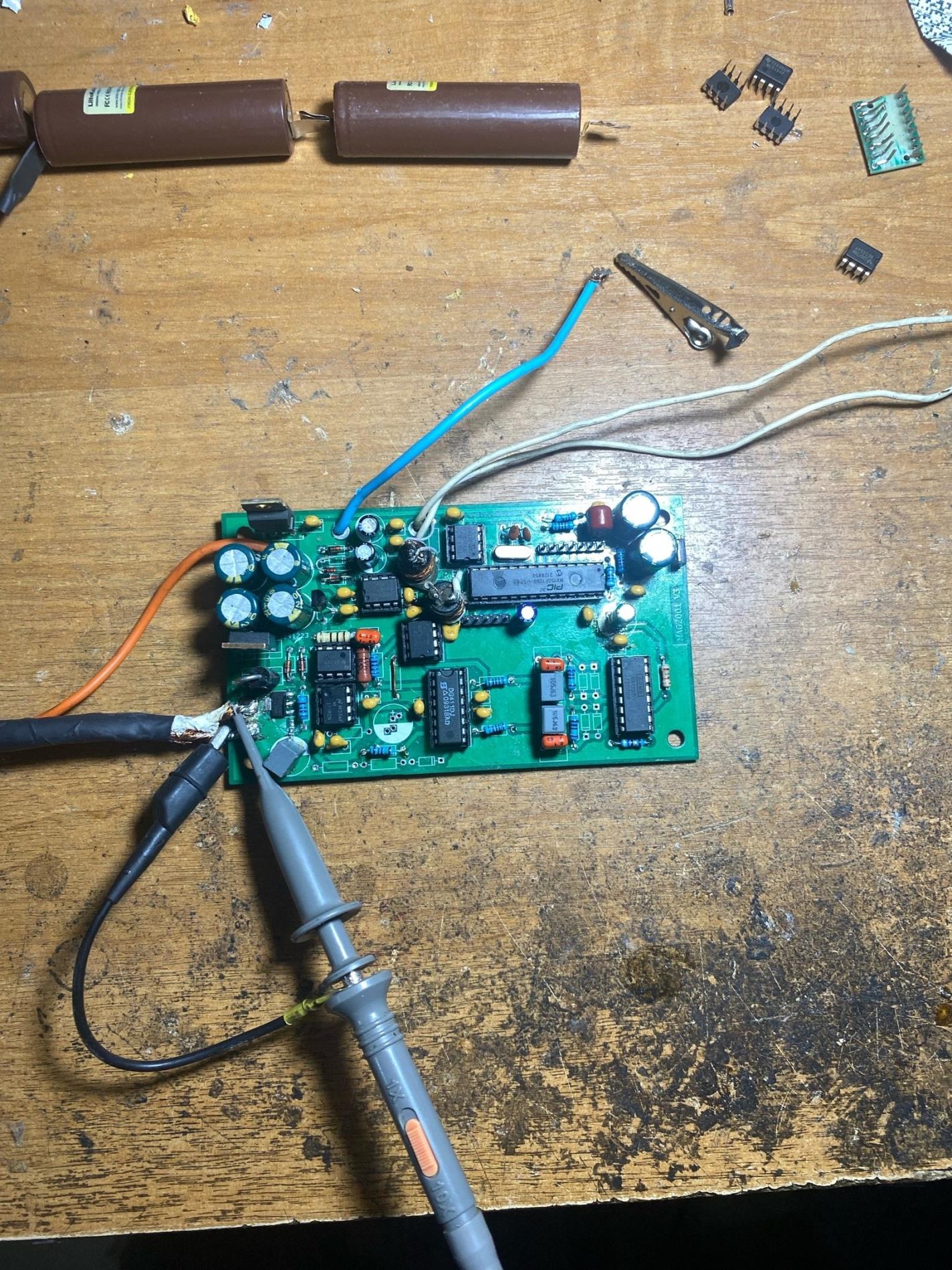

    Hello. I assembled Magpi 3. The speaker produces a constant sound that disappears when the target is brought closer. If anyone has encountered something similar, please help. Sorry for my English
    • Originally posted by AhmatAhmatov1959 View Post
      Please post some photos of the board top and bottom and we will try to assist.

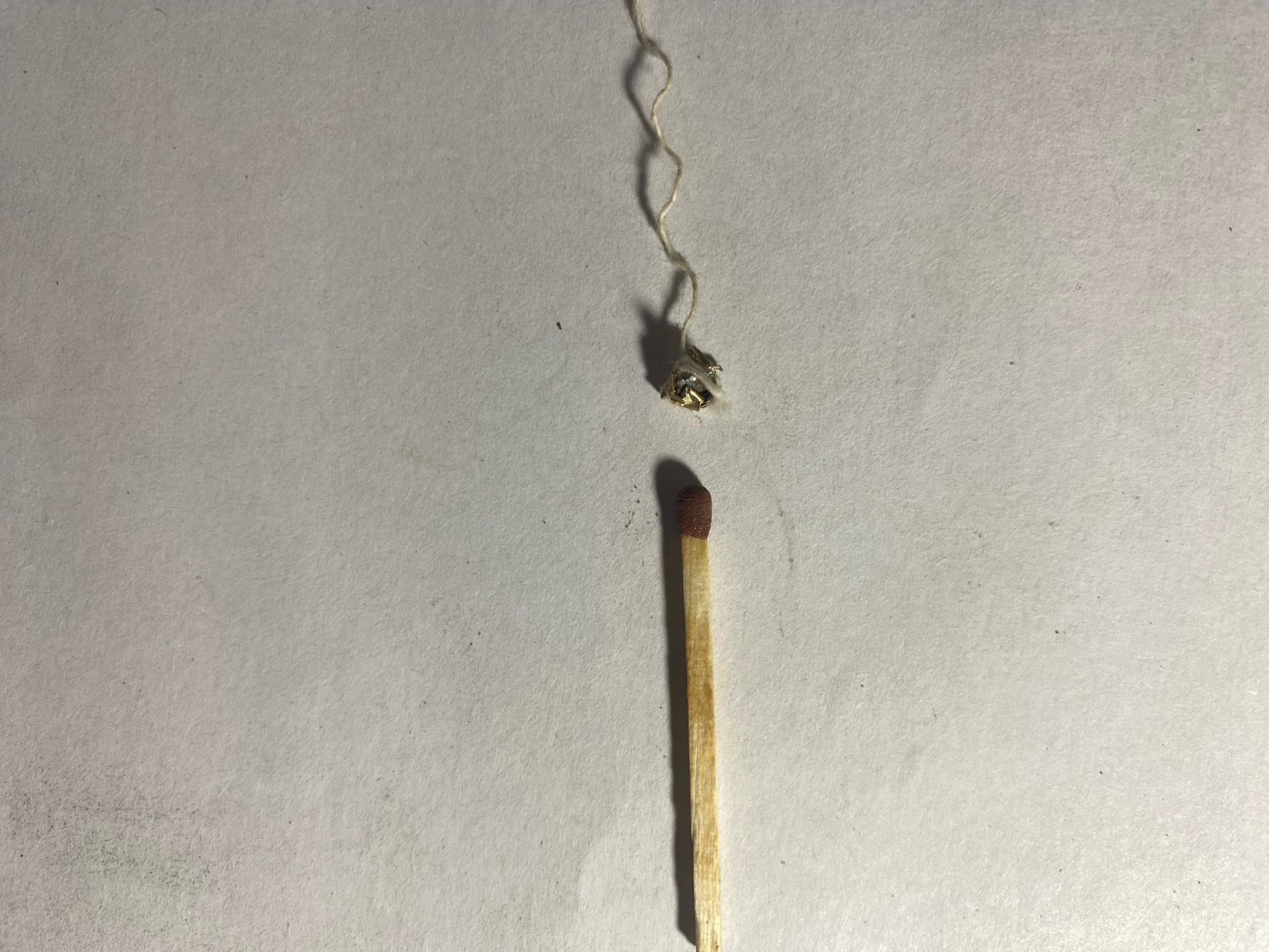

        Hello. Thank you for your reply. I replaced INA125 and it worked. I buy all the parts from ALI. The metal detector has a sensitivity of 20 cm on the hand. On ferrite 15 cm. On copper getinax 50-60 cm. The gold in the photo is compressed foil, it is not an ingot. 3-4 cm. The coil is homemade with a diameter of 20 cm. I made a rope from 44 insulated wires 24 meters long and 0.17 mm in diameter wound 26 turns, left 1 meter at the beginning and 1 meter at the end. The initial meter was wrapped with 10 layers of Teflon tape and put into a heat pipe, and on top I made a screen from the last meter, additionally added 5 wires to the screen for connection to the graphite screen. The Chinese tester showed 280 mcg, 0.4 Ohm and 850 kHz together with the cable, I thought that this was a good result. If of course the tester is not lying. I have several questions for you. 1 What to do with the voltage on the coil. 2 What transistor can replace the BSP230 for higher voltage. 3 How to reduce the influence of ferrite.

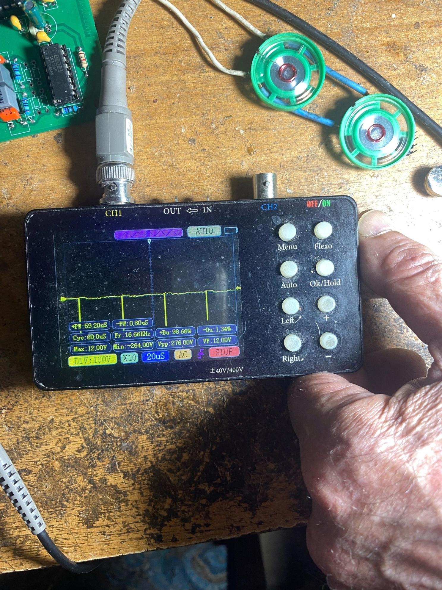

        I soldered a 120 pf capacitor parallel to the coil but did not notice any changes. Click image for larger version

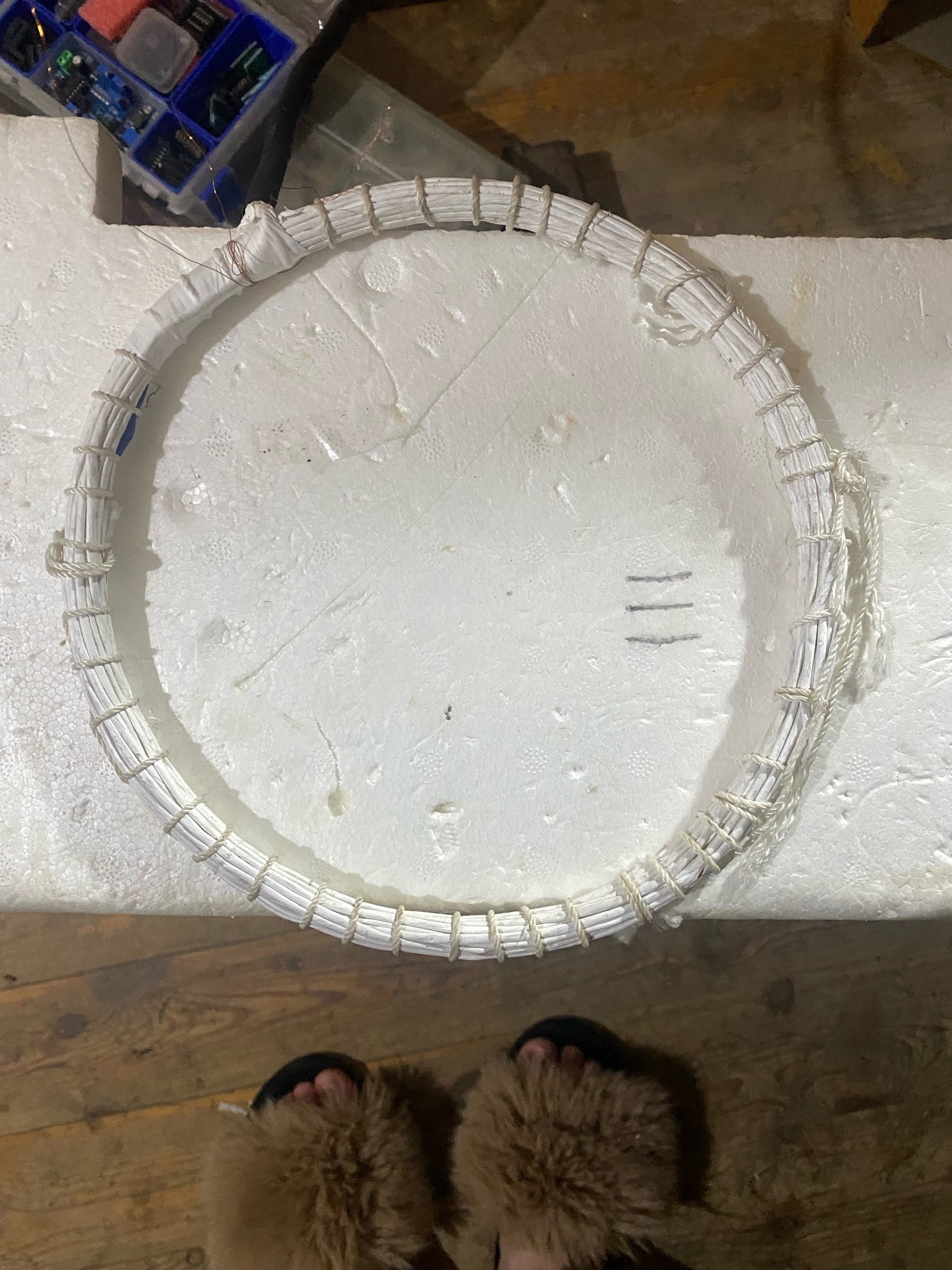

          Hello. Please help. The metal detector is very sensitive, it reacts to a hand, a wooden ruler, a plastic ruler at a distance of 20-30 cm. Which screen for the coil would be better, aluminum foil or graphite. If graphite, what resistance should be at a distance of 1 centimeter. The only change I made was the use of LM7171. Thank you
            If the coil is picking up your hand then most likely there is no faraday shielding on the coil.
            You can use graphite paint ( make your own out of a few drops of varnish mixed with acetone and large spoonful of graphite powder in a glass jar.)
            Lay down a very very thin copper wire connected to ground of the coil cable along the coil circumferance ( however do not connect the ends of the copper wire to form a loop !! )
            Paint the graphite mixture onto the coil in a thin continous coat ... but leave a gap ( eg 5 mm ) so no loop is formed.
            test and reapply graphite if necessary.
