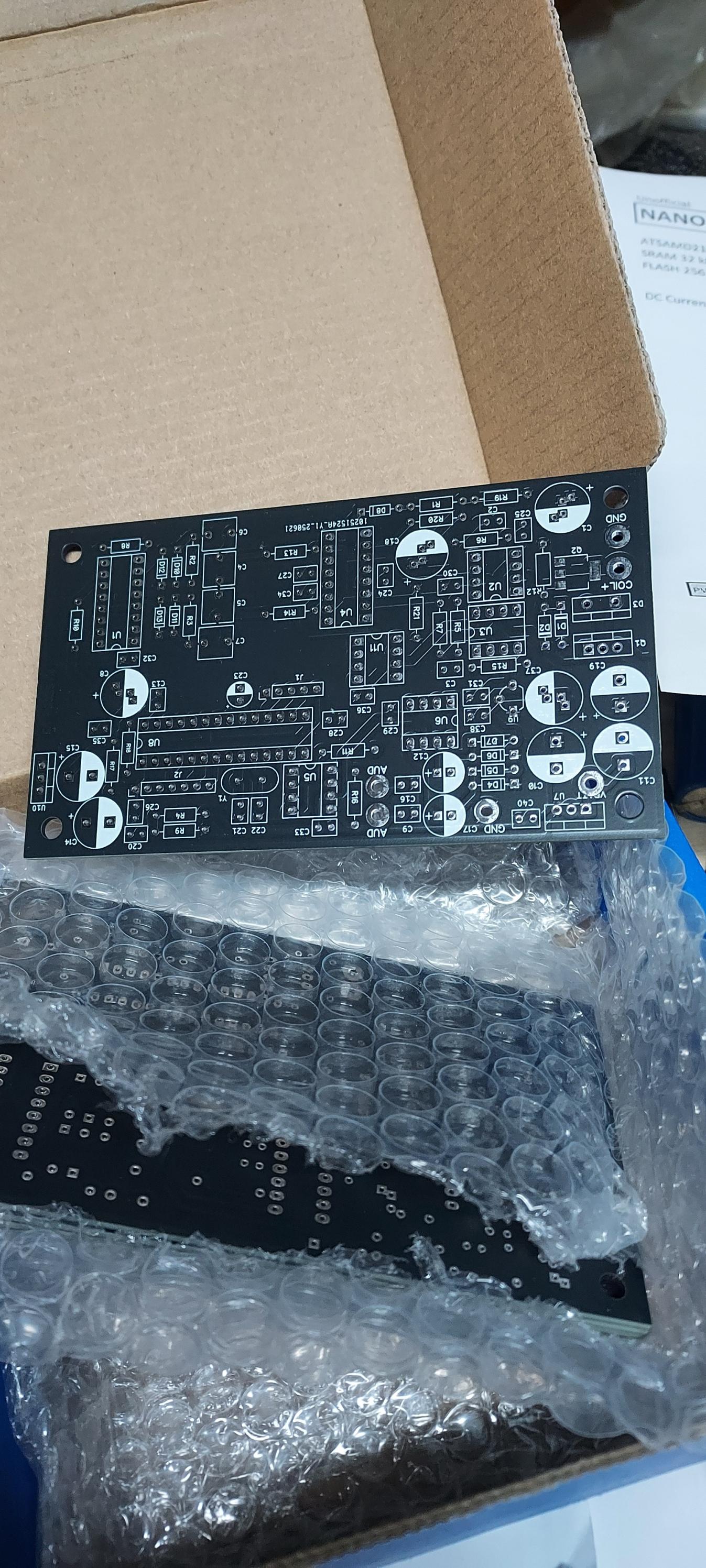

ID:	438815Got my boards today, turned out nice. Need a few more parts and finish up another project then will get started on this.

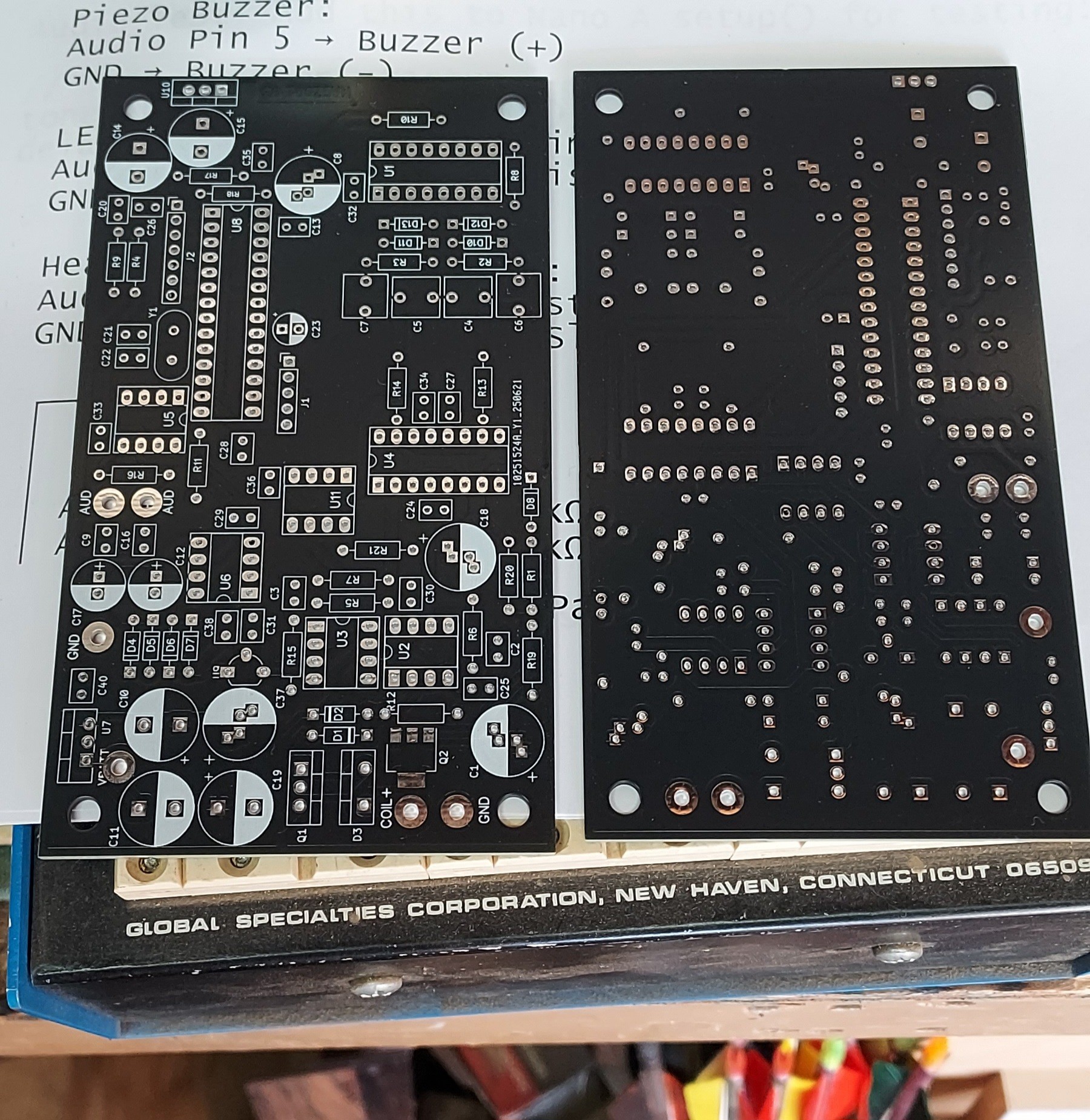

      • Very beautiful. Can you picture it front and back? Excuse me
        • Originally posted by Technologyh View Post
          Sure, front and back...

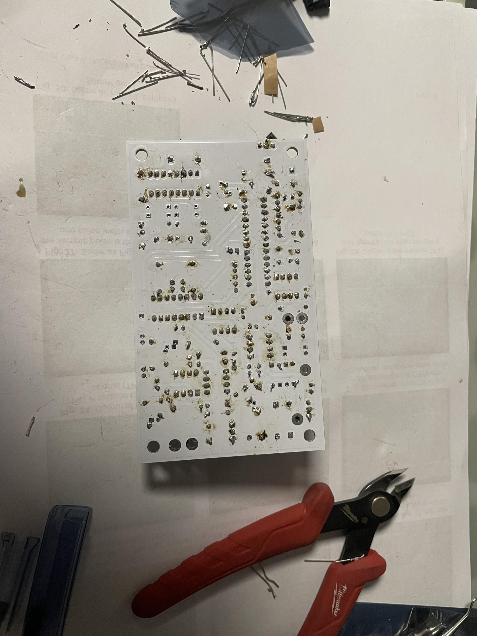

            • After having the PCBs and parts for a few days, I couldn’t help but start putting it together. It took me a while to get the hang of soldering. Mostly I solder car wires of about 1.5mm squared. I won’t be getting high marks for soldering. Though the IC sockets were easiest, and some of those joints might even have the recommended amount of solder. Most other joints have a bit too much. I chose lead free HASL for the PCB tinning.
              All that’s left is the 100uF charge pump capacitors (I ordered 6.3v and it might not be enough. More to be ordered), the BSP230 (will a BSP225 be ok here?) and the coil socket and screen parts.
              some of my components look odd. Resistors are 1%, and 1/4W or higher, though they are small. In hindsight, I should have looked into the voltage rating of these. 200v is the limit, though they handle more intermittently. Clock capacitors are C0G / NP0, and I used ceramic caps for the 1uF parts, X8R. The hope is that parts with better tolerances or less temperature variations may be beneficial.
              The downside is, the more I stray from Moodz’ component choices, the more risk there is that some components may need changing. Or worse, scope testing. I haven’t got the talent he has. I just like to read datasheets. I work on car wiring mostly.

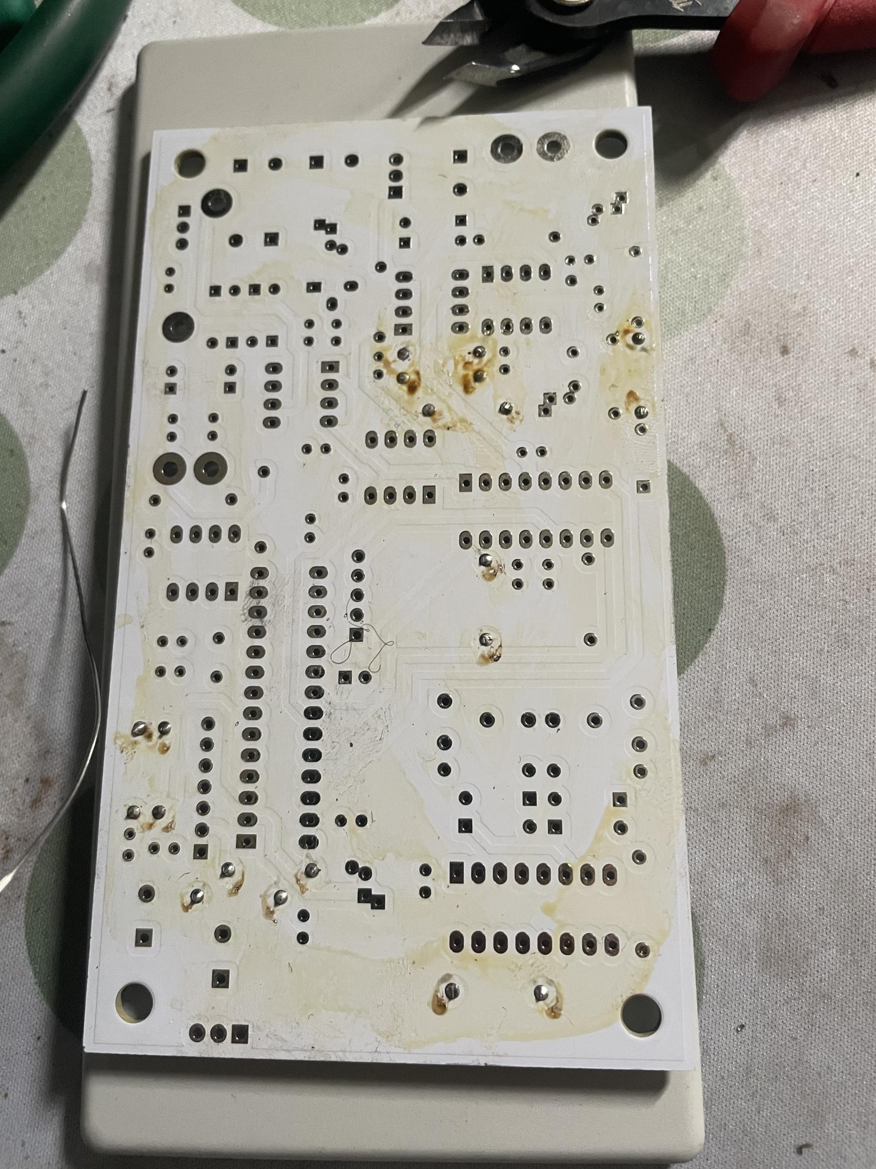

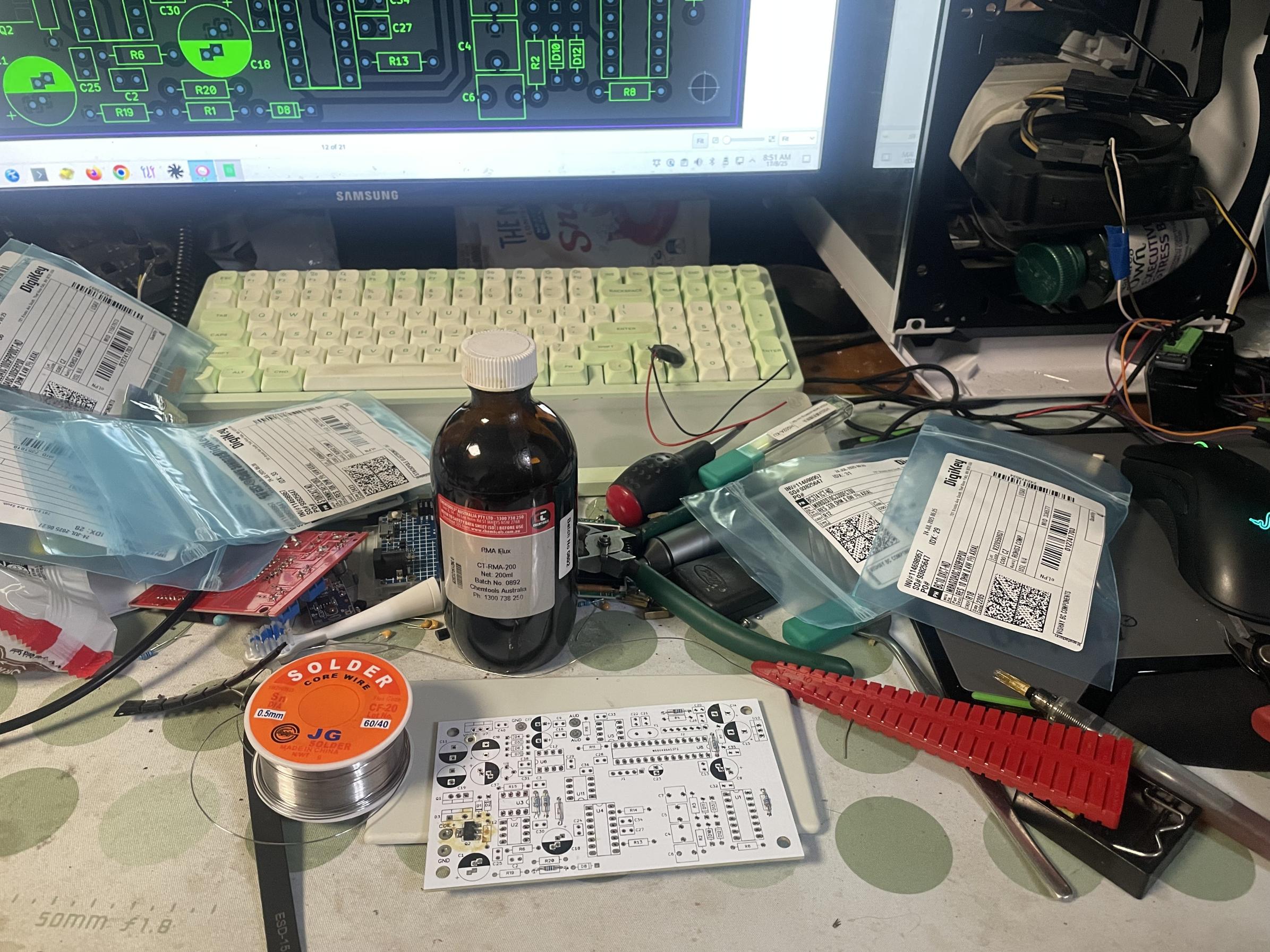

                            • After years of soldering, I have finally realised the importance of using flux. And although solder does have flux in it, it’s not enough to get good results with
                              These are before and after photos with flux and smaller solder
