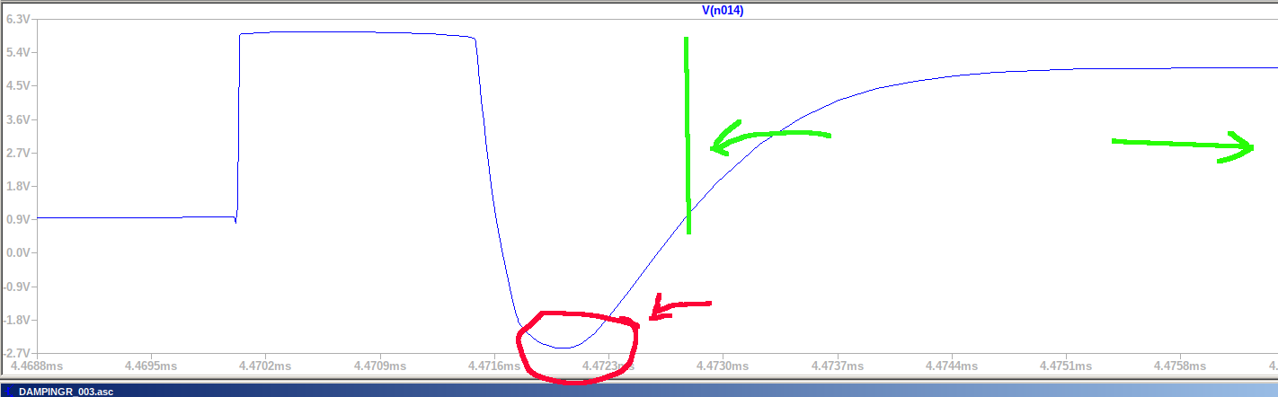

                      To answer your question ... the Magpi 3 is a "demonstrator" platform not a "uber detector". I spent all of 5 minutes selecting that opamp. The reason it was chosen ( say rather than a NE5534 and I am not saying the NE5534 is choice either) is that it can take rail to rail overload voltages at the input whereas the NE5534 has the equivalent of diodes across the inputs so any overload voltages above 0.6 volts cause current to flow in the opamp inputs. This is not good as it a causes errors in the current damping that the V3 uses.
                      Feel free to choose your own opamp ... V3 is for experimenters.
                      For instance the noise cancelling loop still does a great job ( even with the 6171 ).
                      And importantly PI ferrous / non ferrous discrimination is there in plain site ( bad luck .. patent guys :rotfl ) ... it just was not implemented in V3 ... but can be with simple software change.

                            Fast coils are fast because the capacitance is low .. however if you utilise the energy in the coil ( 1/2 LI squared ) the capacitance term is not there and the time constant of a shorted cap approaches zero... so capacitance is less consequential.
                            So regardless of how "fast" the coil is my latest circuit can damp a typical PI coil in around 500 nanoseconds ... much faster than anything else I am aware of

                            • Hi Moodz,
                              Really very impressive - 500ns! In my practice (not very big), every attempt to use delays under 2.5us haves bad results - the screen of the coil stops to works as screen and the connecting cable starts to be more sensitive
                              to near hands than the coil. It seems for me, these 2.5us are "magic" border! Do you have some explanation for this effect? Or I not understand what really happens?
                              Thank you in advance!
