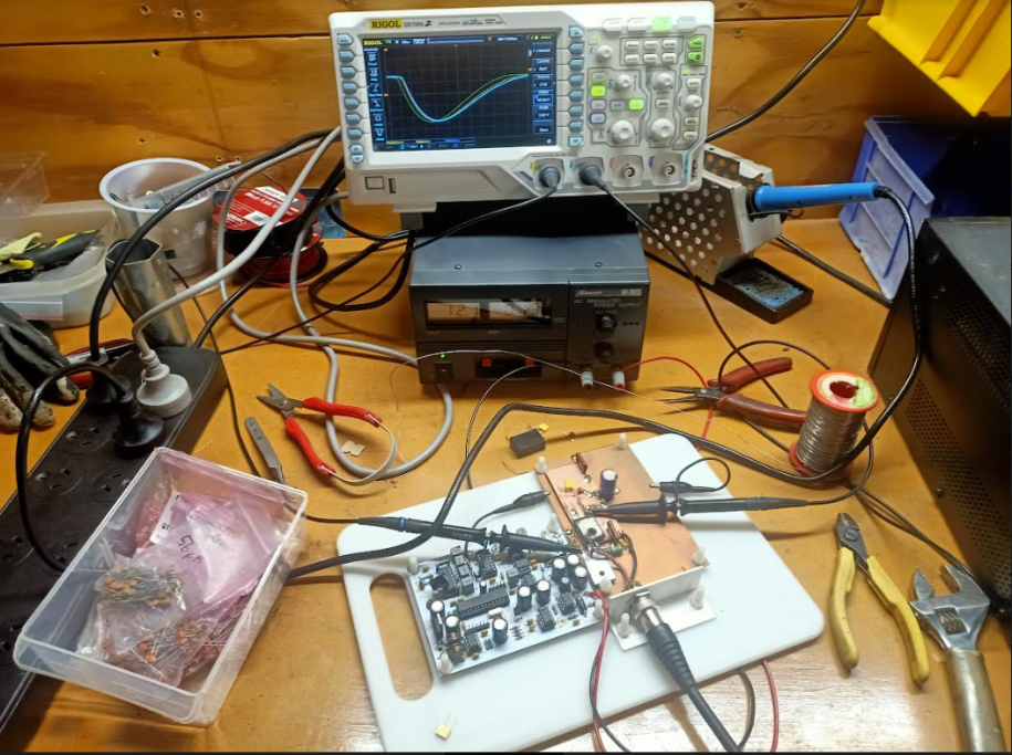

      • The Magpi has been fitted with NMOS TX parts and autodamping. Should be able to do 2 amps transmit @ 600volts peak.
        Autodamping means the CPU no longer controls the active damping - faster recovery and tracking ... possibly be able to do iron discrim also.

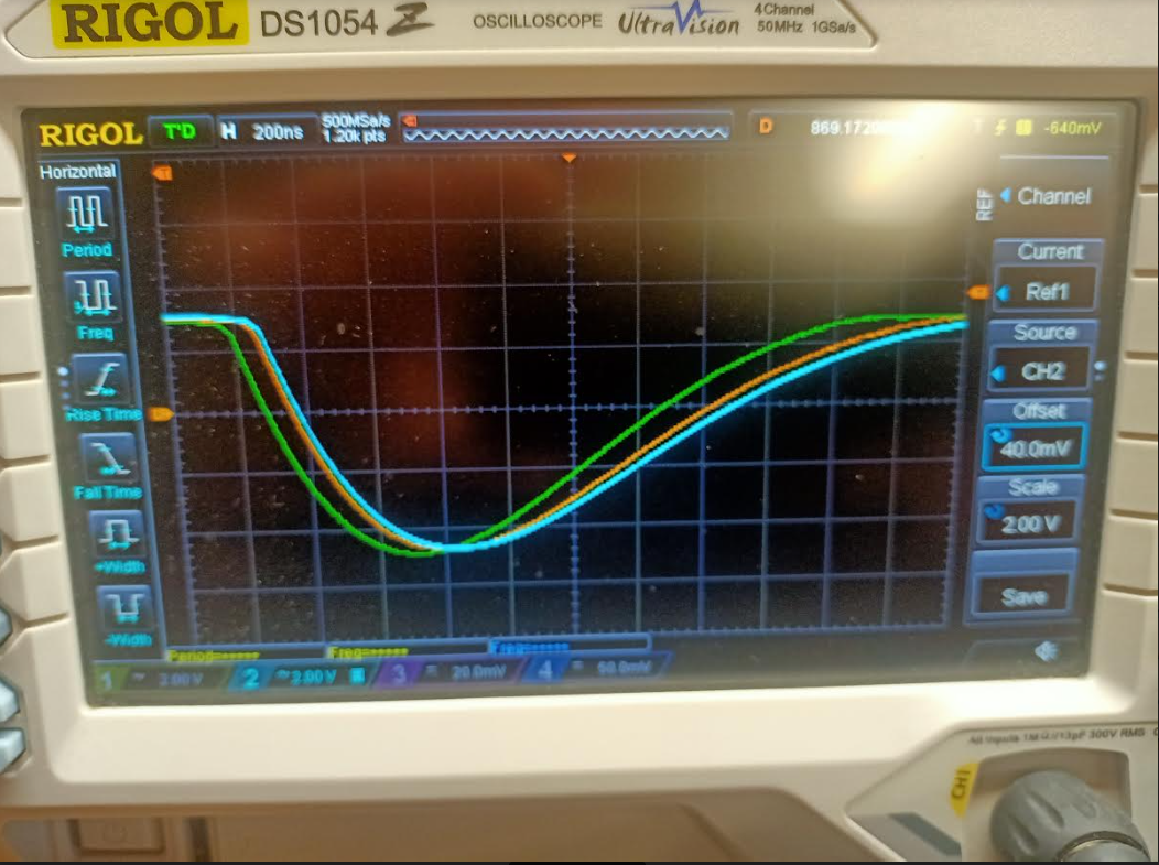

        Pix below for 1 amp 350 volts. 8.33 Khz TX. Traces show no target, IRON and COPPER. No amplification ... ( ie straight off the autodamp frontend ).

                Yes you did hear correctly ..the auto damping function damps the coil and prevents high voltage hitting the front end amplifier but there is no amplifier present ... so we are looking at the coil through the damping circuit. If you noticed that iron causes the signal to rise. Non iron causes the signal to fall. So discrim is very obvious and easy to do.
                • Pictures tell it all ... cant be more obvious ...PI discrim is done. Are you familiar with fourier transform of unit pulse ?

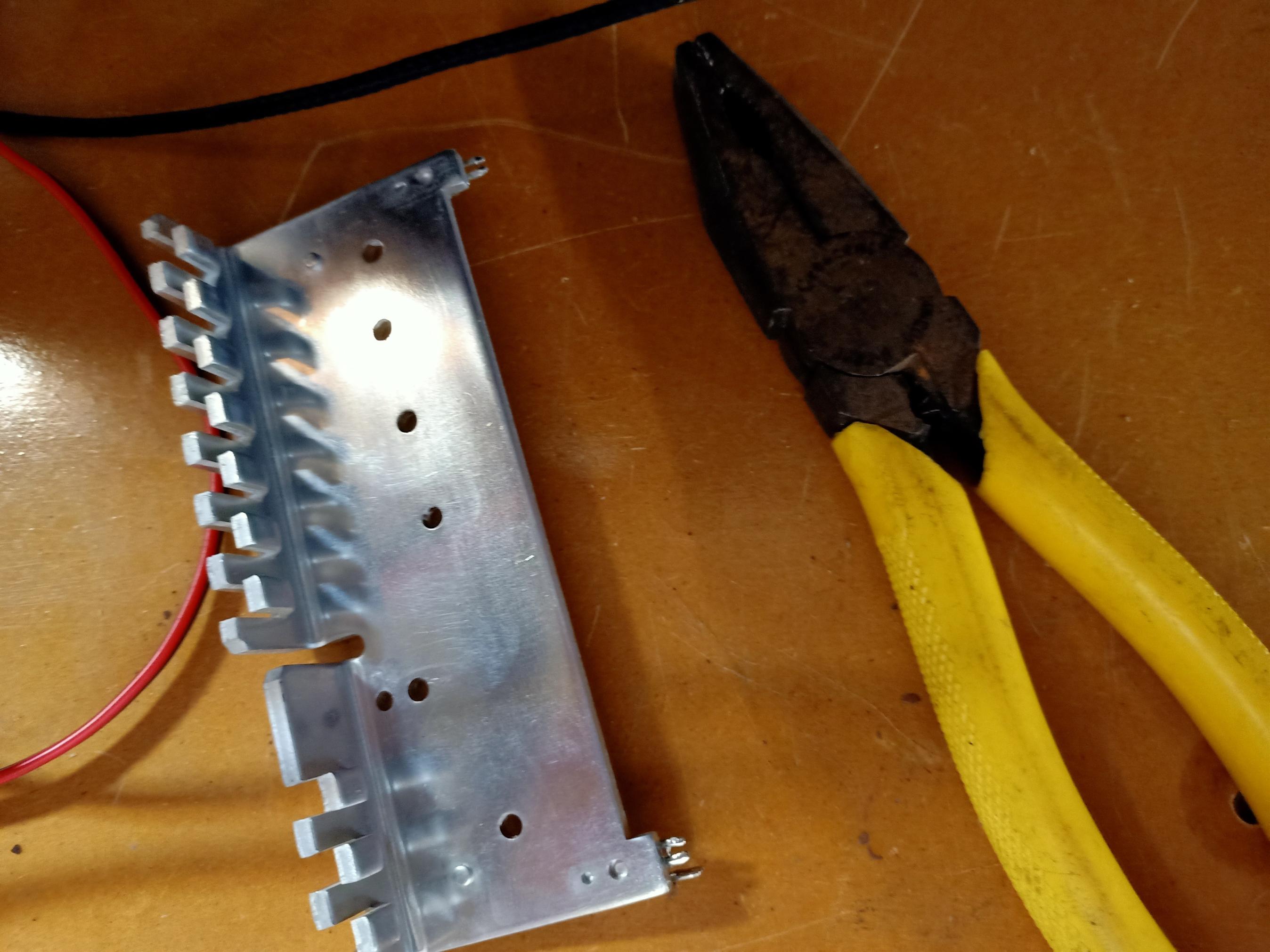

                  Pliers and aluminium heat sink. Blue is no sig. Orange is pliers. Green is heatsink.

                      This particular problem cant be modelled easily but involves stabilising a DC operating point with microvolt stability and still resolving the targets. So yes on the bench we can discrim targets but when conditions are not stable ( like waving detector around ) there is another story. So I will build a new piece of hardware to test this.
