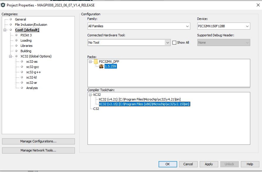

            • Thanks moodz, unfortunately I can't build the software and get multiple errors saying it can't find Adc10.h
              I've installed the legacy plib library.
              Any ideas ?
              • Originally posted by Gunghouk View Post
                Any ideas ?
                If you are getting errors about Adc10.h .... it means you did not read post #248.
                You MUST use compiler version 2.15 and legacy PLIB installed in that path.
                Download it from the archives on the microchip site.
                I downloaded #248 to check and here is my build result ... no warnings or errors.

                change the chip to what you have eg 150 or 250 version in project properties.
