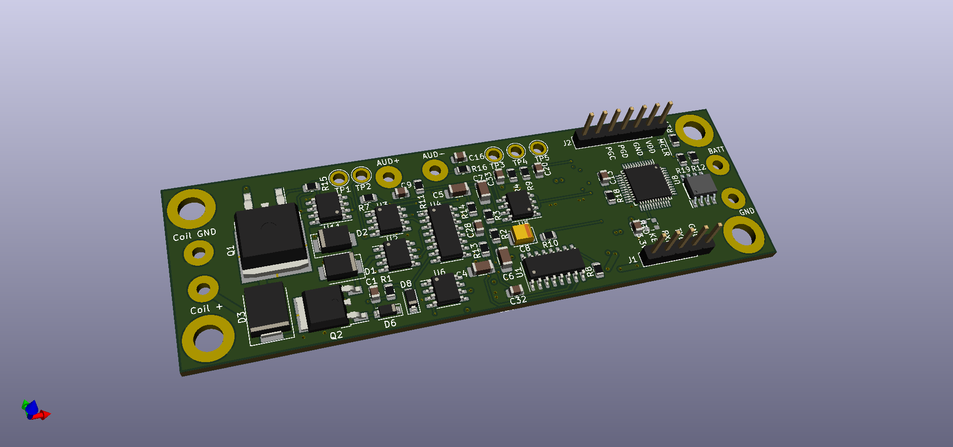

    First iteration of a miniature MAGPI v3 in SMD. Board is 100 mm x 50 mm.

    Well I have completed (almost) an improved version/layout of the SMD version of the PCB that I plan on using as the basis of a probe. The new PCB is 31.7mm x 100mm.
    Top:
    Bottom:

        Hi KJ,
        Really nice PCB just curious to know how many layers and the stackup..?
        • Originally posted by Dean Sarelius View Post
          Hi KJ,
          Four... top inner layer = power plane, bottom inner layer = GND, top and bottom layers for routing & component placement.

                If you are getting boards made could I put my name down for one?
