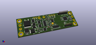

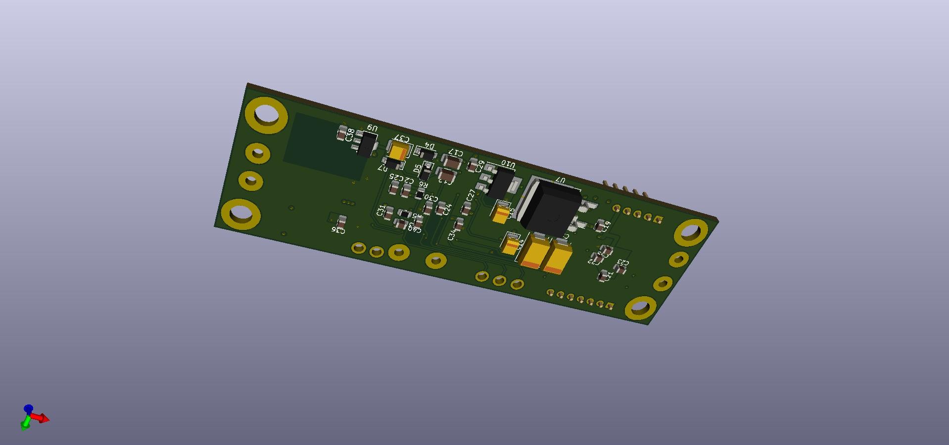

          Well I have completed (almost) an improved version/layout of the SMD version of the PCB that I plan on using as the basis of a probe. The new PCB is 31.7mm x 100mm.
          Top:
          Bottom:
          Dear KingJL will you share improved version of board ?
          • Originally posted by wtrk View Post
            There are a couple of things to note and understand... the current version of the "MAGPI Probe" circuit has some differences from moodz's MAGPI V3. First and foremost is that it uses a different processor... a PIC32MK0512MCJ048. I tried to maintain the port/pin mappings the same if possible, but the PIC32MK...MCJ has one or two peripherals that cannot support the original port/pin mapping. I am also using a different Q2 damping MOSFET and D1 diode. There is also an AT24C256 EEPROM added to the design (I have been previously been bitten by CPU failure from using flash memory for parameter storage after a year or so of operation... something called cell "endurance"). Also in the very latest layout (not yet posted), I am changing the the off-board connection arrangement slightly.
            I am still "polishing the design/layout... things like rechecking to insure I have the correct footprints assigned and a sanity check of the processor pin/function. I have not even really started the actual "port" of the code.
            Having said all this, when I finish verifying the PCB layout (will be done sometime within the next week), I will publish/post the Kicad project (including Gerber's) as as a zip. It will probably be done in a separate thread so as not to interfere/confuse with moodz's MAGPI development. The code port will take a little longer as I have about 4 or 5 irons in the fire on the coding side.
            But remember this is NOT MAGPI V3 (so don't inundate moodz with questions/problems of the "MAGPI Probe") and as of now the MAGPI Probe DEFINITELY is NOT just "BUILD/FLASH/and GO"!

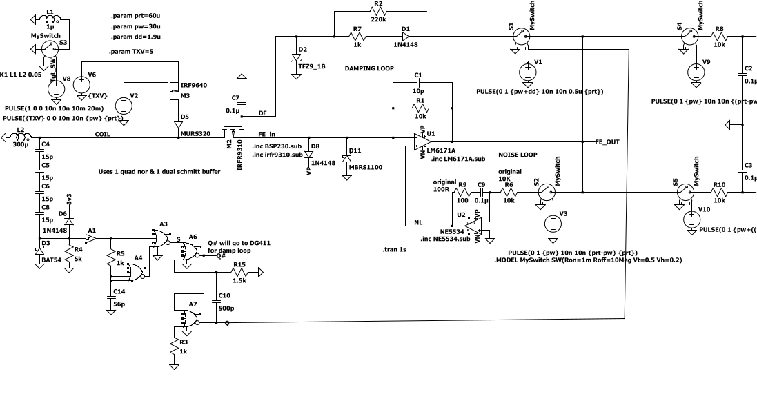

                    • Paul,
                      I am experimenting with a hardware solution (4 capacitors, 2 diodes, and 6 NOR gates) for generating the damping loop sample pulse that automatically adjusts the timing of the sample pulse to the coil being used. Initial Checking out with [email protected] ohm, [email protected] ohm, 1500uh@4 ohm. Initial indications are looking good. The damping loop sample width, of course, remains constant. Is there any need you see to have the sample pulse width variable? Will post solution after a bit more testing.
                        Paul,
                        Good work ... the sample width seems to affect loop response speed but also how noisy it is ( eg jitter ). I just set it for generic monocoils around the 300uh mark ... its pretty forgiving.
                        For tracking almost any coil I used a single diode peak detector with a "leaky" resistor across the damping gate cap.
                        moodz
                          Paul,
                          I am experimenting with a hardware solution ... for generating the damping loop sample pulse that automatically adjusts the timing of the sample pulse to the coil being used...
                          Here is proposed a hardware circuit to automatically adjust the timing of the damping loop for idiosyncrasies of the TX coil(e.g. inductance, SRF, target load influence, etc). This circuit is implemented with 4 200V 15pF capacitors, 2 diodes, 4 resistors, a 56 pF capacitor, a 500 pF capacitor (both low voltage), a dual schmitt buffer IC and a quad NOR gate IC.
                          Click image for larger version  Name:	Auto detect circuit.png Views:	0 Size:	121.0 KB ID:	410684
                          Referring to the attached partial schematic above: C4, C5, C6, and C8 form a voltage divider network to get the ~400V TX pulse down to something that the rest of the components can tolerate without significantly changing the characteristics of the TX coil circuit. I use 4 200v 15pF capacitors here as these are readily available in a 805 package. D8 is a clamp that presents the TX flyback pulse as a positive across R4. D6 limits the voltage to the 3.3V rail.
                          The logic circuitry: A1 is a schmitt trigger buffer that creates a nice digital logic signal that is the same width as the flyback pulse. A3 & A4 form a falling edge detector circuit (the RC network R5 & C14 provides a propagation delay to A4 so as to create a suitable pulse from the trailing edge). A6 & A7 comprise a one shot multi-vibrator with the one shot time determined by C10 & R13.
                          For the simulation, the Q output is fed to S1 (electronic switch in lieu of the voltage (V1)). In the actual circuit implementation, Q# will be fed to the DG411, U4B, pin8 (S1).
                          I will be posting results of sim runs for a 300 [email protected] ohm, 100pf with original timing control (V1), same coil with timing control via automatic hardware proposal, 800 [email protected] 0hm 150 pF with auto control, and 1500 [email protected] ohm 200 pF with auto control. These sims take a while to run as they are end-to-end complete implementation sims (TX, active damp, noise canceling AFE, integration filters and INA125. I am running these sims for a full second so that the system is well stabilized. The first set of sims are with a target coupling of 0.05.
                          I will later run a set with a higher level of coupling that shows some pretty interesting dynamics with strong target coupling (that the auto timing hardware option automatically adjusts to).
                          On edit, I should add: In case you want to implement a sim with the proposed circuit, all of the logic components (except the schmitt buffer) have the spice line parameters Vhigh=3.3 Td=10n, Trise=7n. The schmitt buffer has the parameters Vhigh-3.3, Td=4n, Trise=7n.

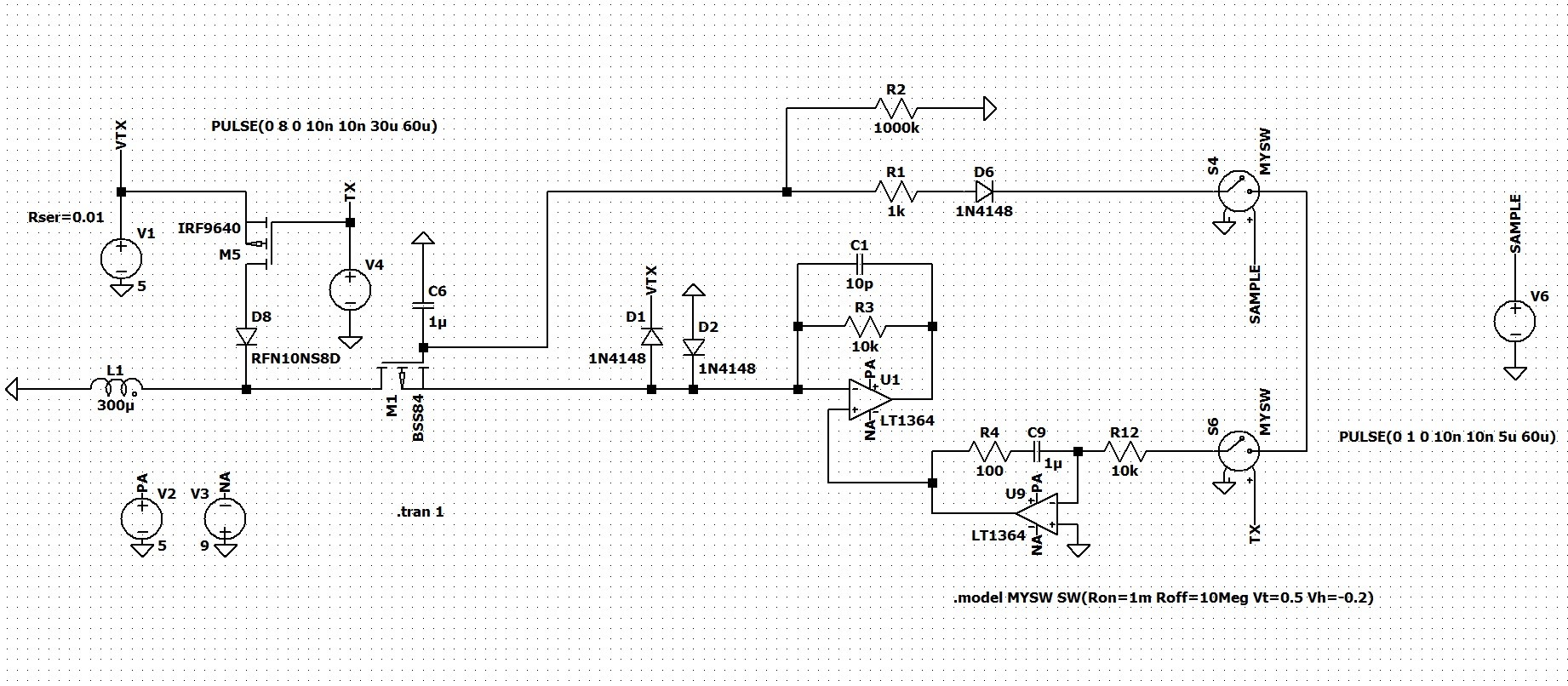

                            Hi Jim,
                            not quite the same as some of my earlier experiments but deja vu for me ... came up with all sorts of schemes to do what your circuit is doing..... The diode in the loop already serves as a peak detector ( so no exact gating required ) there is only a requirement to have it detect during a window in the RX cycle and the loop will automatically find the optimal coil detect point.
                            This is already included in the V3 board. It only requires the fitting of the diode and two resistors and a change to the sampling window in the damping loop ( eg make it 0 to 10 microseconds in the RX period ).
                            This circuit will auto track almost any coil.
                            Here is the sim circuit ... but its straight off the V3. R1 R2 and D6 below ( R20 R1 and D8 on the V3 schematic )
                            moodz

                              ... but its straight off the V3. R1 R2 and D6 below ( R20 R1 and D8 on the V3 schematic )...
                              Paul, the V3 schematic that I have has R20 (sim R2) being 100k, not 1000k ,and connected across (in parallel with) D8 and R1, not connected to GND as in the sim. I will correct that and recheck. Thanks for the update.
                              JLK
                                JLK
                                Hi Jim ... there is a reason why the "auto track" option is not the top recommendation ( I use fixed sampling which will work for coils +/- 100 uH from the "standard" 300 uH ).
                                The resistor values will have to be set based on what range of coils need to be covered .... there are no magic values. Its not a good option for some who dont have a means of testing etc.
                                The autotrack causes loop "wobble" as the loop tries to stay on track. Additionally anything ( like the ground ) that causes a change ... even slightly of the L or C of the coil will cause the loop control to move and again warble or false targeting.
                                In principle it works but in practice it is not as good as fixed sampling for a known coil.
                                Slowing down the loop wobble with additional capacitance / filtering etc causes another problem.
                                It is easy enough to drive an interrupt to the CPU from the trailing flyback edge which will let the CPU set an accurate damping sampling pulse. I was going to do this but ... lazy ... found the fixed sample pulse worked for all coils that fell in the parameter window. Very easy to do the interrupt method though
                                moodz
