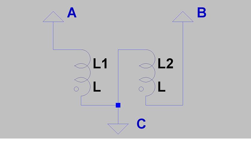

                              Maybe this for clarification:
                              this connection looks like a impedance matching balun .interesting
                                It is ... an air core balun.
