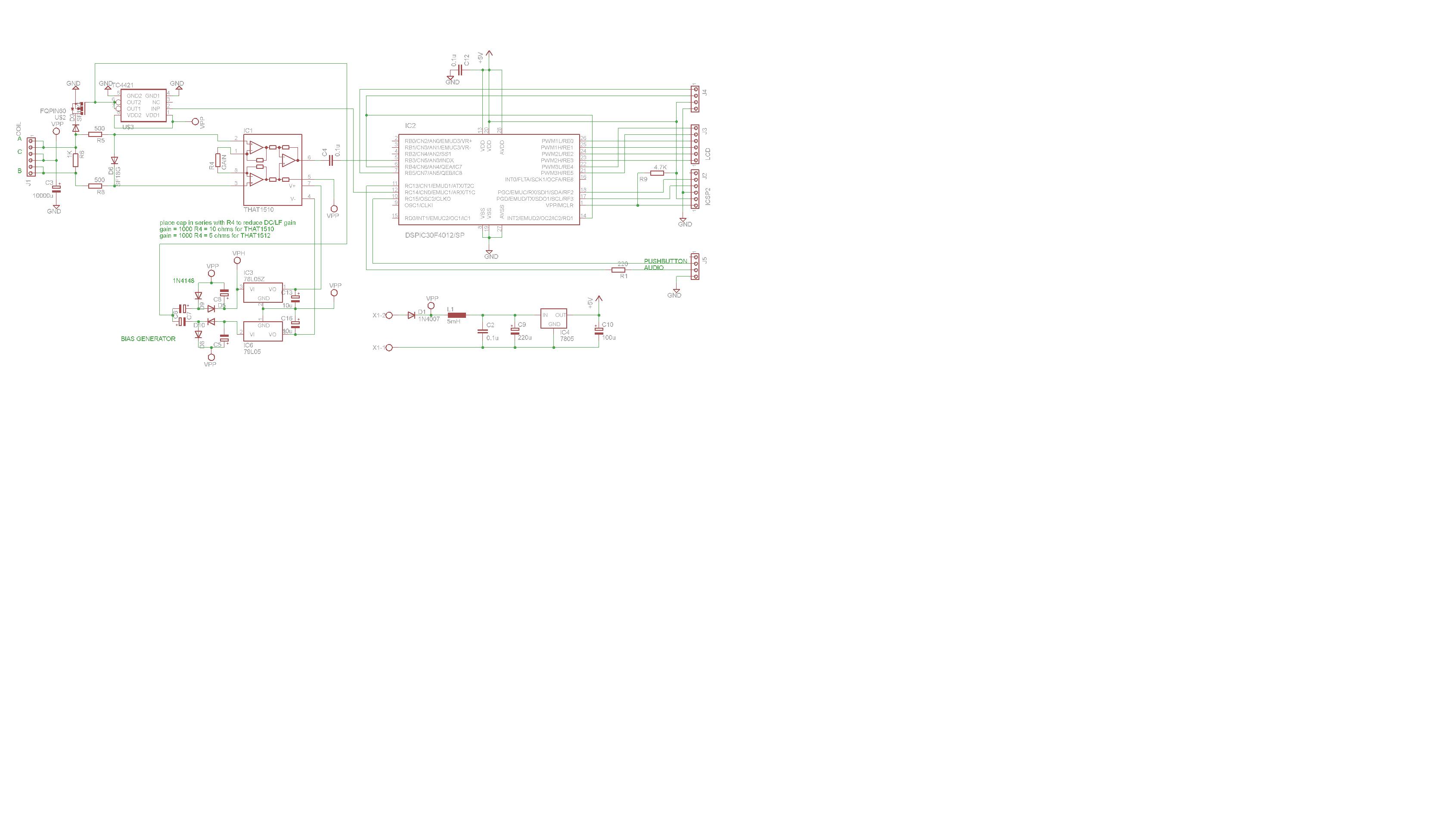

    More experimentation has revealed the circuit configuration that gives high level signal changes for small targets in the coil field.
    The signal is stable in time and amplitude and the configuration is a actually a simplified version of my original circuit which was "over protected" with diodes. The coil can be moved around etc and returned to same position so it is not some weird resonance effect etc.
    There is now only a single clamping diode which has been beefed up to a SF18G ... see specs. The input balance resistors have been dropped to 500 ohms. A dollar coin placed in the centre of the coil generates a volt of wave form amplitude displacement in addition to an obvious phase / freq delta. The gain of the amp is 100.
    I urge those with suitable test / measure equipment to build this circuit and confirm / repeat the results.
    The GOOD news is that this is a significant signal to noise improvement for PI technology.
    The BAD news is that this effect is in a 500 ns window at the base of the flyback response at the amp output so a dspic will probably not be able to extract this artifact and I will probably be looking at developing this further in my FPGA project with a fast ADC. Although you could probably do something with a peal hold circuit etc. Those with CROs should be able to verify on screen though.
    Some very quick tests show that the 22cm 32 turn diff coil is much more sensitive .... it shows nearly 100 mv of signal at 1 meter for large targets like the metal side cover off my computer.
    We need now for others to confirm the results, find the optimal circuit ( I only spent 10 minutes trying this ) and investigate if target descrimination info is also present.
    happy new year from moodz.
    The circuit .... simpler yet better. I have removed all the protective diodes except one and changed the balance resistors to 500 ohms.

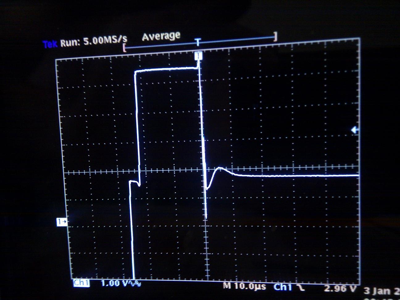

    The flyback pulse at ouput of amp. Note the stepped response now ....

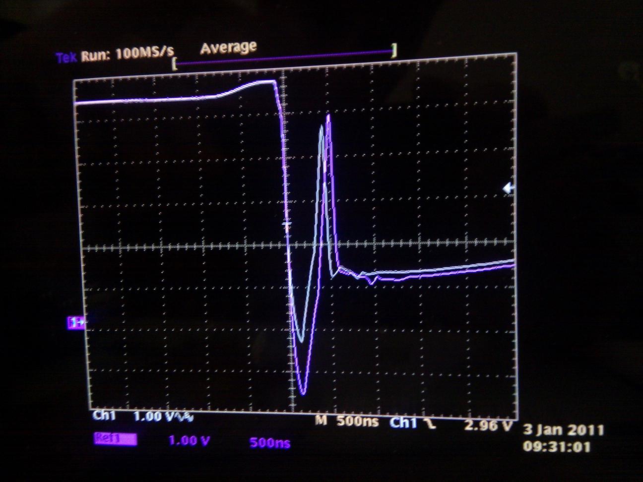

    Purple = NO target .... White = Australian $1 dollar coin placed in centre of coil. 1 volt of signal + phase shifts

        The aquisition window of a conventional sample and hold in classical design would be too wide and timing accuracy might be an issue also. So it would either swamp the signal or miss it timing wise.
        I am sure this is not an impossible problem ... if the CRO can capture it ...so can we.
        The timing can be generated from the signal itself ... this will provide the capture pulse and phase shift information ... a circuit begins to form in my head now ....
                The change of your balance resistors may give less noise, but they extend the flyback /decay appreciably. During the time that the flyback voltage is above the diode threshold, 1000 ohms is put in parallel with the damping resistor causing it to be significantly overdamped. I have been using 2.2K. Noise may be higher, but it still below any valid target signal. The noise with a 2.2k and a THAT1500(or INA217) is still below the typical single ended PI front-end. I guess the trade-off you accept is what suits your design goal.

                      Actually my design goal with this version of the circuit is to investigate the target signal at the base of the flyback. I have examined the input signal to the diff amp on a CRO and it is quite different from normal target decays. I am not sure how it is produced as simulations cannot reproduce it ...

                        Driving the capacitors C6 +C7 with the TC4421, slows down the switch OFF speed considerably. This has a lot of influence on the Flyback and damping time.
                          Maybe we need to experiment with different lower value of C6 + C7.

                            I have to respectfully disagree with you tinkerer .... I did originally drive the bias generator off a separate 4421 dedicated for that purpose however in order to reduce the component count I measured the impact on the fall time to the gate and it is approximately 5 ns ..... given the modest design goals of the Model T .... 5 ns is neither here nor there. The 4421 is a surprising beast in terms of drive capability .... if it had a higher voltage rating it would make an excellent coil driver in its own right.

                              About C6 and C7, I dont't see any values on your schematics, just guessed at a few tens of nF and looked up the datasheet. The TC4421 indeed has lots of power and you have paralleled the 2 outputs. 5ns is nothing. Good show!!!!
                              I found that in a situation like you show on the scope, it helps to add a small feedback capacitor. It reduces the band width and the signal amplitude, but it also integrates the signal and gives more time to sample it.
