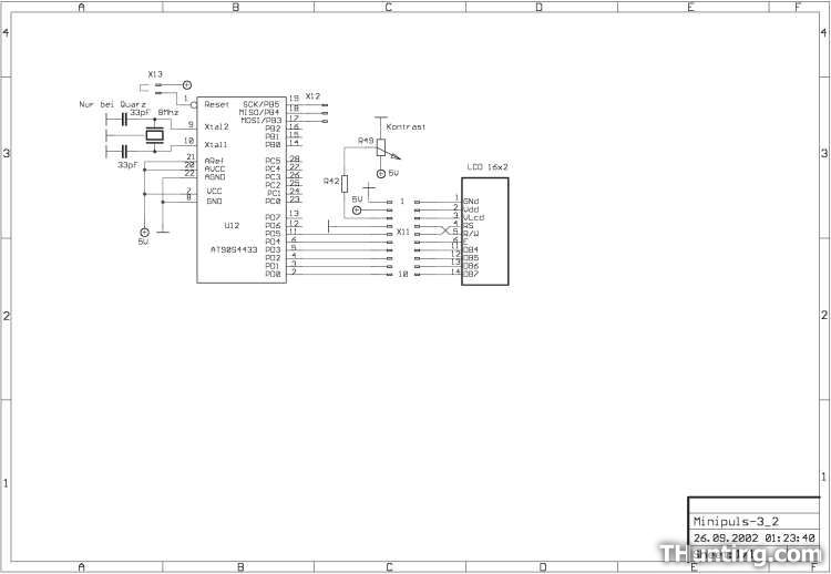

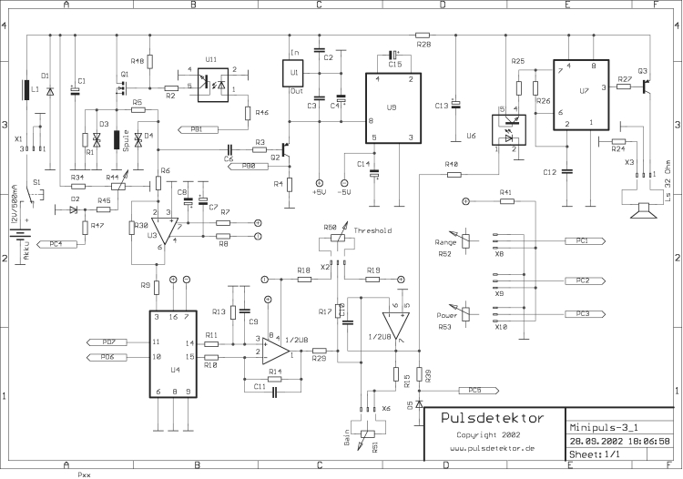

      Ive almost finished this project based round the minipulse 3 with extra refinements, its based around the ATMEGA8-16AU chip.
      If you notice on the circuit x9 at the moment is not used but by replacing the gain pot for a twin gang maybe bring it to 10bit sampling what do you think?.
      Just wondering with mods wether it would be possible to maybe introduce your design based around the DISPIC30F4012 and or also your front end design, or infact any pointers to improve the design.
      Anyway food for thought I know your a busy man, the full spec sheet is on the designers web page as bottom right hand corner of sch1.

        Hi Dave ... The circuit has alot of similarities to the surf PI however I am unfamiliar with the performance .... it may be good or bad ... maybe others on this board have some experience they could contribute ?? ....
        Anyway I would advise you complete the project as per the design then maybe we could establish some benchmark measurements upon which to determine if any change we make might actually result in an improvement.
        I am presuming the designer knew what he was about ... however straight up we can see that the sync feed for the synchronous power through C6 is right dodgy driving off the receive signal .... As for sampling at 10 bits I am not entirely sure what you mean by using a dual gang pot .. maybe you had some particular scheme in mind .

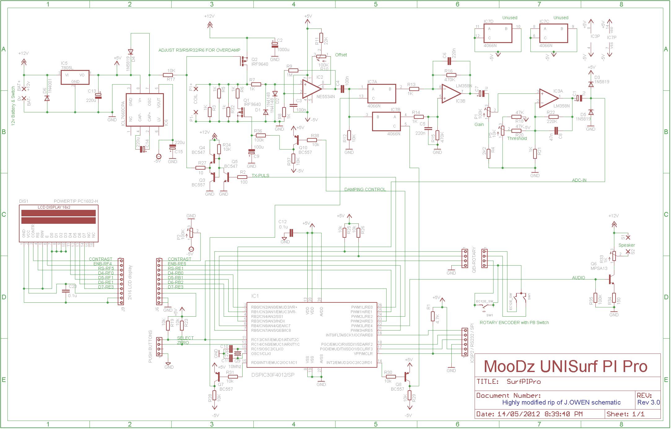

              Max ...as promised ... here is your schematic ... I have chopped out everything that was not needed ...could do a bit more chopping however I have preserved the critical parts that characterise the surfPI design ...
              The schem is a modded rip from here ... http://www.geotech1.com/forums/showp...7&postcount=18 ... thanks to Jim.
              moodz

              • Great work Moodz
                is there still a xtal on pins 9/10 ?
                  Great work Moodz
                  Ah ... I'll put that in on the next update ...:

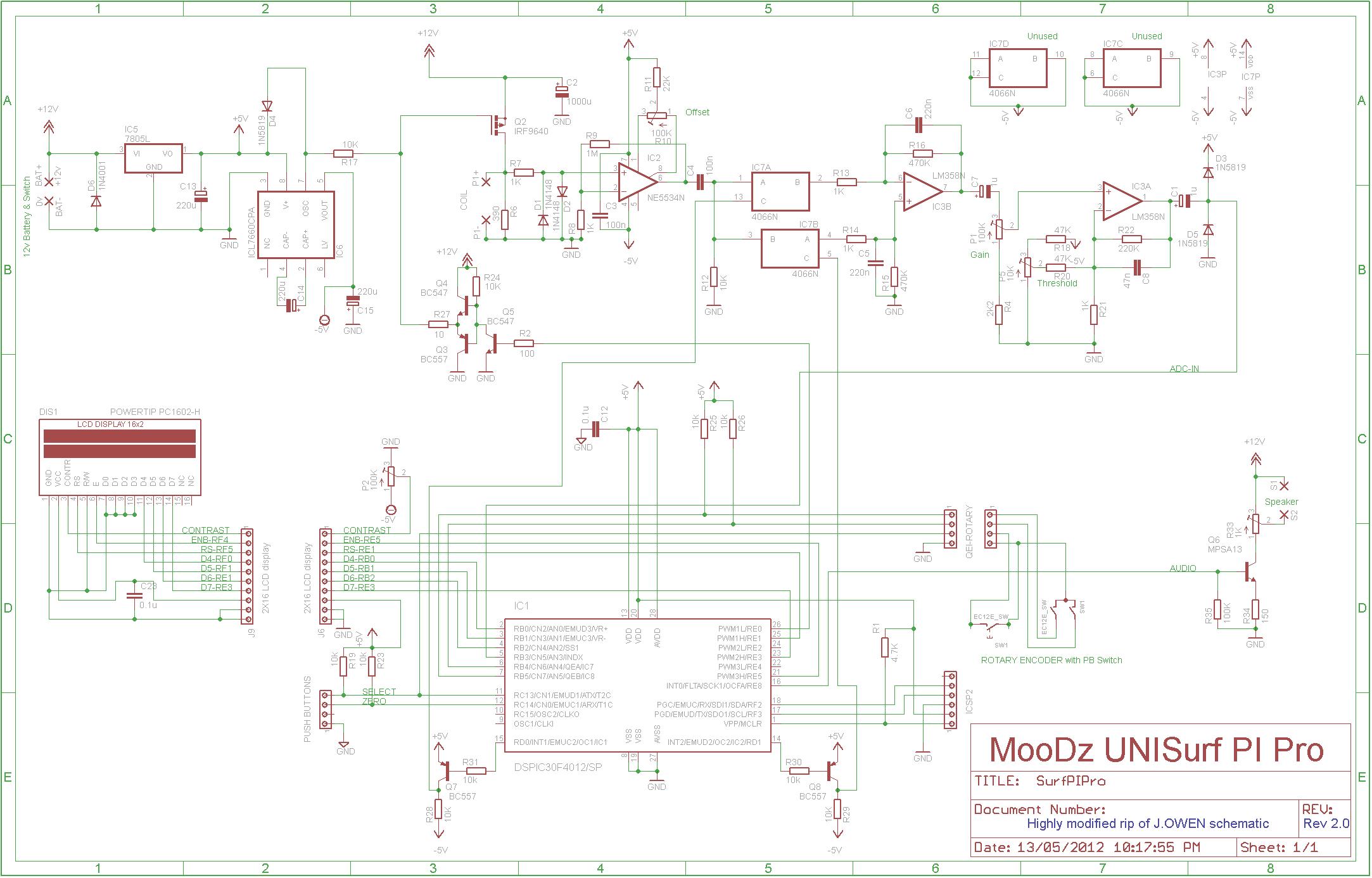

                        Ok ... I have added the icing .... Q1 is the damping control Mosfet and is controlled by a filtered PWM signal.
                        Moved the sound to a PWM pin ... so you can have nice tones or clicking ( have to add menu item ).
                        Added an SPI port to the ICSP port which is also a TTL level RS232 port (so its a three way port LOL ). Never know when we might add some handy SPI chip to the Surf Pro
                        Added the crystal oscillator ( which was an oversight )
                        moodz

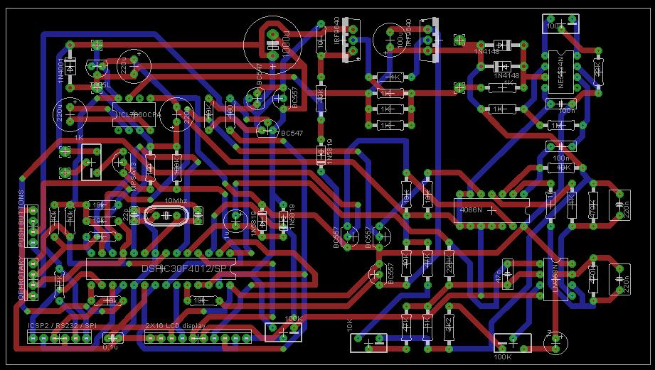

                        • ... and a board to match .... placed and routed but needs more work ..... watch this space.
                          moodz

                            Hi Moodz,
                            which software can i use to print different layers of that PCB image ?
                            Denis
                            • Hi Moodz
                              you have been busy, good work
                              I am but a mere mortal but R36 seems a bit high, is it really a 100k ?
                              cheers
                                Hi Moodz
                                cheers
                                R36 forms a low pass filter to control the gate voltage on the damping mosfet. We are using the mosfet as a variable resistor here not a pulse driver. Any noise on this will modulate the damping and cause false target noises.
