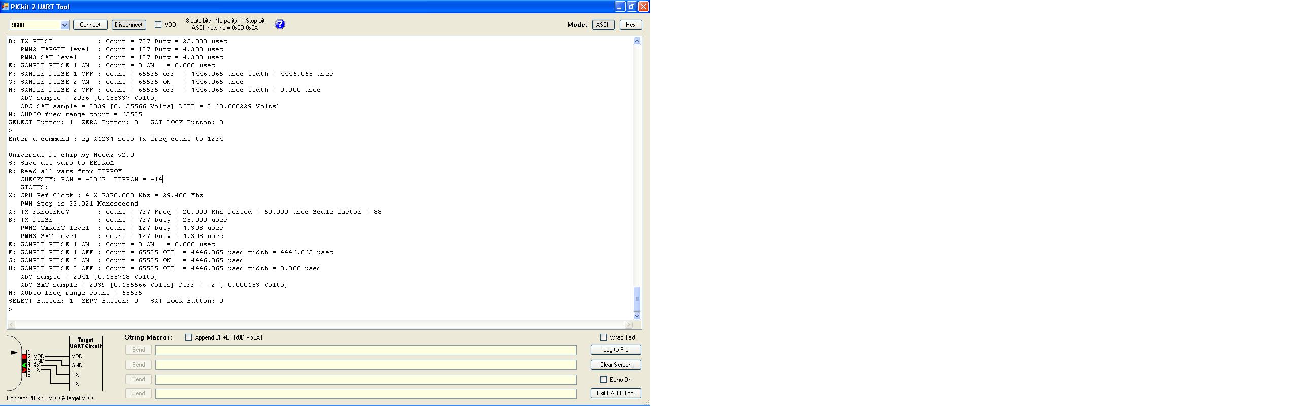

                v2.0 chip now operational
                Below is a serial console session from the v2.0 firmware in the uni PI chip. The top limit is now an insane 20 Khz but the software is still able to track and sample with sub 100 ns accuracy.
                The lower TX frequency is around 450 Hz and you can pretty much operate at any frequency you like between these two limits. ( within limits of 16 bit clock divider word )
                The top frequency would be over 100 Khz but I am limiting it to 20 Khz as it is possible to "brick" the chip for very high TX rates ( .. the curse of the never ending interrupt ).
                All of the code is written in C and I only dipped into assembler to do the EEPROM save routine which was for the low level access not speed.
                Frequency is set like this
                >A1234
                where A is the menu item ( see below ) and 1234 is the "count" in 33.9 ns steps. So A737 for example gives the top frequency of 20 Khz or 50 us tx + rx window.
                to set TX duty cycle you enter say
                >B737
                This sets a TX duty cycle of 25 us
                and so on for the sample1, sample2 and audio rate. The audio rate value sets the signal to frequency rate of the audio generator. A larger audio rate will generate a bigger audio freq change for a given signal.
                Lastly you enter
                >S to save the settings to onchip eeprom .. so once the timings suit your coil you can "burn" them so to speak.
                The code also supports a rotary encoder and I am only using 1% of the available eeprom so variable settings and multiple timings can be saved with a little more code effort.
                The TX, target and SAT signals are all available as complimentary PWM outputs however the sample pulses are only +ve going .... so I will look to add a menu item to set the sample pulse polarity for maximum versatility.
                moodz.
                >H550
                Universal PI chip by Moodz v2.0
                S: Save all vars to EEPROM
                R: Read all vars from EEPROM
                CHECKSUM: RAM = 3226 EEPROM = -12
                STATUS:
                X: CPU Ref Clock : 4 X 7370.000 Khz = 29.480 Mhz
                PWM Step is 33.921 Nanosecond
                A: TX FREQUENCY : Count = 737 Freq = 20.000 Khz Period = 50.000 usec Scale factor = 88
                B: TX PULSE : Count = 737 Duty = 25.000 usec
                PWM2 TARGET level : Count = 126 Duty = 4.274 usec
                PWM3 SAT level : Count = 126 Duty = 4.274 usec
                E: SAMPLE PULSE 1 ON : Count = 350 ON = 23.745 usec
                F: SAMPLE PULSE 1 OFF : Count = 360 OFF = 24.423 usec width = 0.678 usec
                G: SAMPLE PULSE 2 ON : Count = 500 ON = 33.921 usec
                H: SAMPLE PULSE 2 OFF : Count = 550 OFF = 37.313 usec width = 3.392 usec
                ADC sample = 2021
                ADC SAT sample = 2020 0.154116 Volts DIFF = -1 -0.000076 Volts
                M: AUDIO freq range count = 0
                Enter a command : eg A1234 sets Tx freq count to 1234

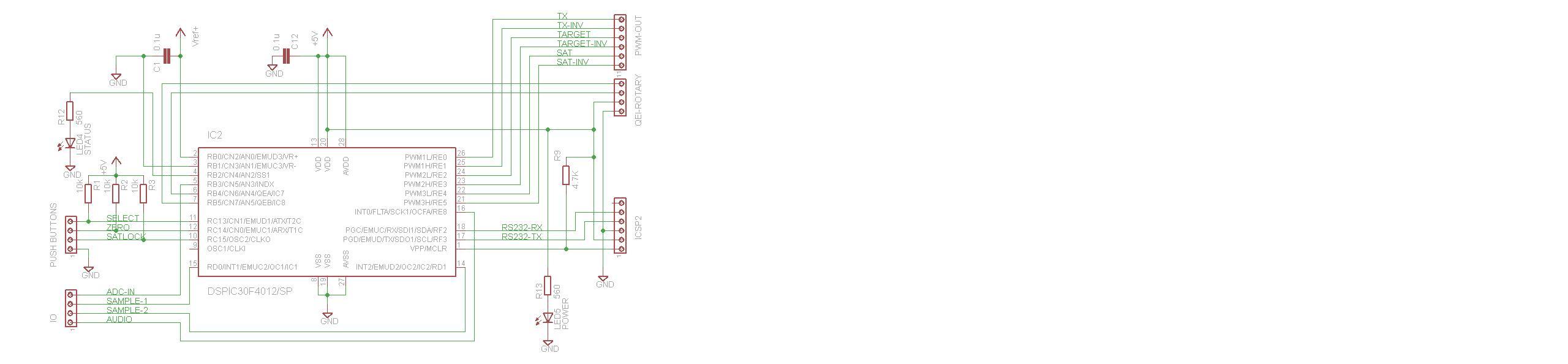

                  Below is the basic CPU circuit .... you need to add the rest to build a detector however IMHO the majority of the work in the signal processing has been done.
                  moodz.....
                    latest screen grab of serial console session for configuring UNIPI chip ....
                    moodz
