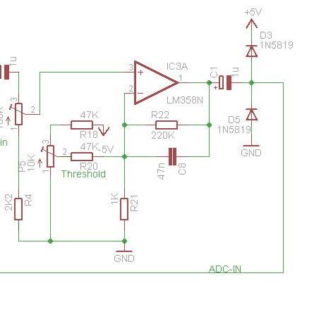

      I am going to use the V300 Unipi 4011 chip for the damping control from one of the pwm outputs. Sampling as usual from 2 sampling pins on there, but where does the (ADC in) from the modded surfpi audio out connect too.
      Do i use say one of the analogue input pins, say pin 2 on the 4012 connected to ADC IN in modded Surfpi REV3 schematic??

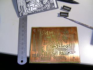

                Just finished etching the board. The picture below is the programmer i am building. Has been verified that it can program DIsPICS from the authors dedicated software which i have downloaded.
                6666, i will keep that in mind, thanks for the advise. If i get the Surfpi working with V23 Unipi, will post my findings here or may open a new thread. Then once hopefully verified working, i will look at a making a descent board layout for field use. I am going to try the differential front end and Tinkerers schema also in replace to the standard Surfpi front end.
                Summer is just around the corner. It will be great to get it working for the beach.
                The Pic on the right is the original author's programmer.
                On the left is my etched board so far.
                Sid.

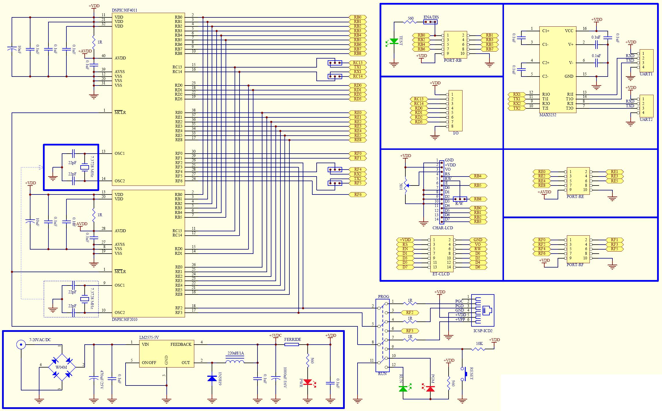

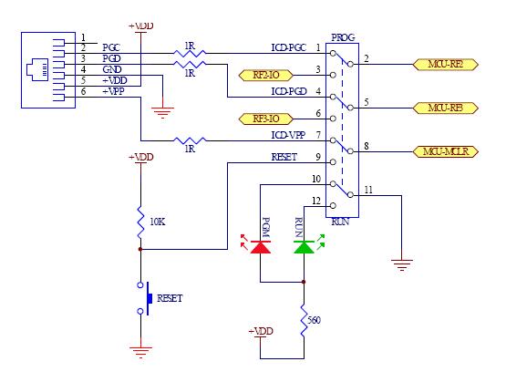

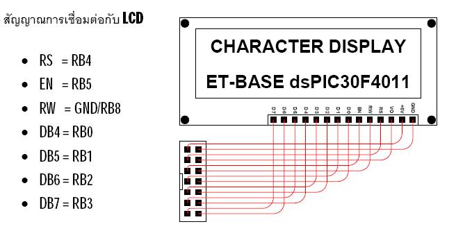

                        • Hi all, seeing that we need timings as the heart of any detector which happens to be Moodz great designed PI controllers here, I have stumbled across a ready made professional designed in/output connection DisPIC4011 circuit board, retailing for $27 Au, minus delivery from you guessed it, Asia and comes with a chip fitted.

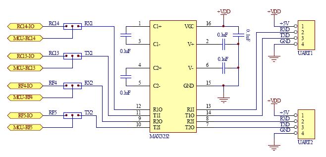

                          It has a onboard 5v power supply utilizing a LM2575-5v regulator and 2 UART ports built around a MAX3232 chip. Has a connector dedicated for the LCD Module (middle of the picture) etc etc
                          With slight modification (preferably software)....Moodz hint hint, this board can be adapted to the V300 PI controller as universal and would make a profesional working PI controller where V300 has 4 samples compared to the 4012 version with 2 samples.
                          After comparing your base circuit V300 to this circuit layout, there is not much difference to pin assignment other than the Lcd module which seams 1 or 2 pins have been allocated to different pins as to yours. Some software code change may solve it or may need a small mod to circuit board.
                          This board only works with Dispic4011 and 2011 variant as it has smaller ic socket buit in, between larger 4012 ic socket.
                          For that price i think its a great deal and hopefully the noise factor generated is minimal than a open breadboard design
                          So, would this be ideal as a PI controller using V300 software? what do you all think?
                          Sid

                          • Originally posted by sido View Post
                            Sid
                            [ATTACH]23213[/ATTACH]
                            If you post the circuit ... I will post the code.
                            • Hi Moodz, that will be great if you can work around the below circuit with V300 or better software you may want to include.
                              I mentioned it supports also the 2011 chip. Mistake on my part is supports the 2010 Dispic and 4011.
                              If its to much modding, please let us know. I only had a quick look comparison with the V300 circuit you posted in the past which i believe was the last update.
                              If you need more info, i can post the link to the Manufacturer. There is PDF with more details but mostly in a foreign language. If it can be done with no dramas on your behalf, it would make a high quality PCB designed with the best versatile PI controller software available. It will be just a matter of connecting the toggles and switches and mosfet switching circuits as per your circuit diagram.
                              Btw, use existing 10Mhz crystal as per your schema and disregard the 7.xxx crystal supplied with board.
                              Much appreciated Sid

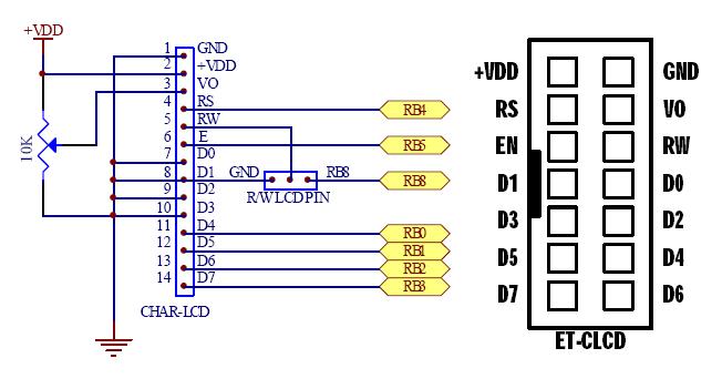

                              • This board has external manual contrast control. Thats part of the difference as i think the V300 is user adjustable via program? Keeping the Lcd contrast software control of V300 would be better with some hardware mod on this board to remove the pot and add some link.
                                Sid
