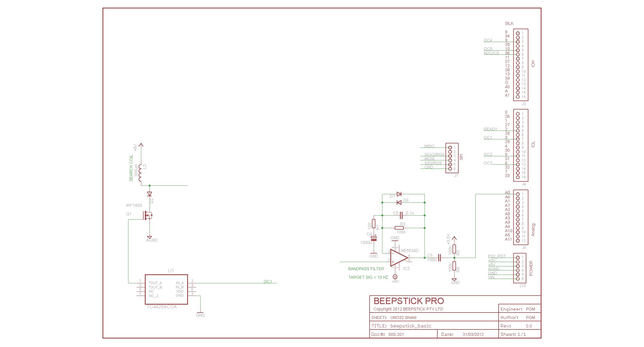

    • Guys I had a look at this board and they have mapped the quadrature enoder ports across the LCD control ...... wouldn't you rather have the PIC32 chip on the UNO32 board ???? It runs nearly 8 times faster, serial through the USB and brick wall target filter ... I posted the hex code a few posts ago.... here is the basic schematic ( only the UNO32 ports shown ) ... the band pass filter is shown for the input to the ADC .... its verrrrrry niiiiiiiice.
          [ATTACH]23220[/ATTACH]

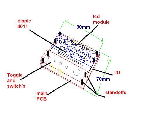

                • Something similar to this where the LCD module sits on top of Microcontroller PCB and just below LCD on standoffs is the switch mounted pcb. All raised with standoffs.
                  In this crappy drawing of mine the lcd should meet closer to the switch board as shown.
                  I will post later tonight something in reality similar to get an idea what to look like.
                  Rough dimension of the main PCB below is the length of the LCD Module x the width of LCD Module and switch PCB combined.

                  • OK, I think I get the picture (heh heh heh). Actually, a "sandwich" type of layout would work well. Do you need the switches on a separate board, or would having them on the same plane as the LCD be OK? Either is fine, although a separate board would be cheaper to get made. But if you're doing it yourself, I'd recommend a simpler, two-board layout.
                    So the whole thing has to fit within 70mm x 80mm, right? Are the standoff locations important, or just for illustration? And (almost) finally, do you want an ICSP function, or are you happy levering the chip out to reprogram it?
                    Assuming moodz gives us his blessing, the only thing I'll need from you is your preferences for any unique components like headers and switches. I use some pretty standard switch footprints - those little coloured round-topped el cheapo wibbly-wobbly switches (http://jaycar.com.au/productView.asp...SUBCATID=978#1), or some really fine C&K square jobs (blue bodies, white dimpled square keytops, sorry, I don't have the part number at my fingertips right now...). I have a bag of them I bought years ago, I can shoot you a handful if that'd help. Or I can design a new footprint, and I sure don't mind doing that!
                    If you're happy with 200mil screw-in battery connectors (green, orange, or blue connectors like they use in burglar alarms and so on), that kind of more-or-less standard stuff, then that'll be quicker, but again, if you have a particular preference and can point me to a footprint, I'm always happy to improve my library!
                    Sorry if this is complicating things. I don't want an unhappy client!

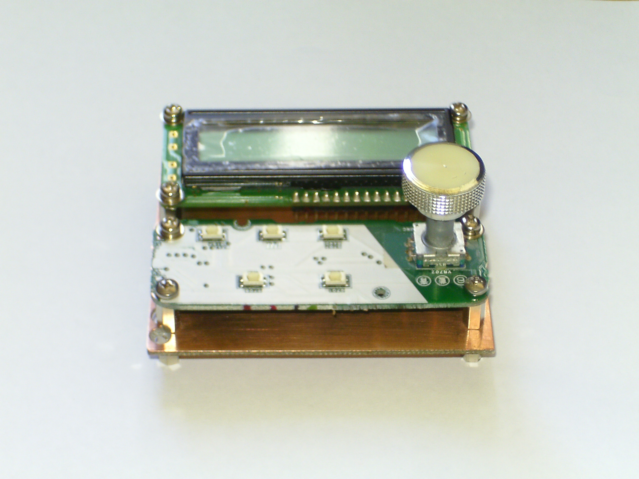

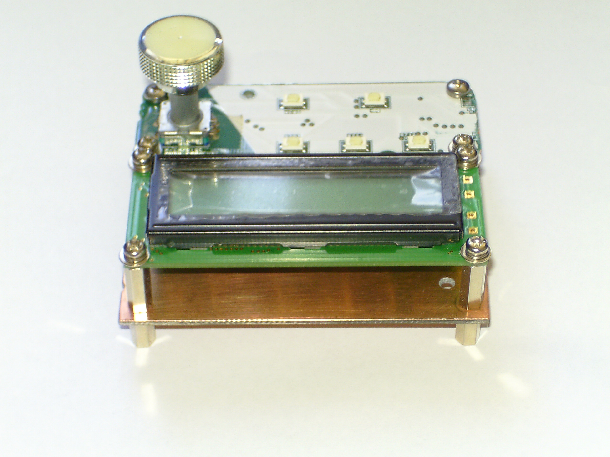

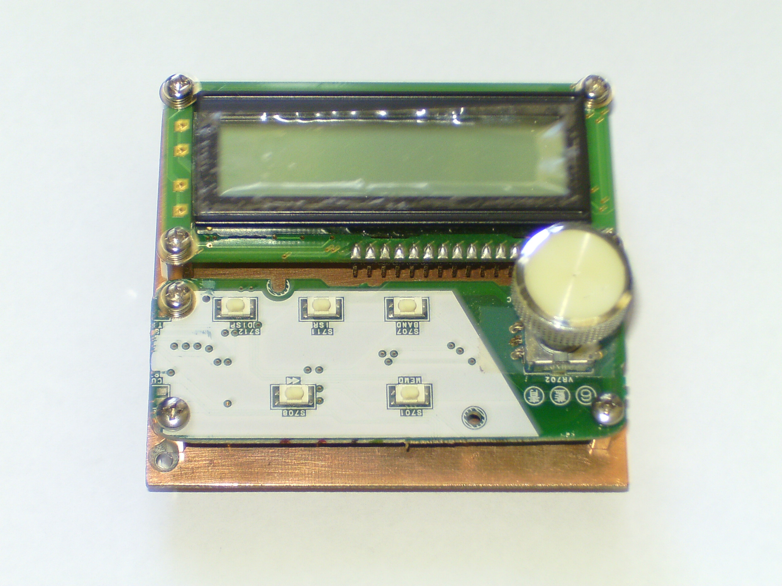

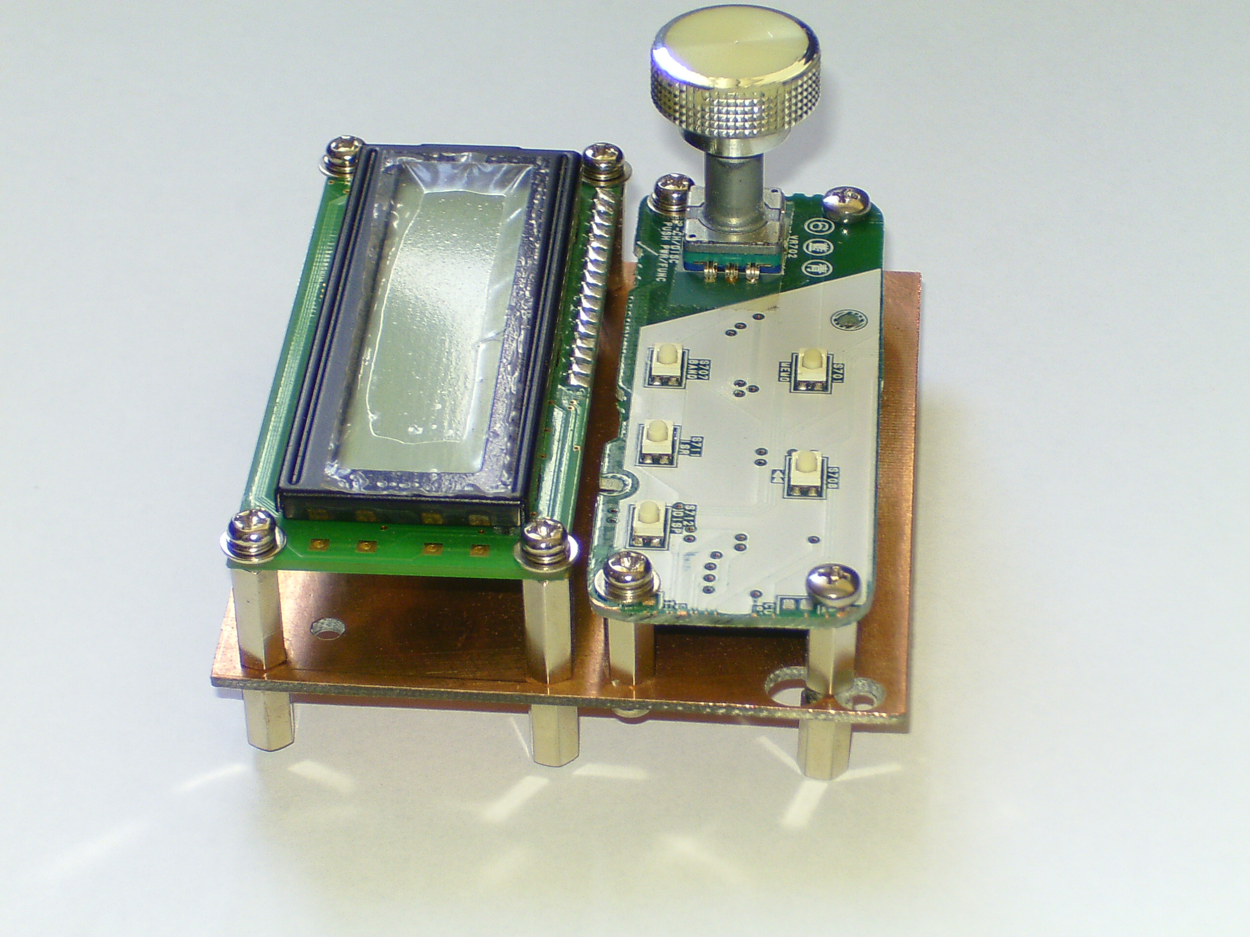

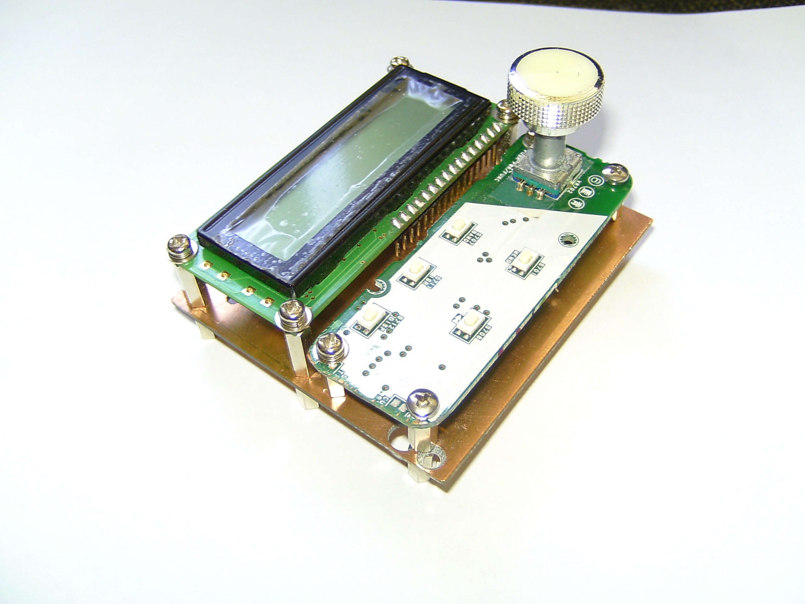

                      • Hi Pete, i made up this basic board layout.
                        The toggle switch and press switches is from a disected Clarion for illistration purposes. Seperate board on its own.
                        LCD Module can easily be removed and the switch PCB to reveal beneath on the main PCB the Microcontroller and Mosfet switching.
                        Just got to work out what connectors to use for Plug in LCD Module and Switch PCB interface connector to main PCB and where to place I/O pins for convenience to be able to connect to sub Modules off this design.
                        I will keep brainstorming and add more info with everyday actual parts.
                        Cheers Sid

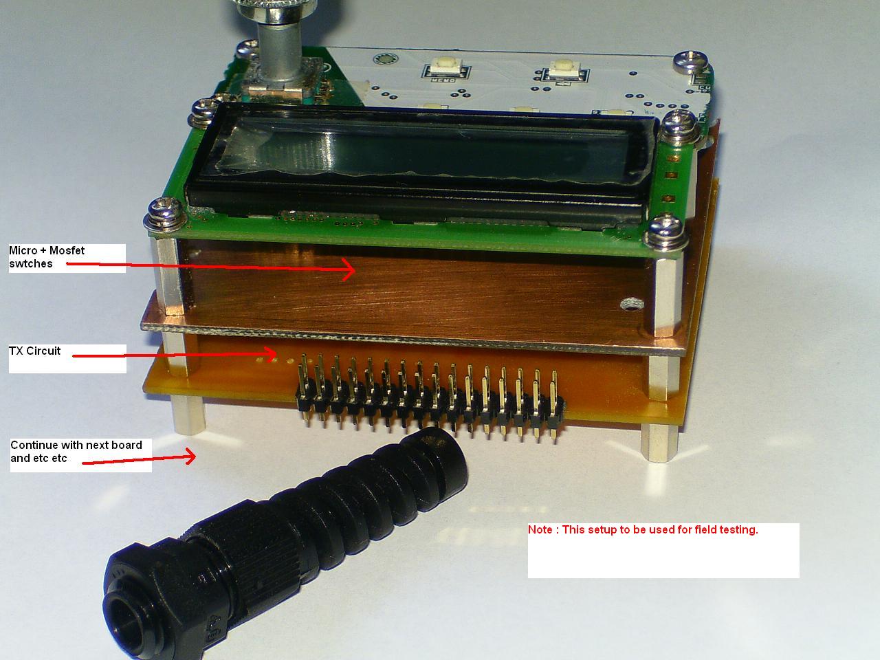

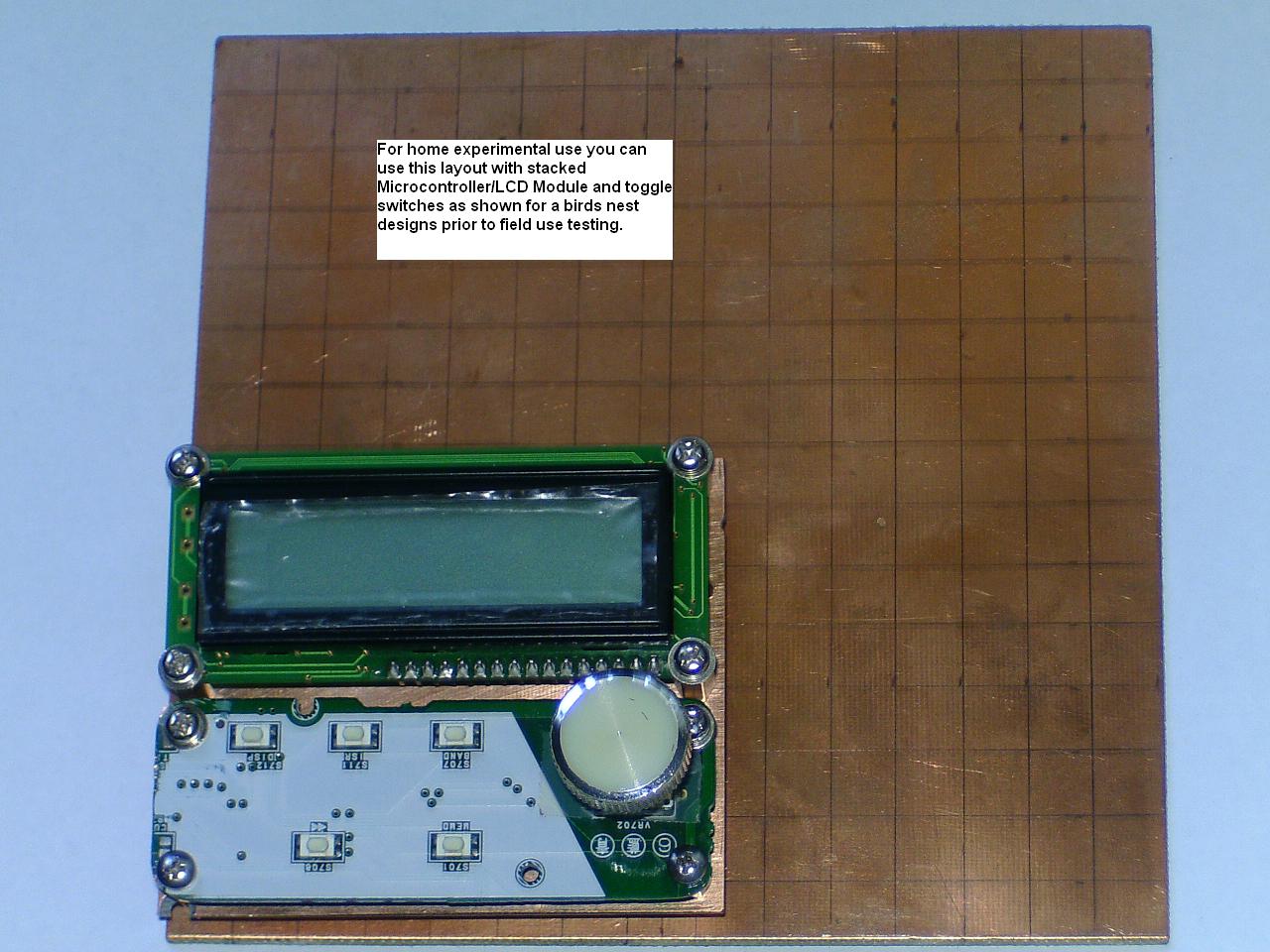

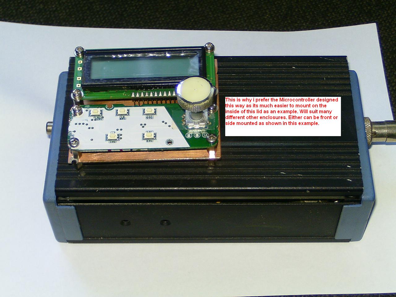

                          • Hi Moodz, thanks. Is that a YESto pursue the design of your MCU Controller on a generic PCB layout on open Forum??
                            Well, a little bit more information added below.
                            The reason why we should follow this path is shown below in Pictures.
                            What do you all think?? Any suggestions?? At this stage its only MCU PCB, Switch PCB and LCD Module.
                            Cheers Sid

                              YES
