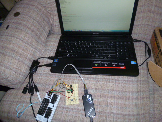

    After a lot of messing around I have finally got a verify complete on moodz hex file on a 4012
    The pickit3 is plugged into a direct usb port and I had to breadboard an adaptor for the 4012 as the icsp board does not come with a 28 pin zif socket for a 4012. I have ordered a nice 28 pin adaptor off fleabay.
    Now to see if any pulses are coming out of the chip.

      Thats the most comfortable workbench I have seen for a while ... you may have a problem seeing pulses as you have no LCD display or rotary to set the TX period which I think is set to 0 after you program the chip. The last hex file published needs the 10 Mhz crystal also. There is a serial port however it works only with the pickit2 UART tool .... the pickit3 does not have this feature as far as i know. I suppose I could publish a hex file with "default" Tx and sample pulses set so you can test ... I will look into it tonight.
      moodz.

        well I connected only pins 13,20,28 and 8,19,27 and 1 and 10,11,12 and 6,7
        but no pulses,
        I used the first hex code no xtal just to get it going
        but i see you say it needs the lcd and rotary switch to set the tx pulse and samples from zero.
        I was just about to ask if the code has default values but you read my mind
        if its possible to have a default code that would be very handy thanks
        I used the hex code from post 20
        and remembered this
        "ALSO NOTE ... you must wire the ZERO button though .... the code expects you to press this once to commence operation after first power up .... if people dont like this I will remove this "feature"
        just dabbed an earth on pin 12 (the zero button) but no pulses, guess its set to zero in code

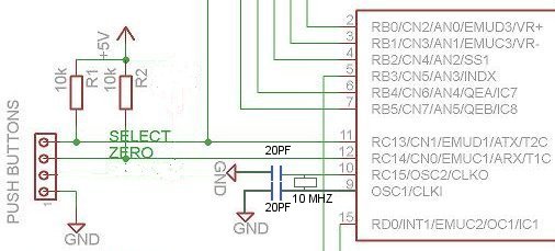

            Thanks for the update
            I went back over the other thread and realised I missed this about the 4012 'DOH"
            "I have added a 10 Mhz crystal to both the 4011 and the 4012 "
            my LCD has arrived but no switches.
            10mhz xtal like this ?
            • #66
              you got it ... the chip is running a little beyond spec at this speed and power consumption is up but you do get nice timing steps of 25 nanoseconds and faster processing.

                              Have you got the 22pf ceramic caps installed on the crystal pin9 to gnd and pin10 to gnd.
                              Mick
