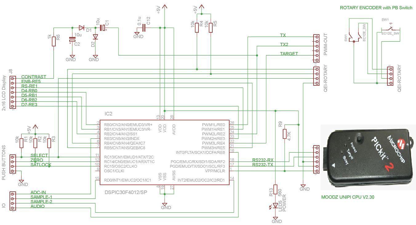

    Andrew is this what you are looking for ?
    and I think you have to use the pickit2 software to use UART function
    Found it
    If you are only burning the hex files and want to use the inbuilt UART tool ( serial comms ) to talk to the UNIP chip ( saves wiring up an LCD ) get the pickit software here ....
    http://ww1.microchip.com/downloads/e...0Setup%20A.zip

            Finally some success in REPROGRAMMING these 4012's
            • #96

                Hi 6666, I haven't got that far yet but I do remember some info in another thread. I would be guessing 2.5 volts as 0 because from memory the display shows +/-2.5
                The analogue IN can accept a voltage from 0 to 5 volts and is approximately 17 bit accurate ( yes 17 real bits ..... ) The analogue input expects to see a signal that consists of a relatively stable base voltage that varies as targets are passed over ... so it is a motion detector.
                A differential front-end PI design originated by Moodz and open for community development.

                    The "No target" voltage to the ADC input can be anywhwere from 0 to 5 volts ... however somewhere between 1 and 4 volts gives you some headroom for the signal to move up or down ( if descrim is required then the voltage might move up for ferrous and down for non ferrous ).
                    The input voltage to the ADC must already have been filtered and ground balanced.
                    moodz

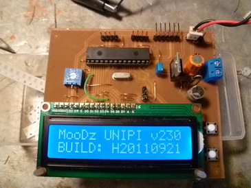

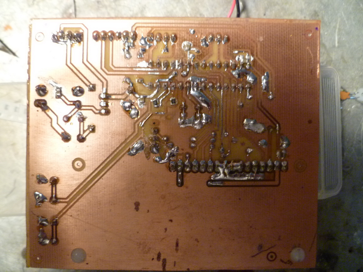

                    • moodz on a pcb
                      hello,
                      here's a few pictures of my project so far...
                      i used a pickit 3 to program the devices. in programing the chips, i found that becuse the
                      code protect bit is set, the Verify function will display an error!!!!
                      example:
                      Address: 00000000 Expected Value: 00040100 Received Value: 00000000
                      Verify failed
                      The fact that the Received Value has changed from the eprom blank state indicated
                      the chip is programed!
                      Also, another important fact!
                      i was able to program the chip on the power supply by the pickit 3,
                      HOWEVER for the cicuirt to operate, IT MUST HAVE A GOOD 5 VOLT SOURCE.
                      Philip

                            • 6666
                              I'm thinking he's trying to get everything possible from the dspic's so I'm going to add a resistor to the ground of the 7805 just to get the added .2 volts, easy fix.
                              next item to build is a front end, going to make a board for that too.
                              philip
