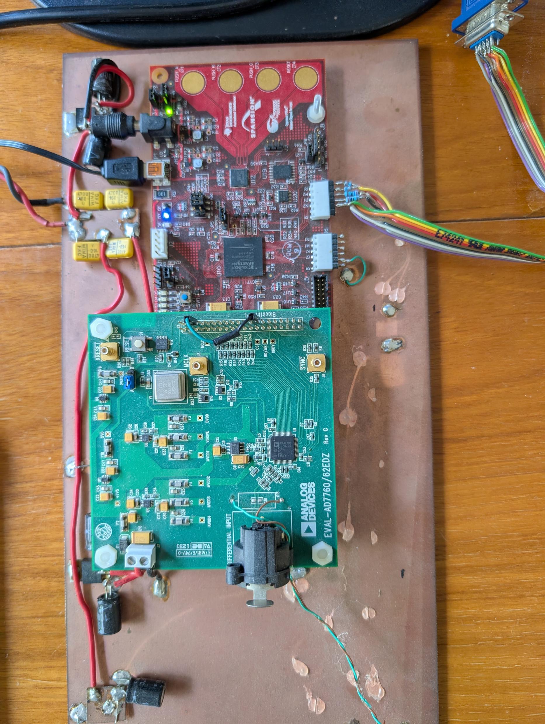

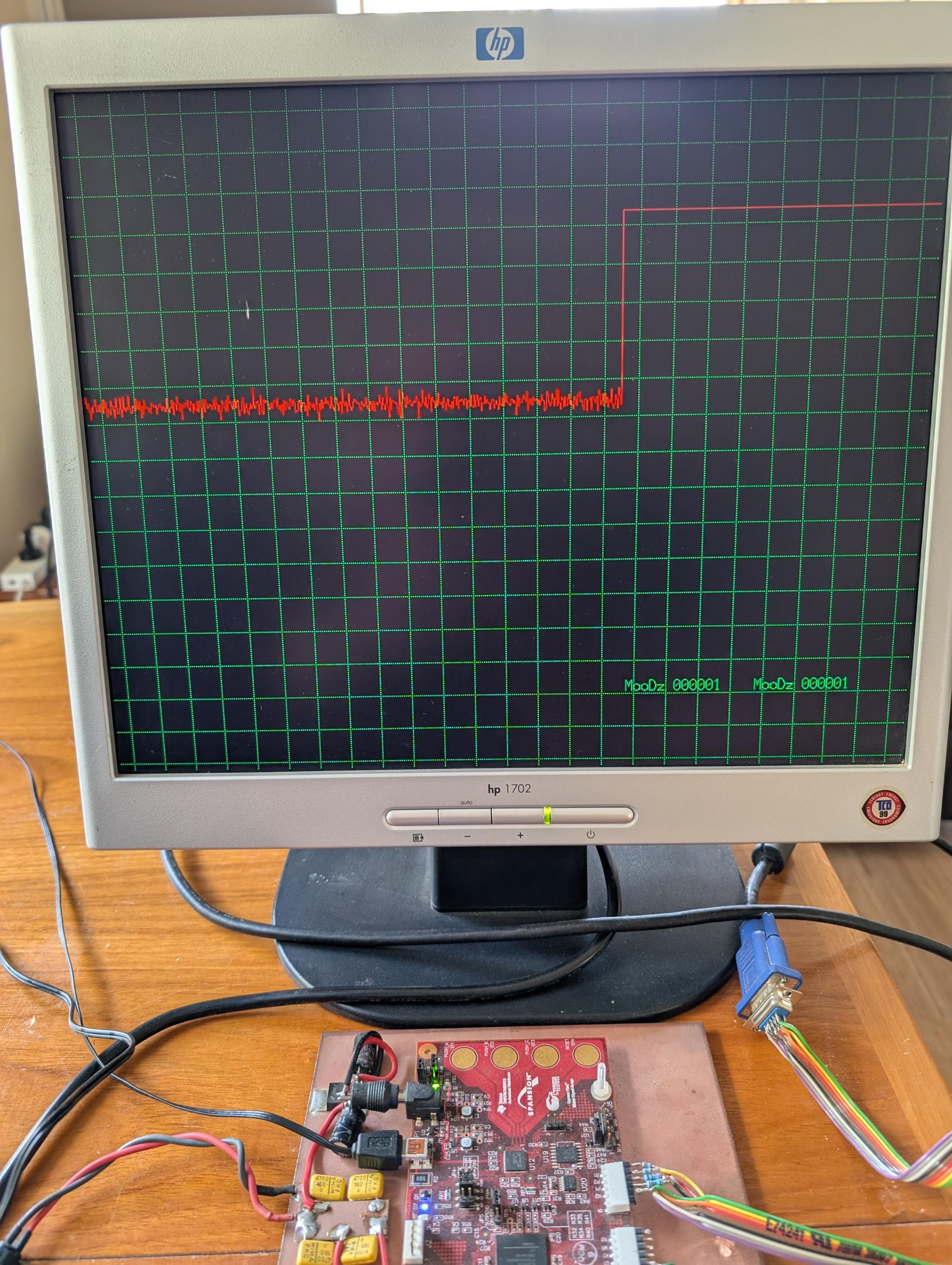

                ...this project has been sitting on my todo list for over 10 years now. So I got out the development board and blew the dust off .. loaded up the Xilinx webpack software ... downloaded my archive .. tweaked some code and voila : UNIPI lives.
                The ADC is a 24 bit AD7760 sampling at 1.25 MSPS over a 512 sample window that implents a running sum of each sample 1024 times into a dual port RAM for a 5 bit resolution improvement ...
                The AD7760 is syncronously driven by a XILINX Spartan 3A FPGA.
                The FPGA also is programmed to provide an embedded simple oscilloscope via a few resistors to produce a useful display on a VGA monitor. This lets us see what we are sampling as we cant use a real CRO in the digital domain LOL.
                Taking some of the learnings from the MAGPI and CCPI circuits I will kick the can down the road and see where it leads.
                moodz

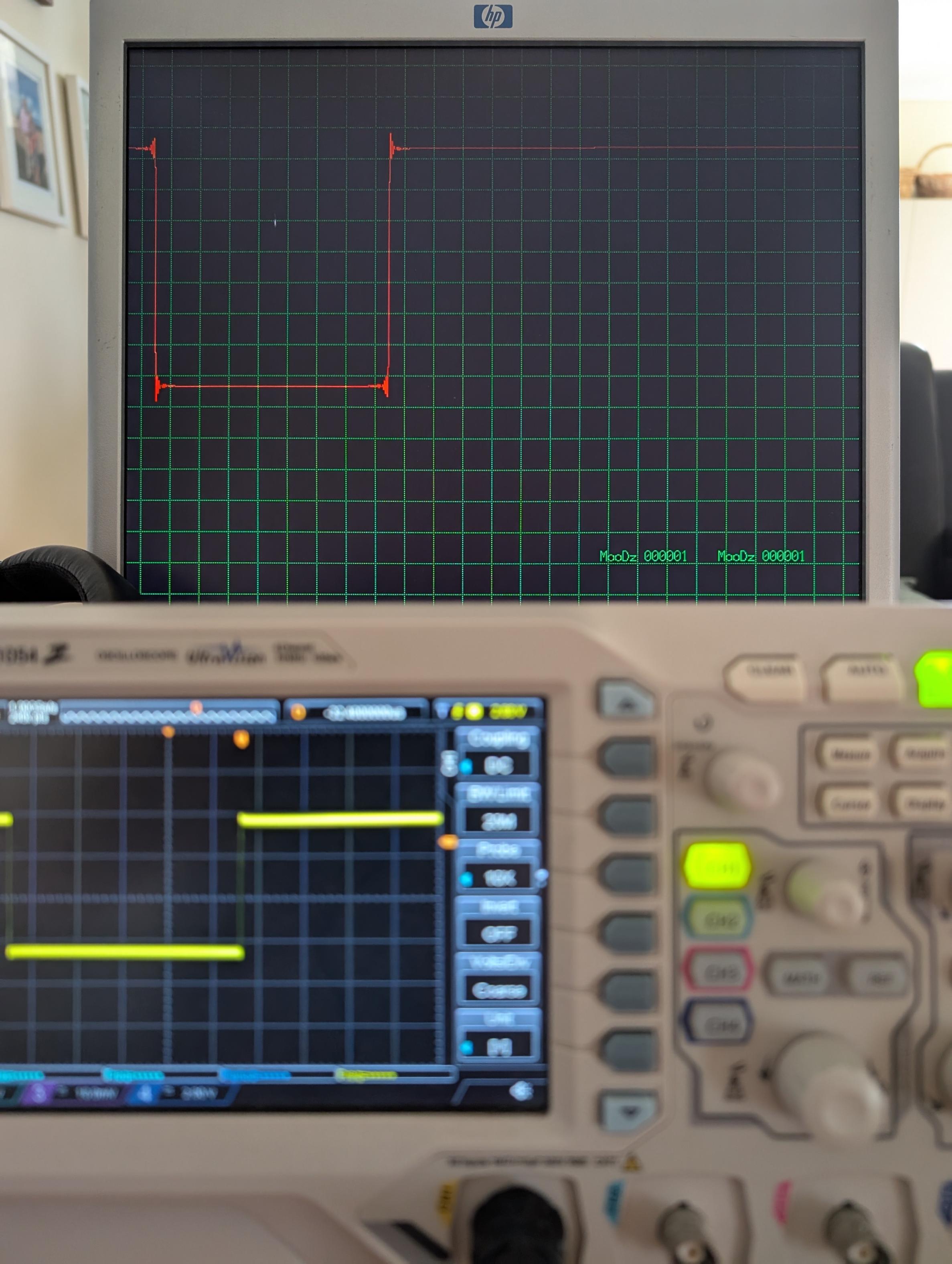

                  Sample rate now set to 24 bits @ 2.5 MSPS ... 400 nanoseconds per sample.
                  Importantly have now synchronised the TX to the RX. The demod filter is set to 4.78 Hz but the input bandwidth is 1.25 Mhz. ( 2.5 Mhz for synchronous signals )
                  Below is the UNIPI sampling its own TX pulse signal compared to the CRO ... interestingly the UNIPI picks up ringing on the transitions which the CRO cant see ( only an 8 bit ADC on the CRO ).
                  Next step is to add the TX front end and coil.
                  moodz

                      Hi Moodz,
                      I have the same AD7760 Eval board as you, but I could not get true 24bit at 2.5Msps out of it. The least significant nibble would only ever produce the numbers 0,1,8 and 9. Running at 1.25Msps it would give true 24bit. I did check the data on the AD7760 parallel interface with a high speed Logic analyzer but it showed the same missing bits.
                      I would be interested to see if your AD7760 does the same.
                      Jeff
                        Those look like Fourier artifacts. I suspect they are not real.

                            Originally posted by PICON View Post
                            Hi Moodz,
                            Jeff
                            You could be right ... I have not dragged a logic probe across it but the spec sheet says it has 100db SNR at 2.5 MSPS ... which equates to just over 16 bits ? of real resolution at that sample speed so the lower 8 bits could well be noise bits>.
                            If I get a chance I will tweak the VHDL to look into this issue.
                            Also from what I understand to achieve best performance at 2.5 MSPS the low power mode must not be set.
                              The internal sampler in the AD77760 is a 40 MSPS analogue modulator followed by a digital filter section ... the ringing could be coming from the filter.
                              The ring waveform is static though .. it does not move around . ( which is good ).
