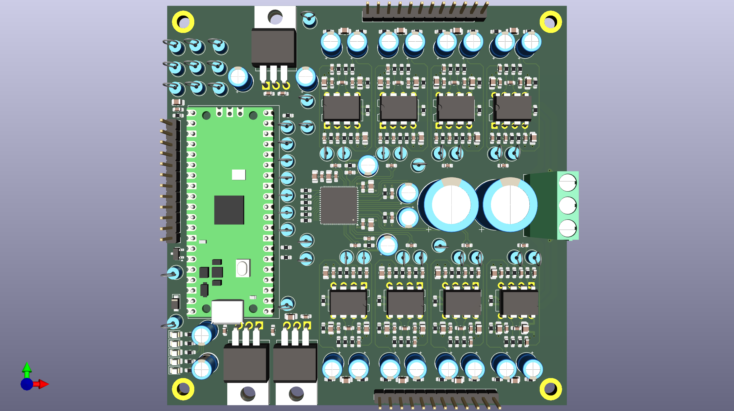

    Progress on the AKM board. Not fully routed yet, but you get the idea.
    I've used the Raspberry Pi Pico 2 as the controller and this also provides pulses and timing for my TX board.
    The board is 100mm x 100mm and as you can see most of it is taken up by the 8 analogue input channels.
    Once I evaluate it and see whether there really is a 9dB improvement in the noise floor when using all 8 in parallel, I may use the 2 or 4 channel device which is a bit cheaper and will reduce my real estate accordingly. It's all a trade-off; More space and cost for better noise specs.

                    • Some feedback on the AK5578 ADC:-
                      The internal 1Hz high-pass filter to remove DC offset doesn't work at 384kHz and 768kHz sample rates, so untill I write a digital HPF I've kept my initial testing to using a sample rate of 192kHz which is just fine with the 19.6kHz TX frequency I'm using.
                      The ADC is susceptible to overvoltage conditions on its inputs and draws a lot more power when the input is overrange (i.e. > 5V)
                      This is fine if you stick to the example amplifier design which actually attenuates, but if you use any gain at all in the front-end then you need to ensure that at startup there is no overshoot when the input coupling capacitors charge up. I think the example front-end given in the datasheet can be much improved,
                      Having said all that, I've got it working quite well at 192kHz sample rate and by dropping the op-amp supply voltages down to +/- 6.5 volts. (I've got a gain of 10 on my inputs)
                      Using only one channel of the ADC (I haven't tried 8:1 mode for noise reduction yet) and employing narrowband (sin/cos) demodulation, I'm able to resolve the input signal down to around 200nV at the RX coil output. What this means in terms of detection distance is that I can detect a 1 Pound UK coin at around 15 inches and small silver 3p coin at around 12 inches. (RX coil amplitude change of around 2uV).
                      The nature of my coil is sub-optimal as one of the RX lines grounded so I'm not getting a full differential input and the nulling seems very strange as there's very little phase change with a number of different target types. (It's a cheap Ali-Express model).
                      Tests are ongoing, but I think there are enough positives so far to pursue this further. Will let you know more when I've improved the front-end and written some extra filters for 768kHz testing. Will also try out a different coil.
