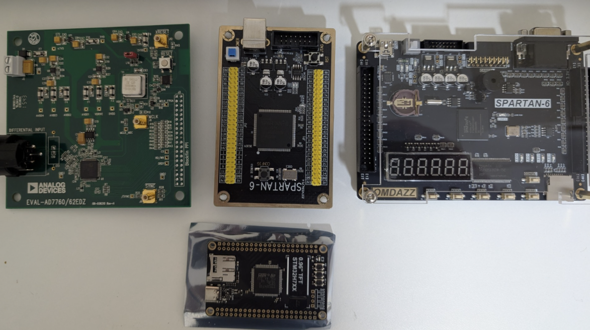

            • The Chinese boards arrived and the AD7760 board will be plug and play on the two FPGA boards .. no wiring yay ! ... I only have to remap the pins in the VHDL source code.
              There are two FPGA boards for testing.
              The first has Spartan 6 FPGA and VGA video , external RAM, pushbuttons, LEDs, Beeper, SD card slot, Camera interface, RTC, USB etc etc. Cost = $60 AUD.
              The second just has the Spartan 6 FPGA and USB interface. Cost = $20 AUD.
              For fun I also bought a STM32750 core board that has on board 3 x 16 bit ADCs at 3.6 MSPS. Cost = $ 19 AUD.

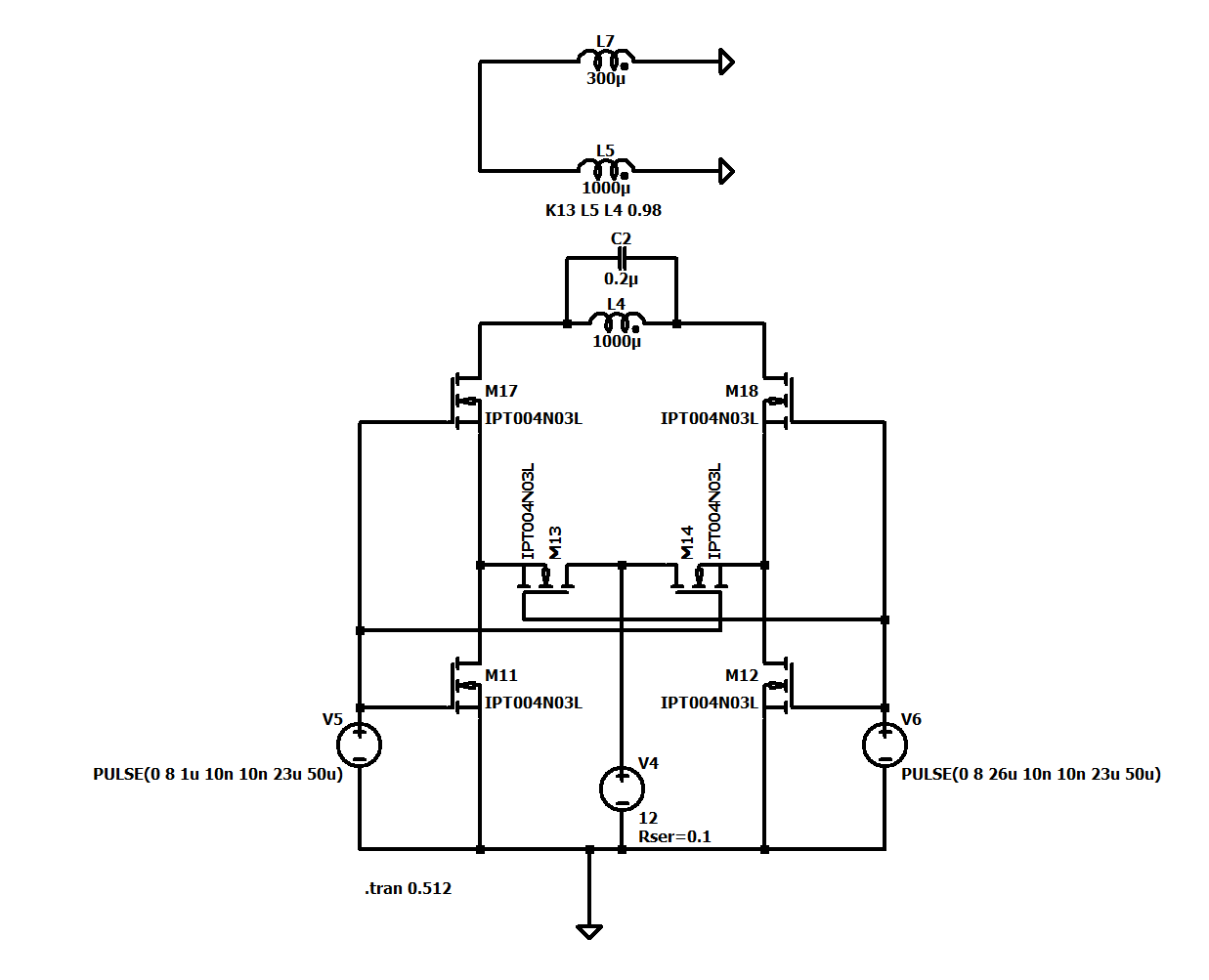

              • I, after all, can't understand how the ccpi will work in vlf mode with the addition of only one capacitor. Or do you need a mandatory addition of a coordinating transformer?
                • Originally posted by JoyJo View Post
                  Can you explain what you mean by "coordinating transformer" ? I do use a transformer in the output so I can isolate the single ended coils ( ie grounded ) of a DD coil.
                  Obviously you cant just connect a CCPI cct to a grounded coil unless you float / isolate the power supply.
                  • On your previous circuits, a disconnecting transformer was used to connect the TX coil. It was also mentioned that the transition from PI mode to VLF can be made only with one toggle switch. I understand that the TX coil with one of the leads is grounded cannot be used with the CCPI. But I haven't figured out how to get the VLF mode yet.
                    • Its fairly easy ... see diagram below. Also note there is another important aspect of this circuit.
                      The transmit waveform is substantially unaffected by variation of the DC power supply ( ie constant AC output ).
                      This means you dont need a regulator for the DC supply ie run off battery direct. ( The TX current waveform will not change from say 12 volts to 8 volts at the battery )
                      I patented that idea also. The circuit is shown set up for VLF transmission of 20 Khz.
                      It draws 150 mA average from the DC supply for 2.6 Amps peak to peak in the Tx coil L7. L5 and L4 are the transformer. C2 is obvioously the cap.( selected on base TX frequency ).
                      The transformer isolation also prevents any small DC biases that might occur in your typical Halfbridge due to component differences .... this bias will cause an error in the RX due to offset modulation.
                      moodz.

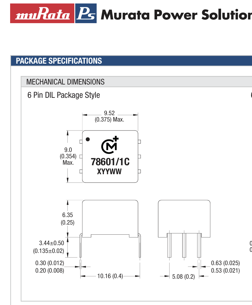

                      • Now I understand. Thank you. But the introduction of an additional transformer significantly increases the size of the product.
                          That's quite a spec and price. Do you have a link?
                          • In hindsight I advise to get the STM32H743 though .... its got way more flash memory for program storage. ( the 743 fits on the same PCB ) ... its a few dollars more.
                              The real question you need to ask yourself then is are you designing a metal detector or a hearing aid ?:rotfl
                                But seriously .... its not a mains transformer ... its a high frequency transformer similiar to this ....
                                about 1cm x 1 cm x 0.6 cm. You are joking that it is going to increase the size ?
