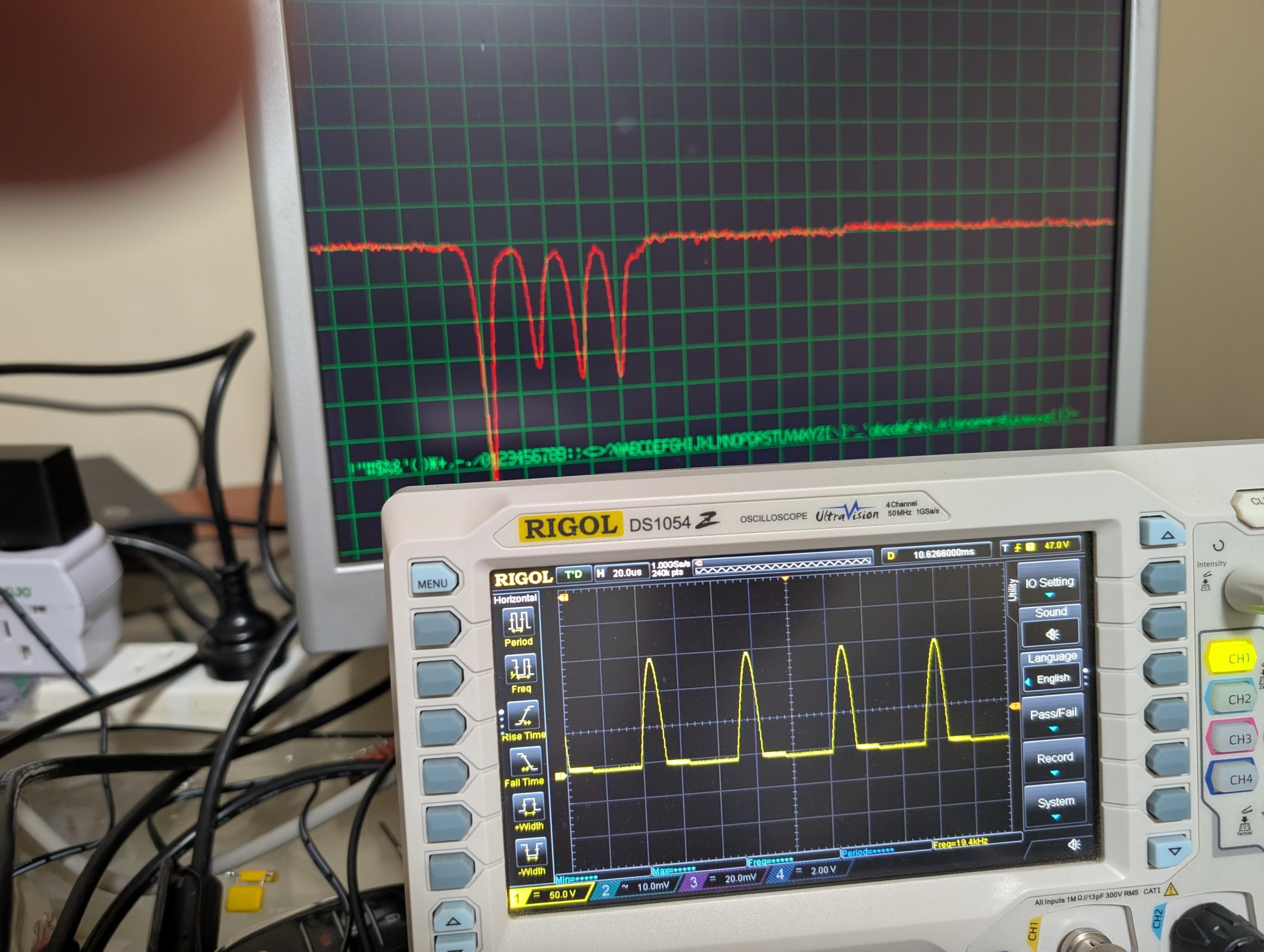

                              To compare waveforms ... I changed the transmit code so we get half sine pulses. Seem to get a much stronger ( but monopolar ) signal as the signal to noise is about double the single frequency mode.
                              The method I used to cancel ferrite also works on half sine ( I was a bit surprised ).
                              Below is pic of TX waveform on CRO and target response on red trace VGA from the FPGA. ( there is no ferrite trace because its cancelled )
                              I think its time to build up a field unit for testing outside.
                              moodz

                                Looking good Moodz! getting very interesting now….
