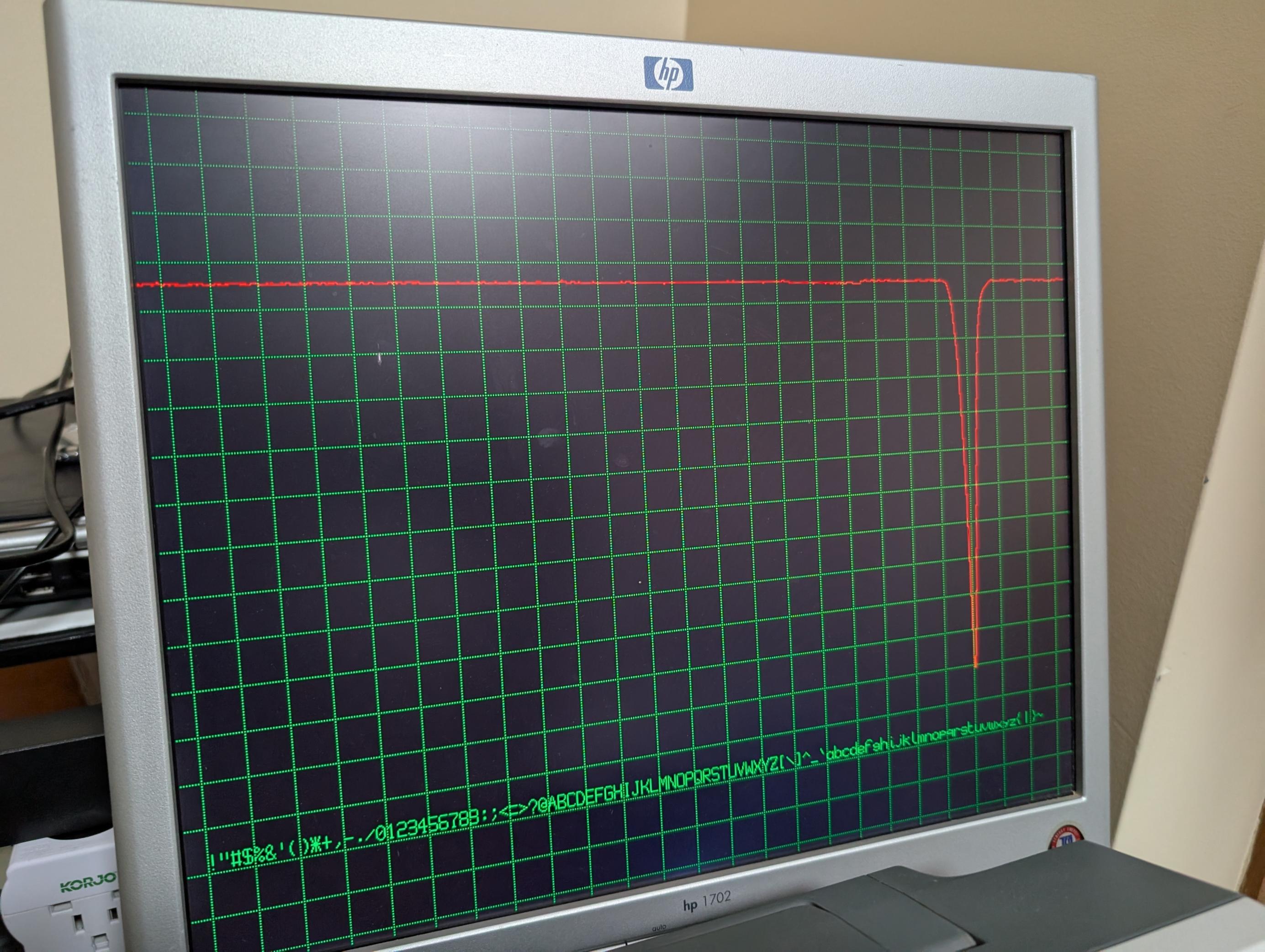

      .... yep the ripple in the integrator output was solar inverter magnetics ...
      Flat as a pancake now.Click image for larger version

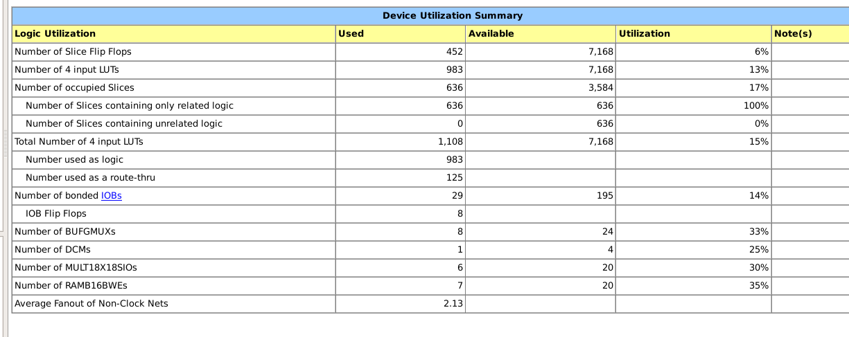

            Thanks mate ! I am aware that the hardware ( fpga chip and ADC ) are close to obsolete ... though you can still get them. I need to consider moving the code to an updated platform ( ie current FPGA and ADC ) before going to far.
            We do need at least 24 bits of resolution ( not sure if it has to be 2.5 MSPS )... by the time I get the processing to the end of the chain I am using a 36 bit word in the integrator and the integrator values on the VGA display are bits 0 to 9 ( ie the lowest 9 bits ) of the 36 bit word so the noise is very low. I think I am using a novel algorithm in the VHDL which should be fully portable to new FPGA chips or even CPU and you cant patent VHDL code AFAIK.
            Currently the chip is a XILINX Spartan 3A and the utilisation is low ... theres enough room there for a soft processor on chip.
            Below are the compile results for the FPGA...
