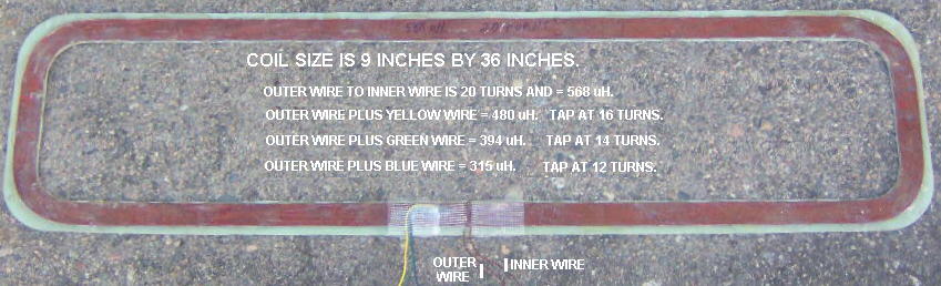

                Dennis, I did make one large Rectangular Coil, Outside dimensions measuring 9" X 36".
                It had 20 turns 18AWG wire with a measured inductance of 566 uH.
                It was Flat Wound simular to the way I make my Radial Coils.
                DC Resistance is about 0.7 Ohms
                But I was Not pleased with the results at all.
                Possibly I should have reduced the turns for a Lower Inductance and tried it again.
                Take care..........Gary
                  Here is a Picture of that coil I made.I Just added Taps to the coil to try different numbers of turns and Inductance values.
                  I will test it out in a few days.
                  I Previously did this experiment with one of my flat Round coils. It worked quite well to determine Optimum turns and inductance for a particular coil size.
                  And since the Unused turns don't connect to anything they don't appear to interfer with the final test results. At least Not on a PI Detector
                  Gary
                    Doing a Quick test with this coil suspended 3 feet from my basement ceiling and connected to my pulse-1 detector, here are some results.
                    Both the 315uH and the 394uH taps gave the Best and roughly Equil results.
                    A Canadian Quarter (Made of Nickel Metal) at only 5 Inches.
                    A 5 inch by 6 inch aluminum square at 16 Inches.
                    A 24 Inch by 24 Inch piece of Raw PCB material at 50 Inches.
                    A Rectangular 4 liter Steel Can (Area parallel to coil was 6 Inches by 10 Inches) and the detection Distance was 26 Inches.
                    Still not really impressed.......Gary

                      What is the "width" of the windings, that is, the distance from the outer winding to the inner winding of your flat rectangular coil? Presumably, 9" X 36" refers to the "outer" dimensions.
                      Is there any spacing between the windings or are they adjacent, with the thickness of the enamel separating them?
                      Are you able to say anything about resonant frequency and inferred capacitance at this point?
                        Not quite sure what you mean by "Presumably".
                        "It is those dimensions".
                        The typical Coil width is .875 inches. I Tried to wind each turn Tight together, but there are small gaps in some places.
                        Free Air Resonance between the inner-most lead to the outer lead (568 uH winding) is 902 Khz. That represents an internal Capacitance of 54.8 Pf.
                        The Backing Plate for this coil is a piece of .030 inch, Glass Epoxy PCB Material with the Copper Removed.
                        Gary
