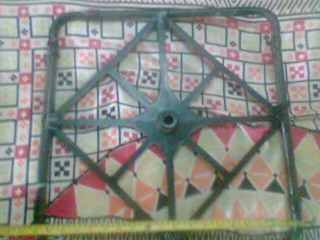

        To Clarify it:
        I Always State "Actual OUTSIDE Dimensions of the Actual Wire Coil".
        Not the Frame that holds the Coil.
        Manufacturers usually give the CASE Dimensions, Not the Actual Coil.
        Definately Somewhat Misleading, I Agree.
        Since the Width of the winding is about .875 of an inch, The Inside Dimensions of that 9 X 36 Inch coil are about 7.25 X 34.25 inches.

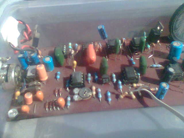

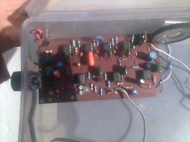

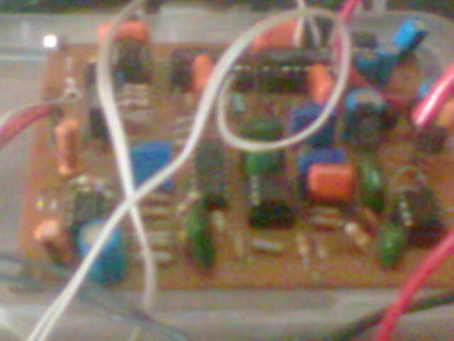

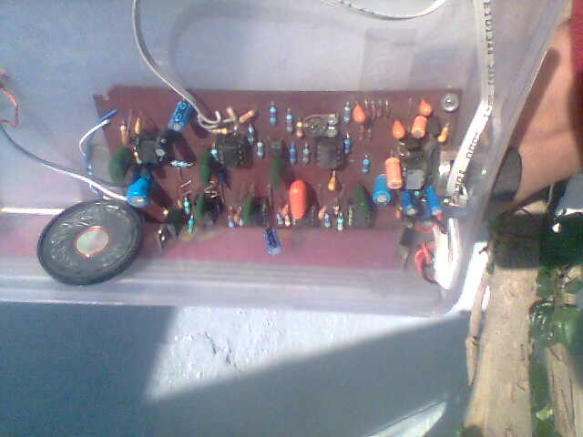

                        hi gary many thank's to reply actually i need detect a bear can size metal. so i made 13.5/13.5 squar coil 300uh for hemmarhead that's working fine . rajesh
                        • #42
                          t/r
                          hi gary i built your matel detector -1 this working at least fine. i wish to made a new trance/recieve designe for gold metal locator i need to knowan frequency relatede with gold. can you recmonde me some expalaintation. i have more time free........rajesh
