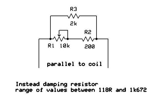

Wow I really think you helped me solve the problem. I can't believe I had a wrong value resistor! such a big facepalm...
Now I need to shield the coil, since I unshielded it when I added more turns, (which now I think It wasn't necessary but I won't mod it anymore, I will just shield it as it is. ) I didn't want to shield it jet because I'm going to shield it with copper tape and I didn't want to buy it if I didn't get some good results first.
Also I need to know how to adjust the delay (both the minimum delay and the 10k pot) and what is its function exactly, I don't quite understand it well.
Thank you very much, this differs greatly from the previous measurings, also the beeping is nicer, I don't know how to describe it, but now it isn't as high pìtched as before and is more consistent. I will do more measurings when I have more coins, like 2€ and 50cent, Now I don't have any.
