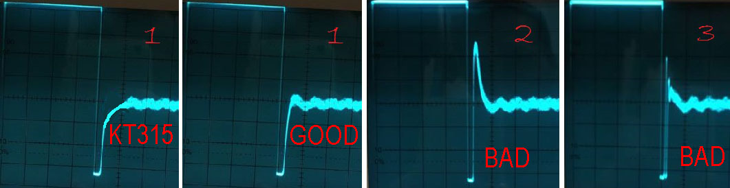

    output ne5534 with different values using the dumping tool. in the picture nr 3 i have the best air results. is this signal correct?
    [ATTACH]39225[/ATTACH]
    Image #1 shows a critically damped waveform.
    Image #2 is somewhat underdamped.
    Image #3 shows some ringing before it settles down. This signal is very underdamped.
    You should use either setting #1 or #2.
    It is conceivable that setting #3 may get better results in an air test, but it will all go horribly wrong when you test it in the field.
      With an inductance of 436uH, it is very unlikely that the correct value for the damping resistor will be as high as 1k6.
      The value you measured for the coil is the DC resistance.

            my coil have 4.2ohms because i use 1.2mm pvc coated wire for the moment. maybe that's why i get so many ringings. "critically damped waveform" mean correct? i don't understand.
            you must understand the coil has SELF resonance and ringings is exhibition of it.
            open your eyes.

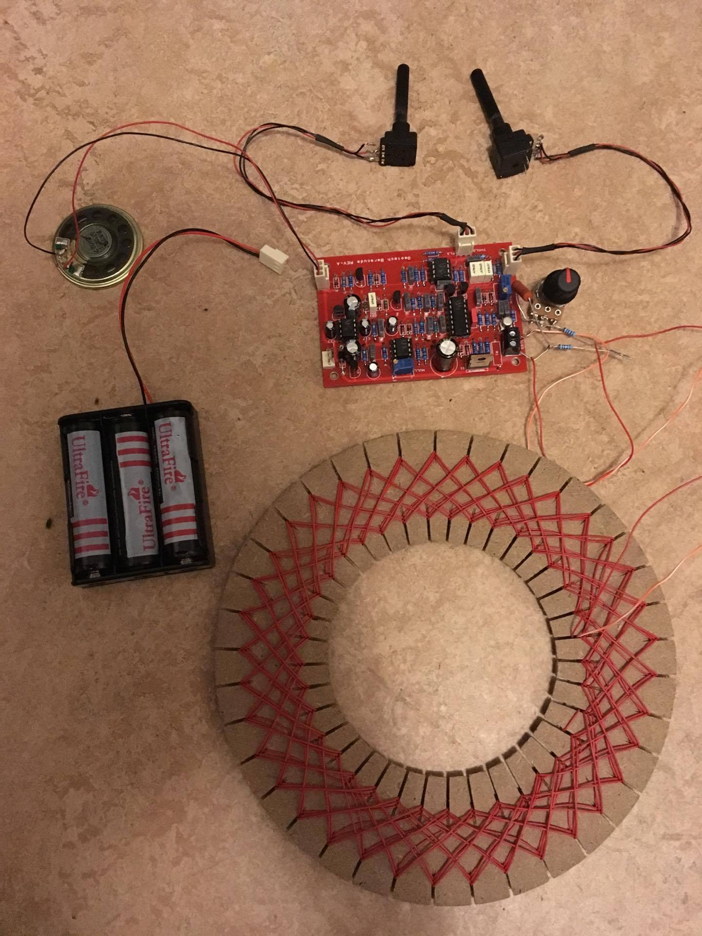

              • Well maybe the original resistor that I putted there, that was 470ohm may not be the best value but I've been testing varying the delay pot and I managed to get good results with the euro coins, I didn't note them down but the 2€ coin was 20cm and the rest of them between 13 and 16. I have to be positive, I have no way to get an oscilloscope for the moment, but the detector works very well with the 470ohm resistor, So I'll move on with that. I'll see how it performs on real ground, but for now I'm going to stick to that value since at least it works decently. Might not be the best, but I'll give it a second thought once I test it on real ground. I'll buy a bunch of 2w resistors going from 200 to 500ohm and test in real ground if this doesn't make it, and I'll do what I can to get it working as nice as I can.

                    I also did the test with american 5cent and 1cent and I wasn't disappointed either, can't remember the distances but well, whatever, I'm going to use it primarily for the beach so presumably there will be euro coins, which perform well under the actual condition, and maybe rings. Tomorrow I'll test with a slim gold ring that I have from my grandmother and see how it does. I'll be happy if I detect lots of 2€ coins though xD
                      [ATTACH]39226[/ATTACH]
                      Thank you kt315, i adjusted the dumping resistor like you said and still have good sensibility for targets. Looks more stable now and delay working good. The coil i made is only for quick tests, i will make another. Question: adding 3 more 18650 batteries (paralel) will increase the depth? or this is required only for longer pulses?
