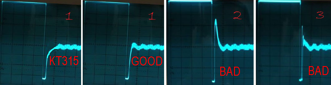

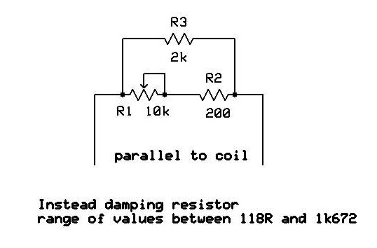

                            • I am looking for fix my Baracuda.
                              I found that the best performances are at a delay of 5us-8us.
                              I think that this is too low then the specifics :-(
                              I investigate the wave form on the coil and i find this: https://goo.gl/photos/JMzYNLqdhTSfjRUH8
                              I think that it is too smoothed... what do u think about?
                              • did you adjust dumping resistor like in picture? is possible that your delay is not working good. repace dumping resistor with the schematic in picture. and check output ne5534.
