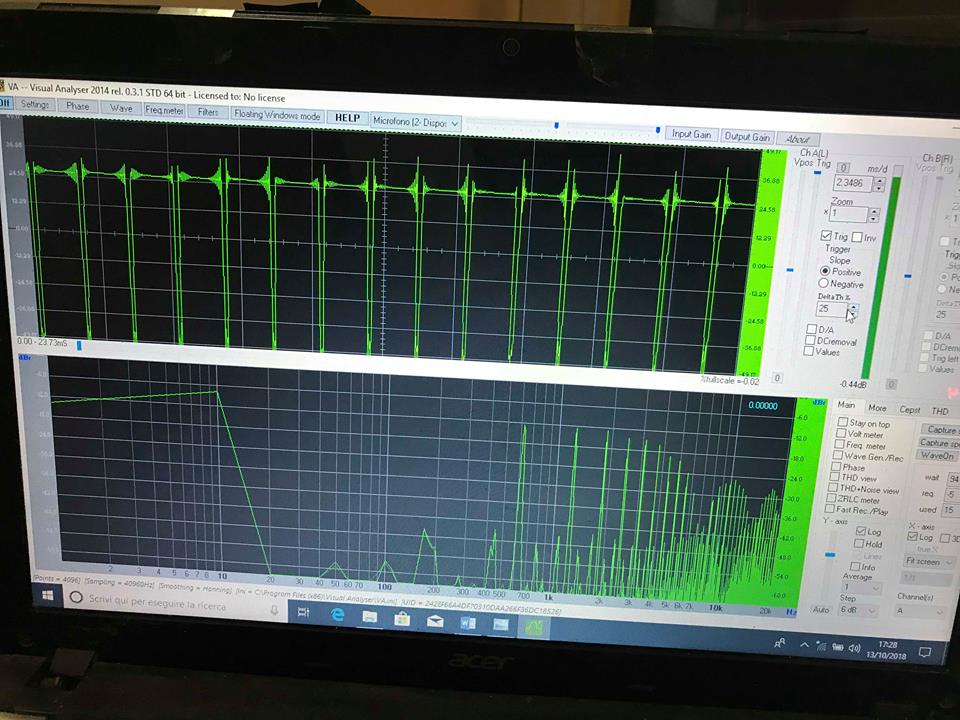

              guys, before buying a kit dso I built a probe with a 3.5 jack, a 100uf capacitor, and a 10k potentiometer .. I downloaded a program on the PC called visual analyzer, now I explain how I should do to calculate the card values ​​and where?

                That should work fine. First thing is to Measure the Frequency of the pulsing and then the Delay times and pulse widths as per step #6.
                If these are not correct then no hope of the analog circuit working.
                Next is looking at the output of the Pre-amp and adjusting the Damping resistor value.

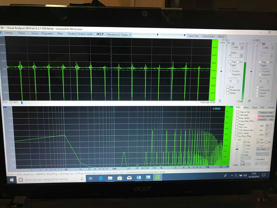

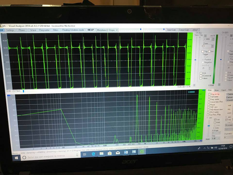

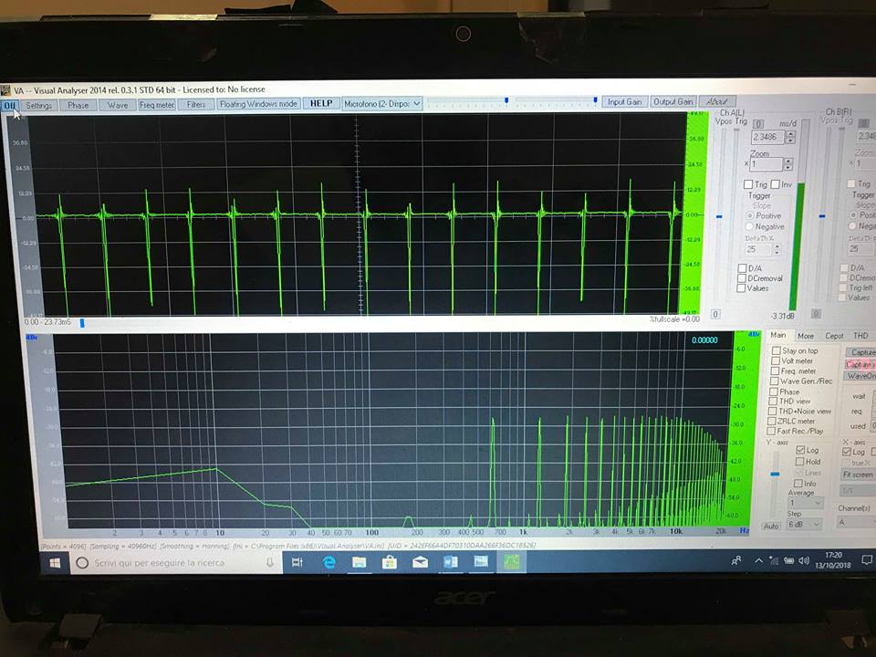

                  these are the tests for step 6 .. I do not know if it's right I can not use the oscilloscopeClick image for larger version

                    I stuck in step 7 (I do not have an oscilloscope)
                    is step 7 preamp balance? what you mean?
                      at point 7 I was stuck because I could not change the voltage, I downloaded a software on the PC and I built a probe to take advantage of the PC sound card .. I did the tests on u4 on pins 6-8-10 and those are the results, but I've never used an oscilloscope I do not know how to read or how to use it
