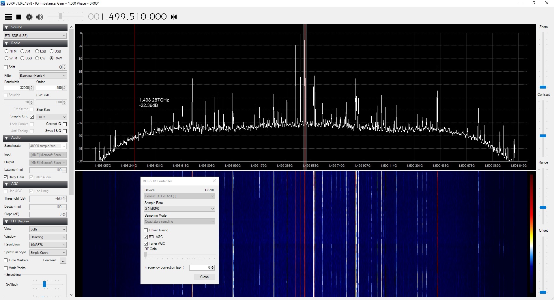

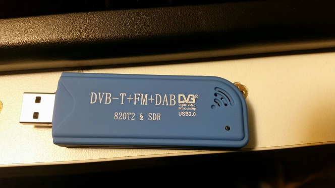

          RX is the hardest bit ... but wait ... theres one for less than $10 and does 24 Mhz to 1.8 Ghz
          How cheap is that ?
          and the software is open source and free !!! ( needs a little bit of coding on your part )
          This is a wide band radio with I Q sampling ( so you can detect phase ) and you can run lots of them off the same computer through USB bus.

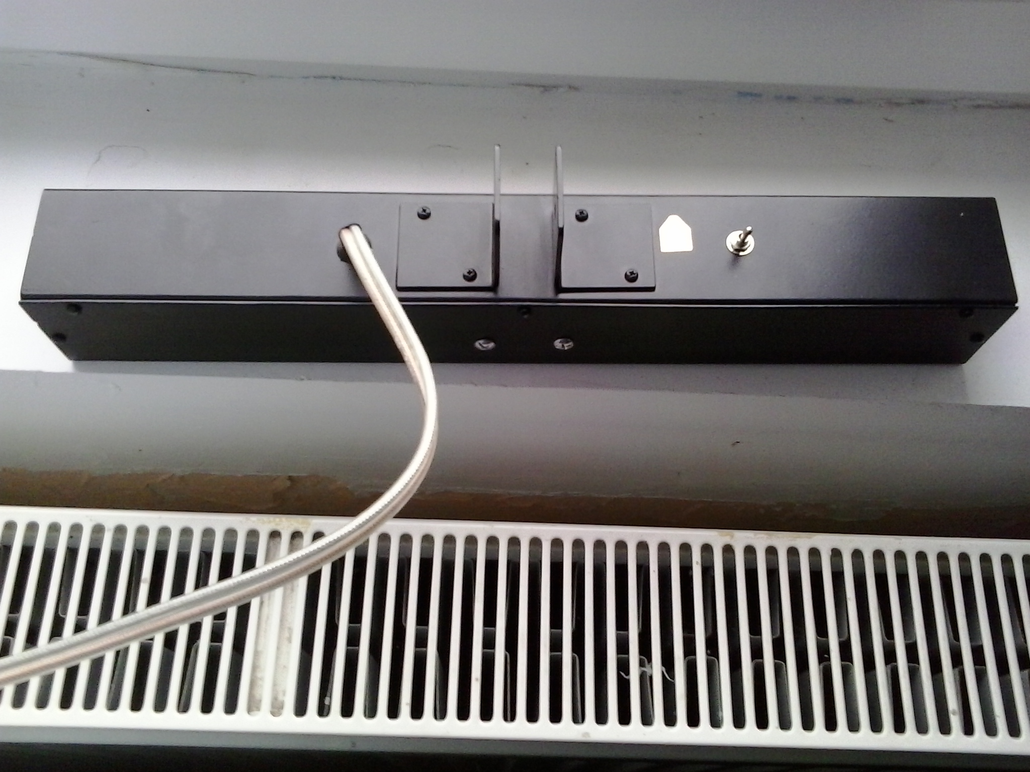

Name:	GPR +MAGNETOMETER.jpg
ID:	343730 -- switch for gpr or magnetometer ,transmitter receiver 2.5ghz Click image for larger version

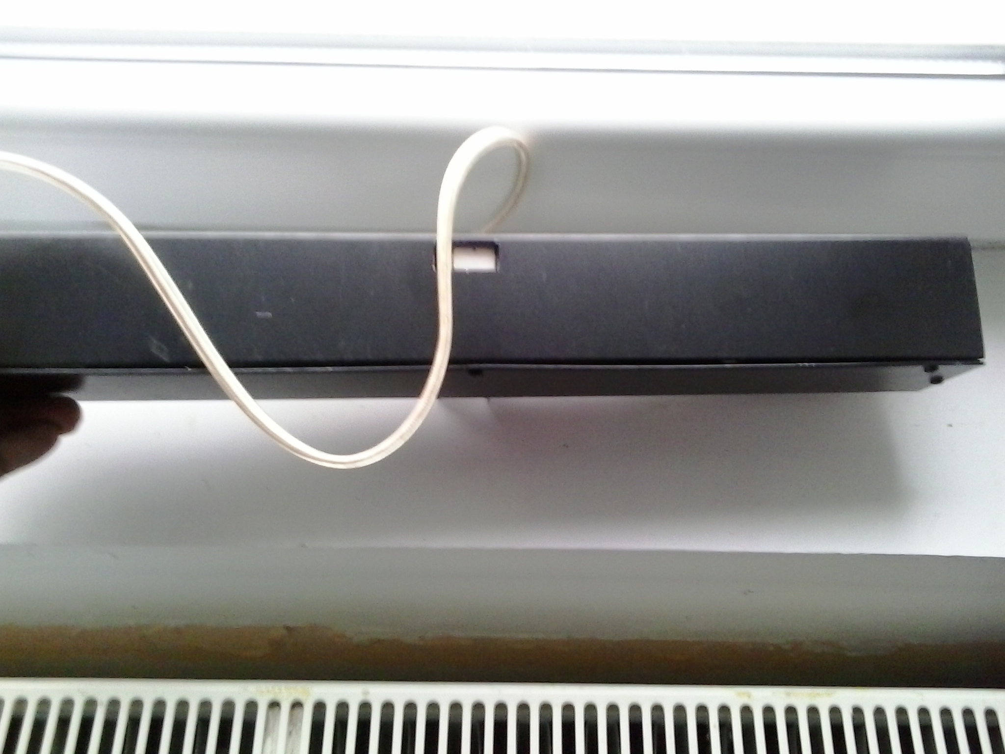

Name:	GPR TX RX.jpg
ID:	343731 software = https://www.youtube.com/watch?v=31RM...U&spfreload=10 ..https://www.youtube.com/watch?v=aKP6...U&spfreload=10
