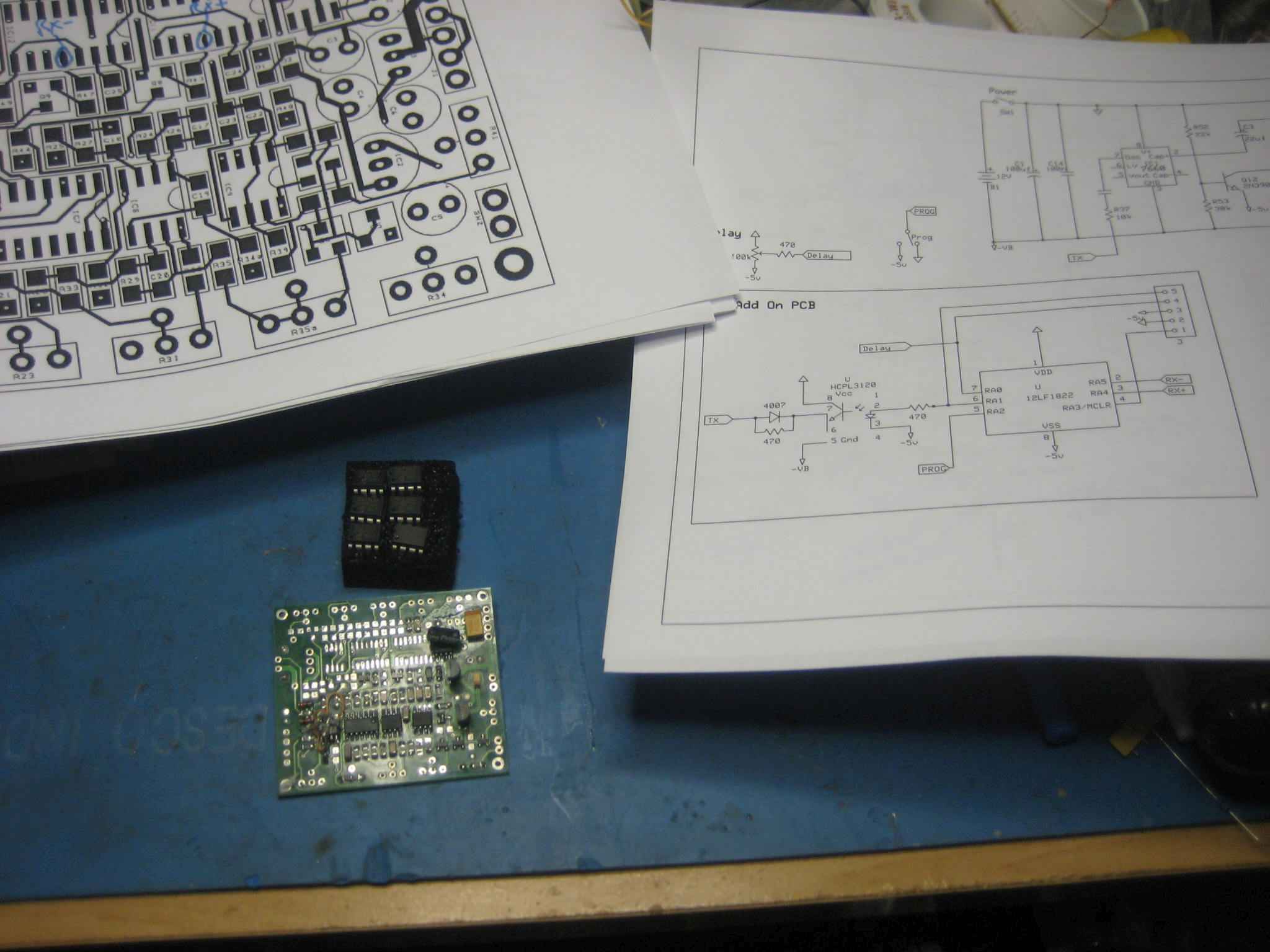

    I have a couple of SMT HH boards hanging around so I decided to make one an experimental
    platform for some PIC development.
    I picked up a 12LF1822 but then decided the VCC = 3.6V max would be a problem so I have some 12F1822's on order.
    This is a 8 pin PIC with the Enhanced instruction set and it can run at 32mhz via it's internal oscillator.
    I'll use one for the timing and then look for one to make the sounds (it might be a bit bigger).
    So here's some pictures;
    Board with docs

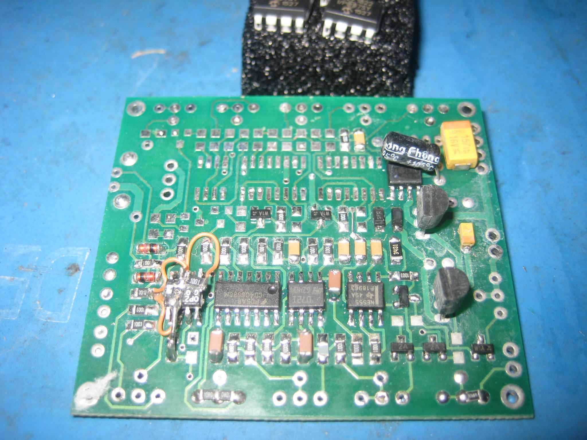

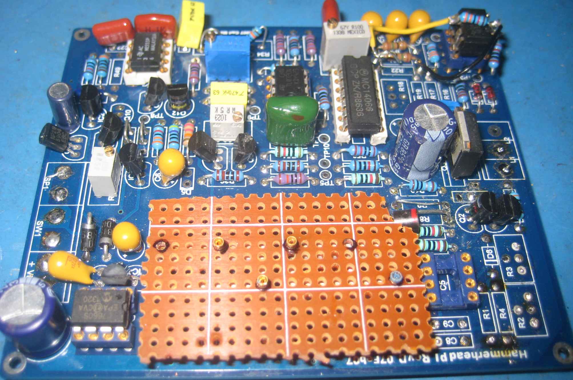

    Board with parts removed (2 stage input mod done)

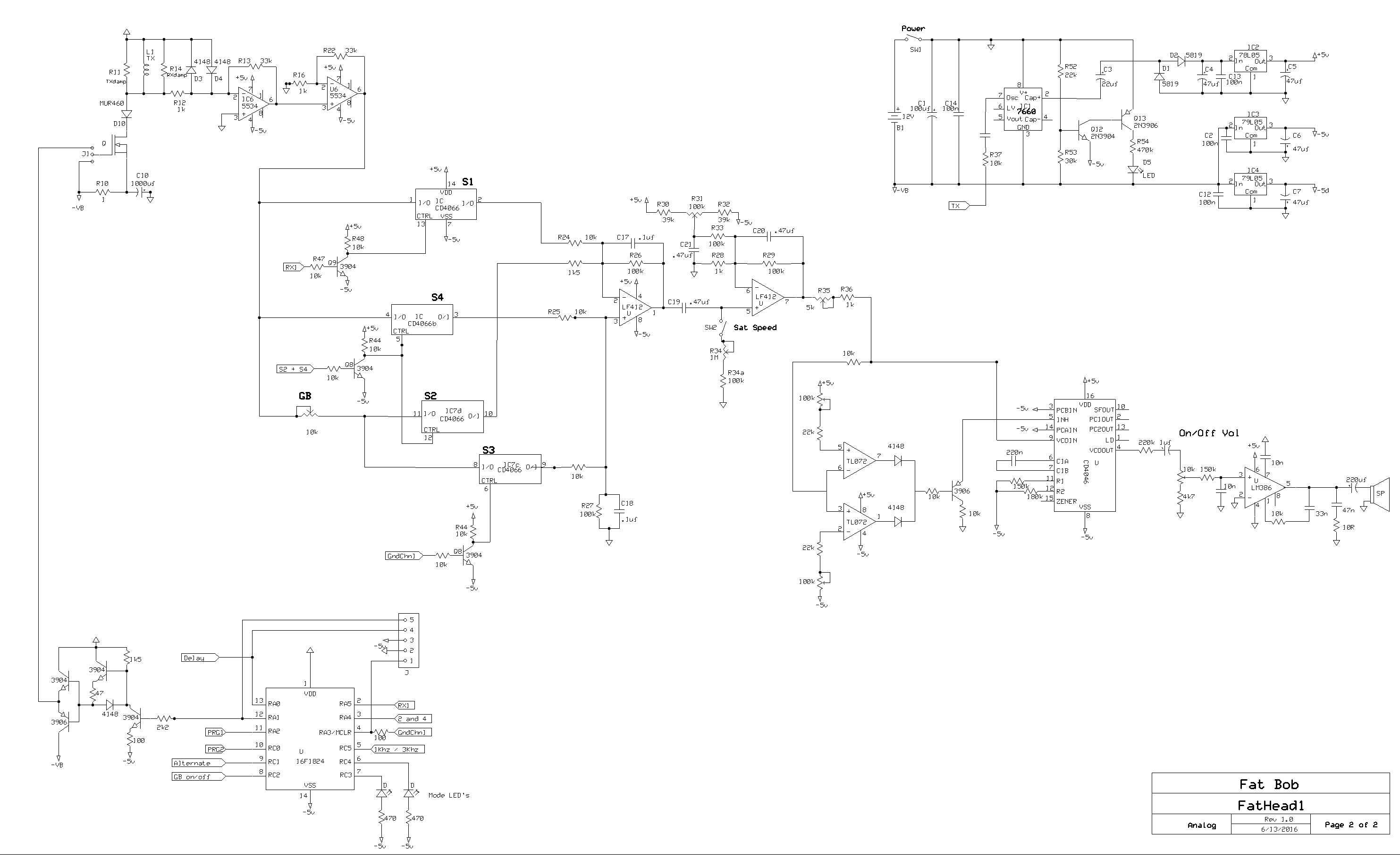

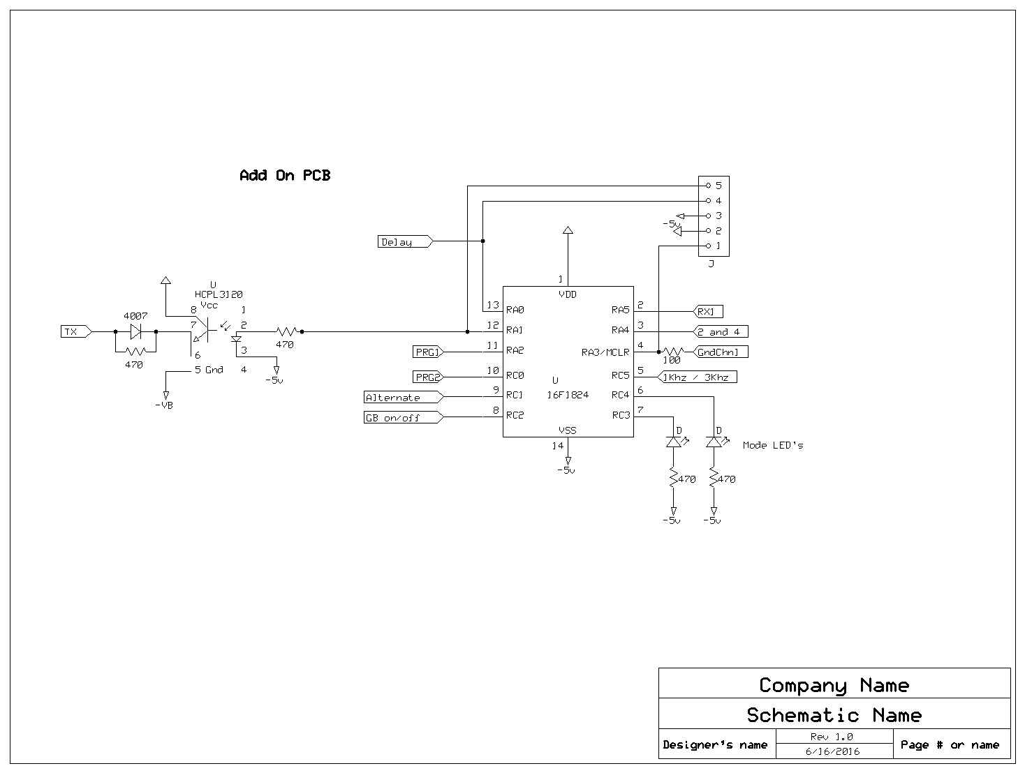

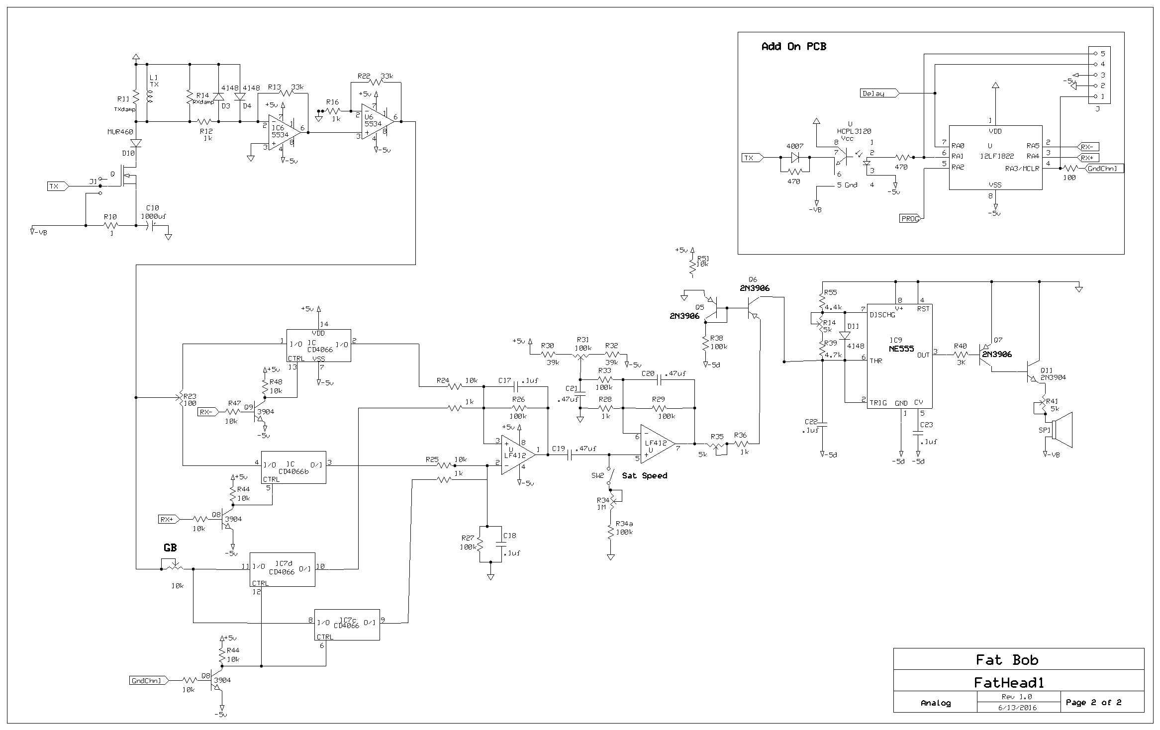

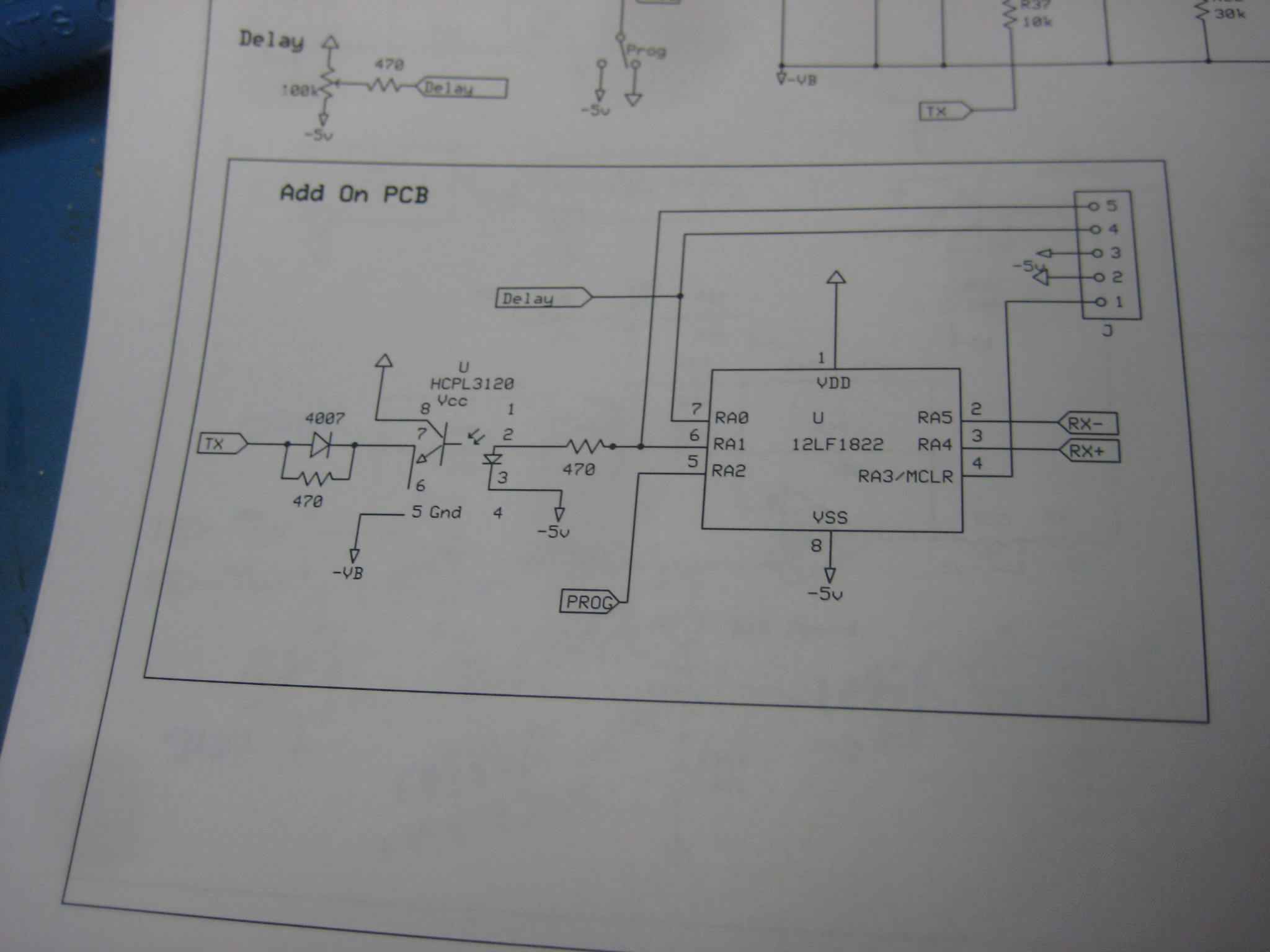

    Schematic of new parts

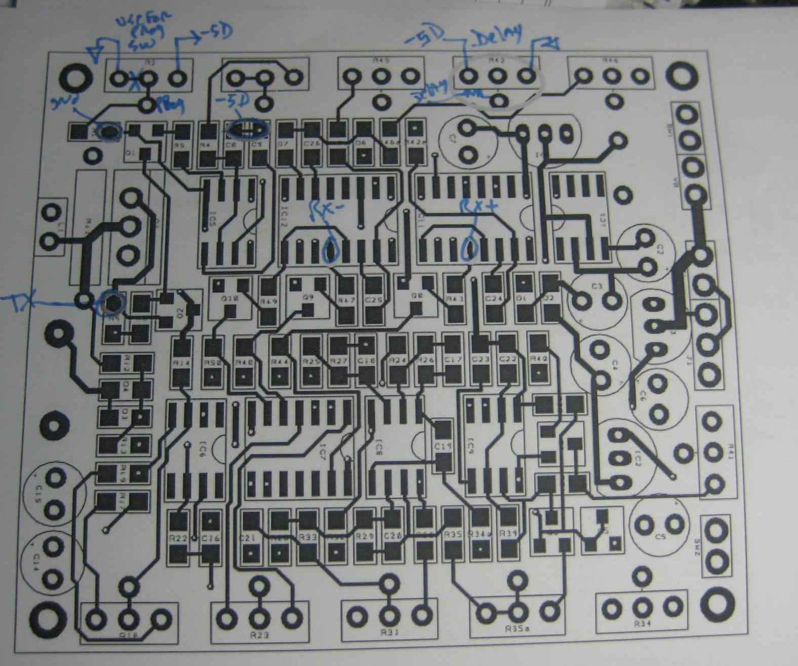

    Layout with notes

    And here's an idea for Ground Balancing this thing;

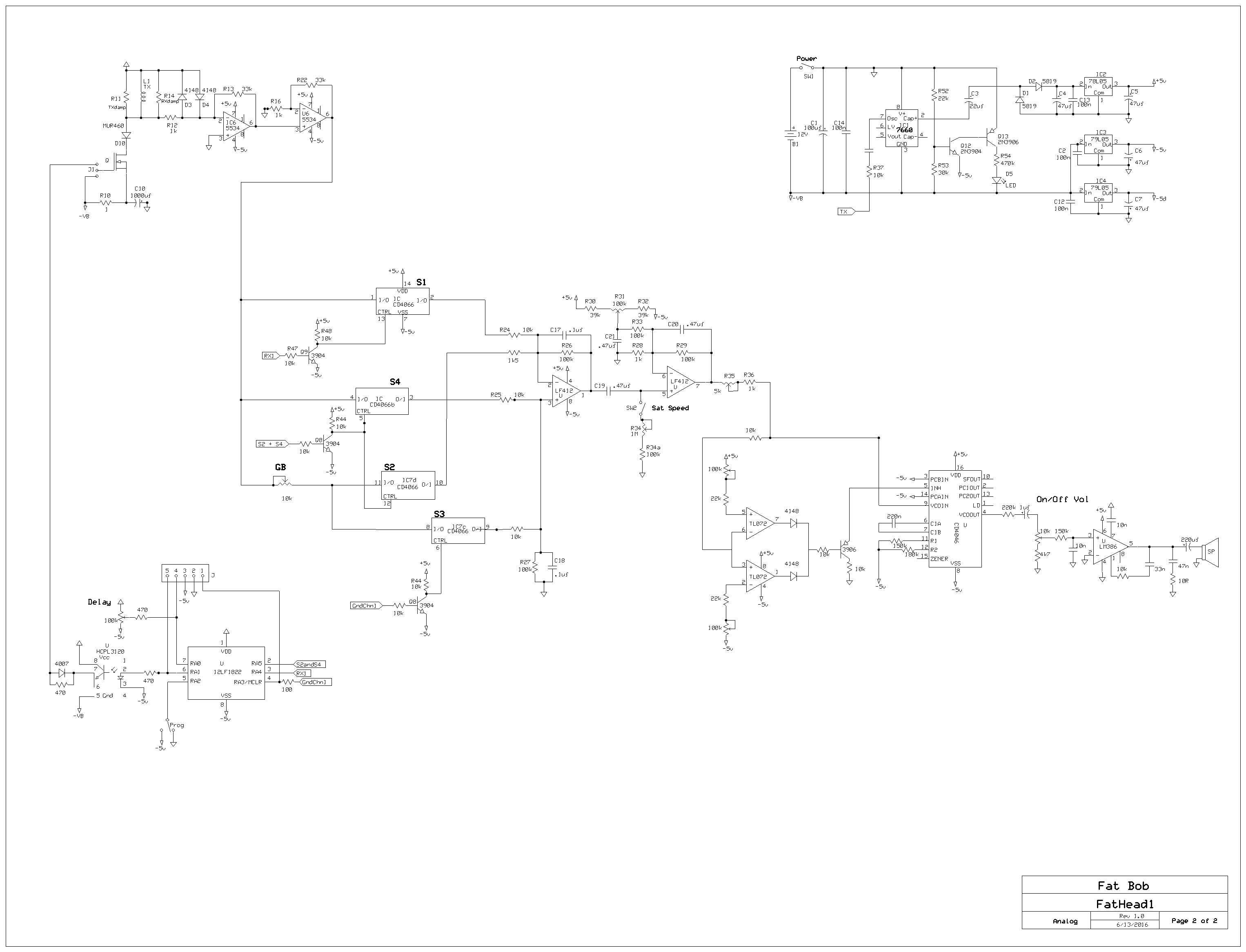

                    So with the Ground balance added in we get positive responses to lower TC signals and
                    negative responses to larger TC's with a hole where the ground TC occurs.

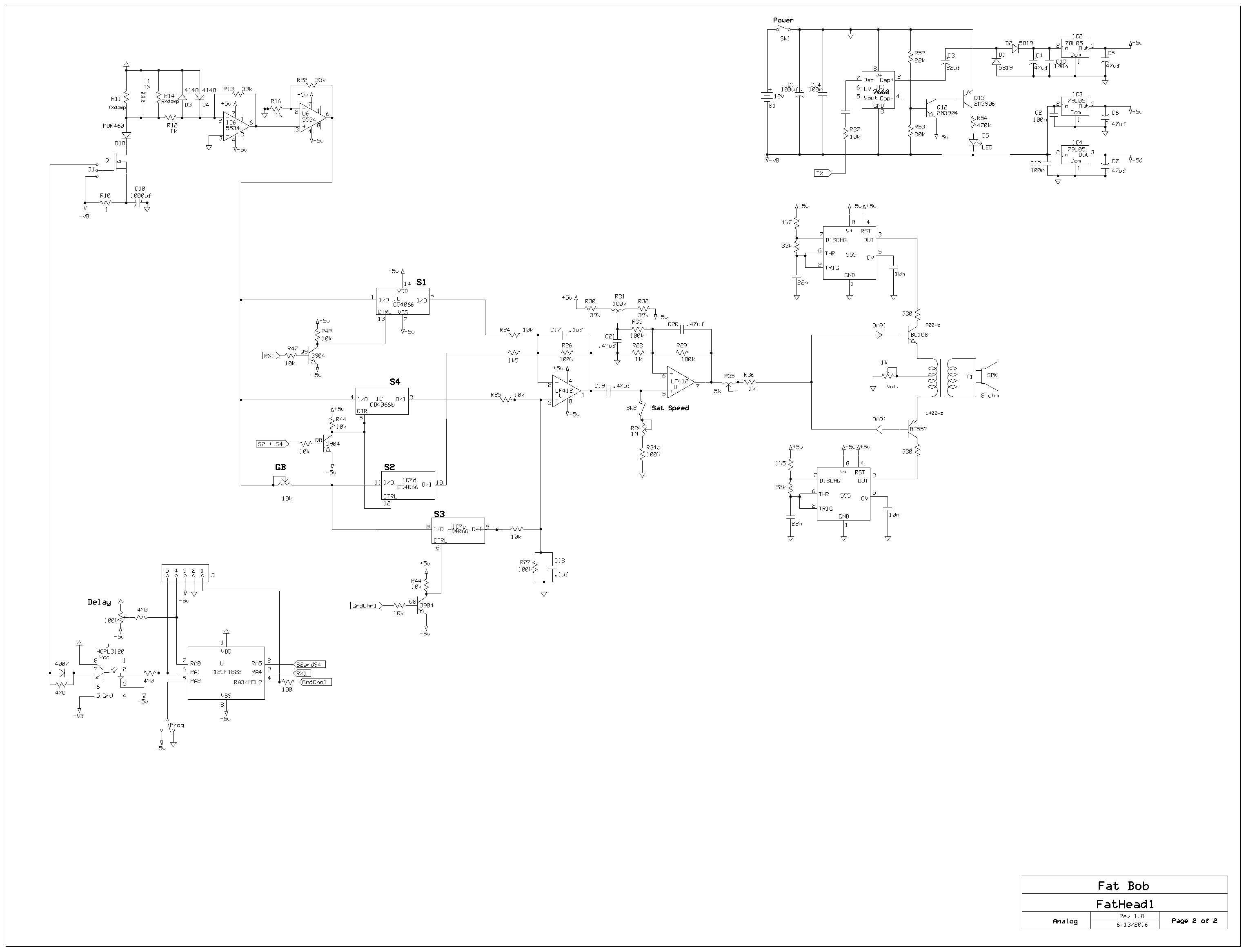

                    To hear those signals we need a dual tone or dual VCO. Here's an attempt at a dual VCO;
Name:	HammerHead With PIC GB Dual VCO.jpg
                    Here's a Dual Tone one;
Name:	HammerHead With PIC GB Dual Tone.jpg
                    This might be easier to do on a full size HammerHead so I'll use this one for now;

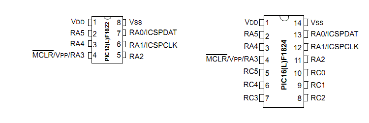

                      So I had bought some different size chips as I didn't know how many pins I would need and I just noticed the
                      8 pin and 14 pin have 8 pins in common. So you could install a 14 pin socket and plug in an 8 pin chip or a 14 pin chip.
Name:	12F1822 and 16F1824.gif
                      The 14 allows for more inputs like this;
Name:	14Pin PI Clk.jpg
                        So I'm going with something like this;
Name:	HammerHead With 14 PIN PIC GB Dual VCO.jpg
                        This allows for turning GB on and off, setting 1Khx or 3Khz transmit, up to 4 different programs
                        plus an alternating one similar to the MineLab stuff, and a couple of LED's for indicating the mode
                        we are in.
                        I found out the FET driver I was going to use shuts off at 11v - 13.5v as it is meant for a 15V - 30V
                        power supply so I changed over to a fast bipolar design.

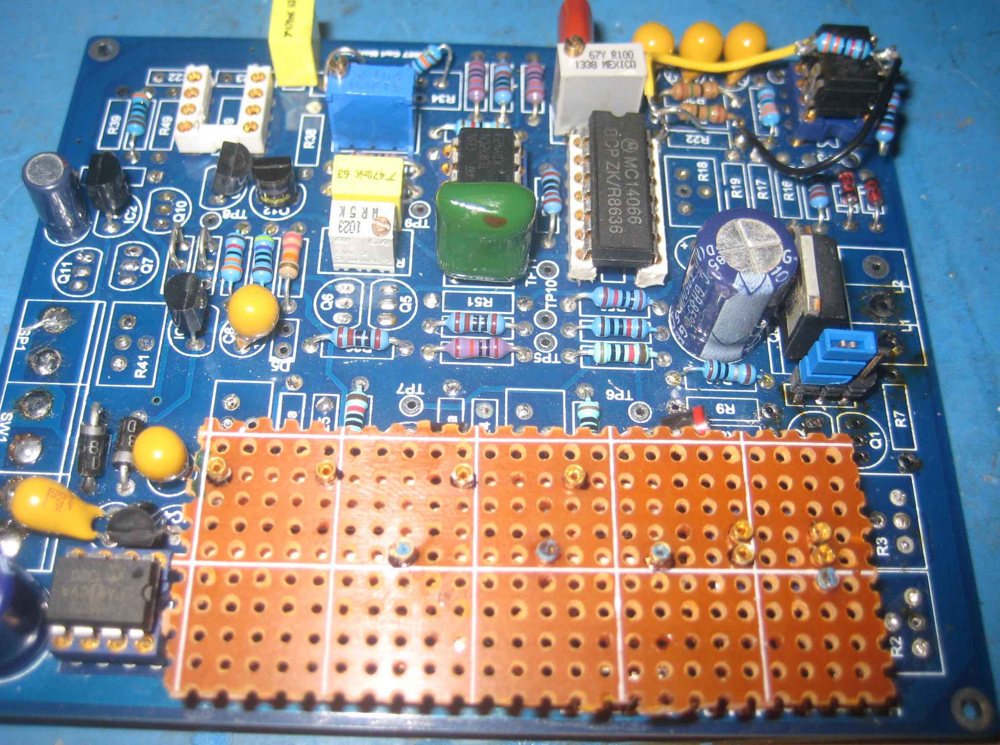

                        Here's the piggyback board that sits on the original 221 and 555 sockets and make connection to
                        key signals;
                        My 5V PIC's came in today so we could get something running this weekend!
