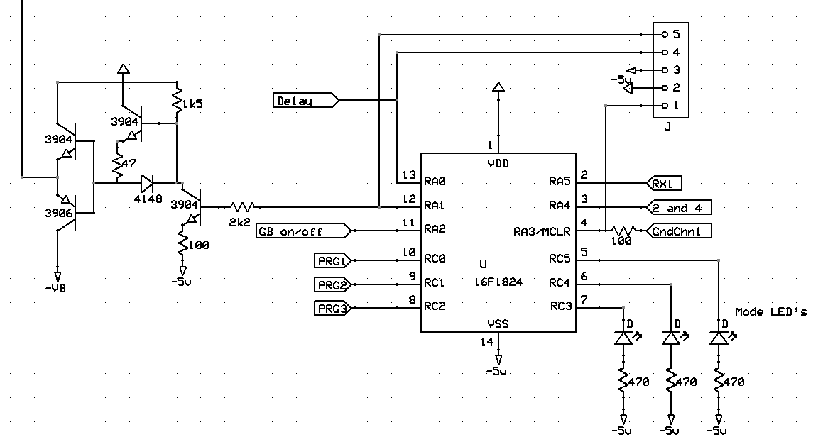

            Here's some initial code for the 14 pin device. I changed some of the pins around to make the
            programming easier;
            FatHead2.zip
            Here's a partial schematic to show the pins relabeled;
Name:	New 14 Pin Schematic.gif
              Just found a 16f1824 in junk box. and it took the hex file, getting a few pulses.
                I just found a way to do GB with the original 2 pulses so no additional hardware changes are needed.
                You adjust the GB with a pot and it also includes a Delay pot and GB off switch Though I might make it
                shut off automatically when the GB pot is adjusted mostly off.

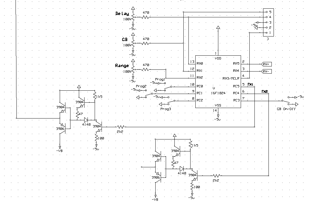

                      Well the plan was to do the sound too and I looked at using a bigger chip to
                      do both in one chip but it involves a bit of multitasking so I may just use 2
                      different chips.
                      The current incarnation I call Extra Fat. It has 2 TX, 2 RX, 7 programs, A GB On/Off
                      switch and 3 pots all in a 14 pin 16F1824 chip.
                      I'm still working on the code and trying to figure out what the 7 programs should be.
