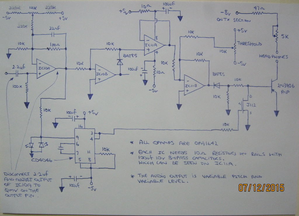

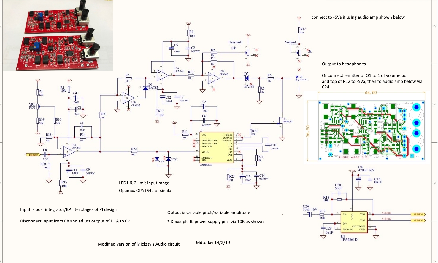

                    • Hi Waltr thanks for the update on the vco
                      back in post #25 you talk about the circuit posted by mickstv (I did prototype this circuit and it works very well):
                      the schematic in Micks post has now gone due to being posted on external site and expired
                      if you still have it would it be possible for you to post it here for reference and to last longer thanks.
                        Yes, I do have a copy and Posting here:
                        Mod'ed
                            [ATTACH]46430[/ATTACH]
                            Mod'ed
                            [ATTACH]46429[/ATTACH]
                            Thanks, this should last a long time here, hosting pictures off site can disappear quickly
