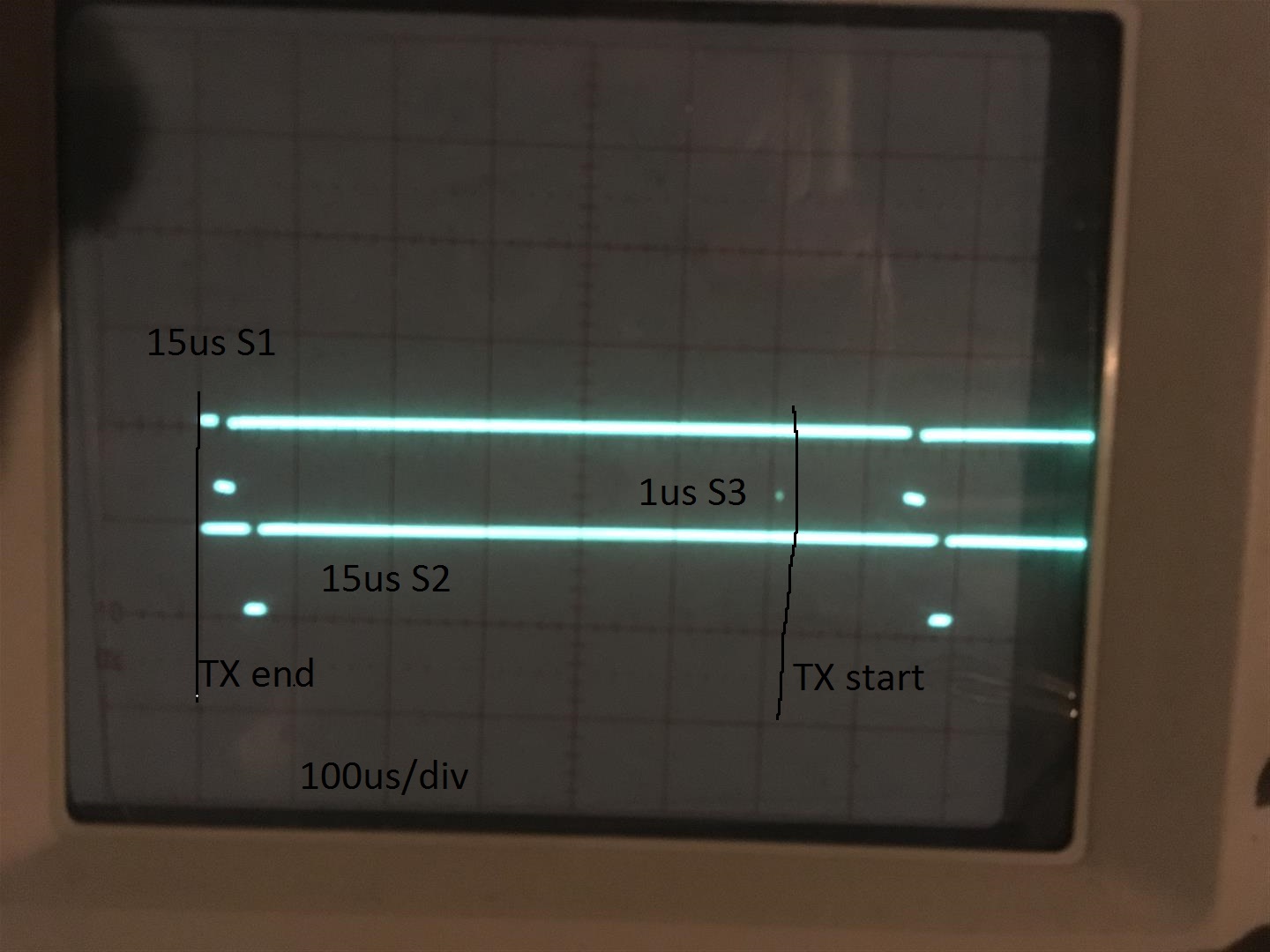

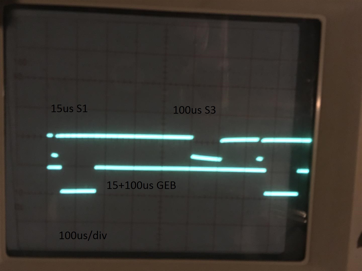

      To clarify the Timing I am using attached are scope captures. Top trace feeds the inverting Integrator, bottom trace feeds to non-inverting integrator input. The scope uses External trigger at the end of the TX pulse so traces start at end of TX pulse.
      First scope capture of the sample timing with GEB = 0. This is D1 = 15us, S1 = 15us, D2 =15us, S2 = 15us. S3 is a very small, ~1us before the TX.
      Second is with GEB set to 100us. D1, S1, D2 all still 15us but S2 = 115us and S3 = 100us.

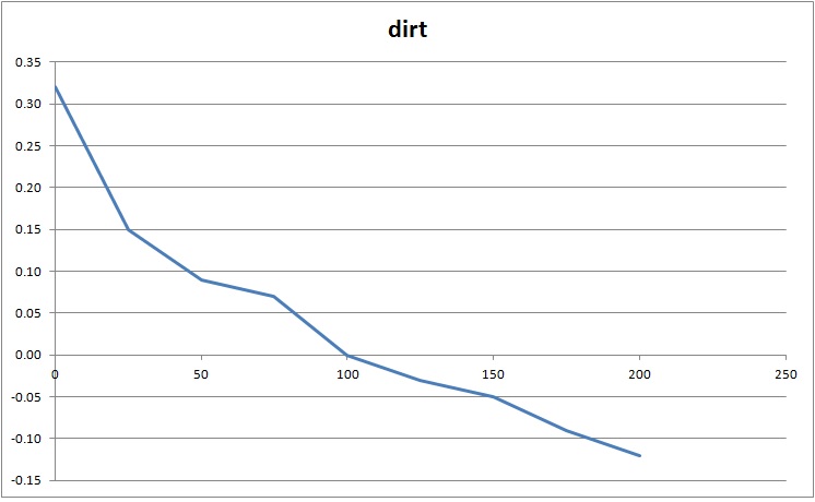

      Obtained a bag of mineralized soil from a kind forum member to test GEB. With the GEB set to 0, this 'hot soil' causes a response from the detector. Graph 'dirt' is the Voltage change out of Integrator when the hot soil is placed on coil verse GEB values. Note NO Response with GEB set to 100usec and response going negative when GEB is greater than 100usec.

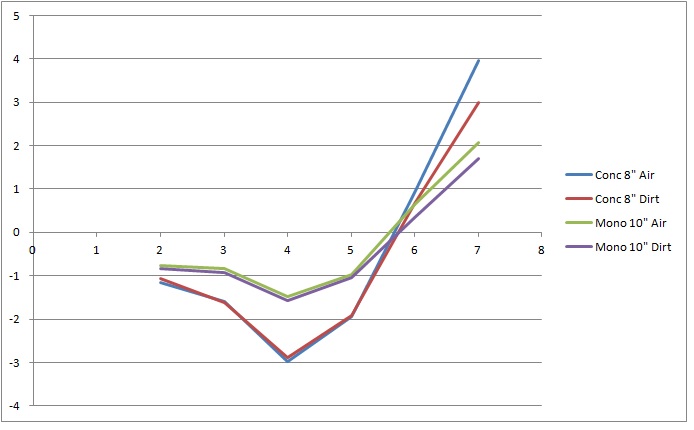

      Next test is to compare the response to targets without and with the 'hot soil' between coil and target.
      Table and graph is Voltage change at Integrator output for a few common targets. Targets are 1.5 " (3.8cm) above coil. This shows a slight loss of depth with about 1" (2.5cm) of hot dirt between target and coil. A bit odd but with the mono coil the 'high' conductive targets response are a little greater with the hot soil on the coil but the opposite for the 'low' conductive targets- one explanation is I did not get the GEB control to the Exact same position for the two measurements with the mono coil. I would expect a slight decrease of depth detected is soil verse air.
      GEB = 100 Concentric 8" Mono 10"
      Air Dirt Air Dirt
      Ag coin 2 -1.15 -1.06 -0.77 -0.84
      Ag Dime 3 -1.60 -1.62 -0.84 -0.92
      Ag Quarter 4 -2.98 -2.89 -1.49 -1.58
      Cu penny 5 -1.95 -1.92 -0.97 -1.04
      slug 6 0.92 0.66 0.64 0.35
      nickel 7 3.95 3.00 2.08 1.71

          I thought I had Adjusted GEB for zero change with the hot soil but may have not gotten it perfect between those two sets of measurements.
          I did build a bridge across the coil and put the hot soil under the bridge. This keeps the target distance the same.
          I wanted to measure IF the hot soil changed target response verse response with Air.
          The 'Slug' is a zinc plated steel punch-out from an electrical junction box. I have been using it since it is 'coin' size and is steel (iron).
          Actually the Nickel also has a decease with the hot soil also. Only thing common with these two targets are they Both give a Positive response, even when GEB is 0 or 100.

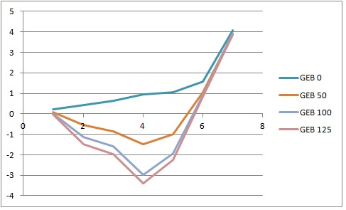

          Here is a graph of the target response at verse GEB setting. Target numbers same as above with the addition of the Hot soil as Target #1.

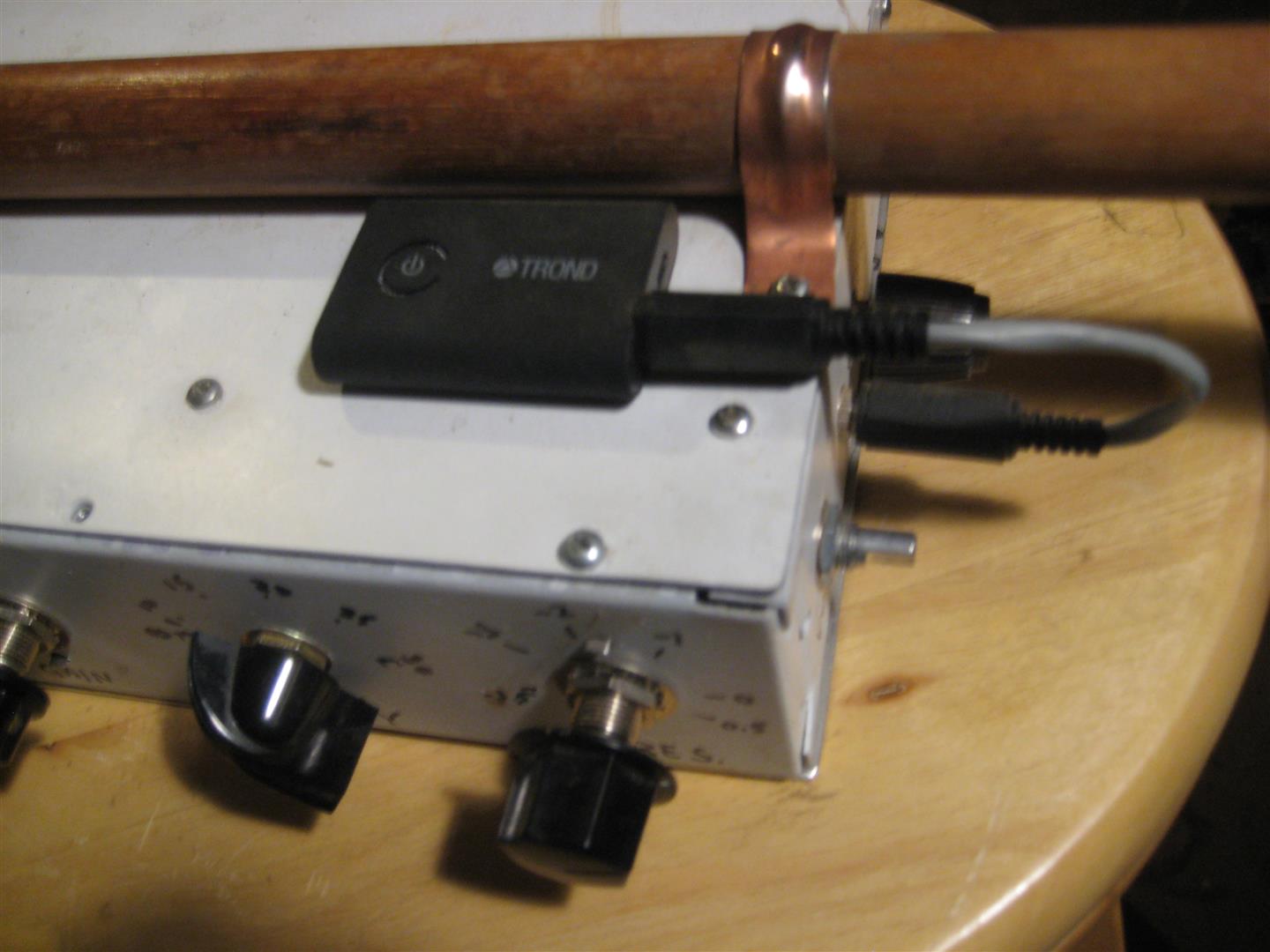

                    I attached the BT Tx to the detector case with double sided foam tape and made a Mono to Stereo cable to plug into the Detector's audio out. Great sound and I just wear the headphones around my neck so I can still hear things around me. See photo.
