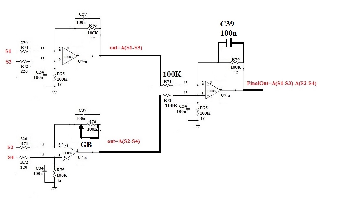

My take on the HH2
    Do you think gain of final stage should be 1 to do final subtraction or it's better like other 100?
    It can be 1 or it can be higher. It depends on the overall design.
    Originally posted by h9361 View Post
    Do you think i should put C39 or doesn't need?!
    Generally it will help.
    Where/how are you implementing ground balance control?

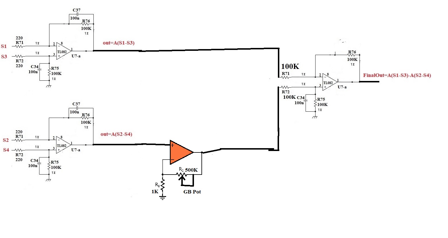

      My GB pot is here.
      I want to add it to your HH1, can you suggest me 1 or higher gain?
      • You can try that but I think it's not going to work.
          Is it possible to tell me why it is not going to work?
          Can you tell me your reason?

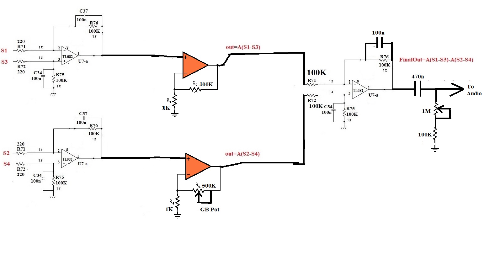

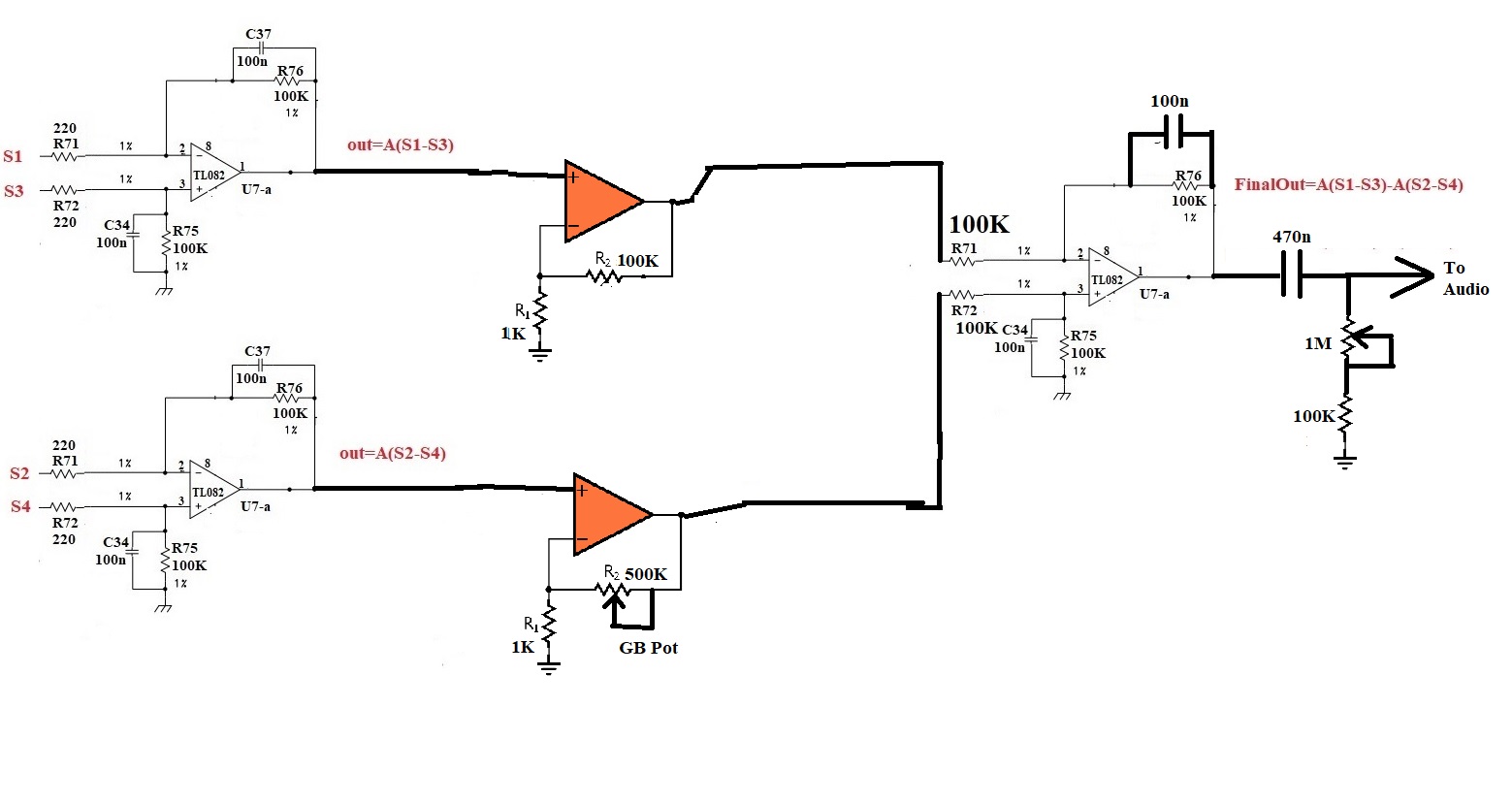

            • I think your meant is use of a separate variable gain like the attached, is it true?
              • For GB to work it is critical to match the delays of the TGT and GND channels. Yes, you can add a variable gain to the GND channel but you need to add an equal-delay fixed gain to the TGT channel. You also might consider adding a SAT circuit to both channels. Yes, you can also vary the GND sample pulses for GB but probably you still want some extra gain in the GND channel, otherwise the pulse width can get very wide.

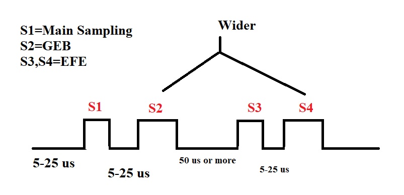

                  According to GB discussions, there is two idea about using sample width:
                  1- All of four samples use an identical sample width, like TDI.
                  2- Only S2 and S4 (S2-S4) use a wider sample width.
                  Do you think which of them is better performance, or What is difference between them in practice??!
                  • Using a wider GND sample will improve noise performance.

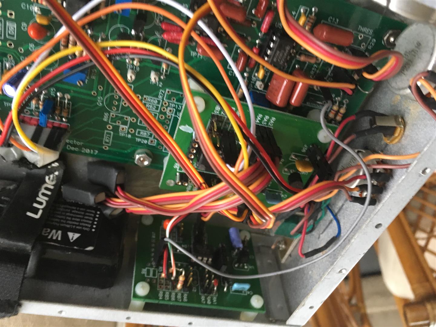

                              • My VCO uses the SAT output through a 2:1 Voltage divider into an ADC input of a PIC12F1501.
                                The Q9 and the 555 are not used. The PIC output, audio tones then goes into R48, LPF, to Q11 &Q12.
                                The PIC12F1501 is on a PCB with a header that plugs into the 555's socket for power and audio out. Another lead connects to TP9 to pick up the SAT output stage.WR-PIdet-sh2.pdf
                                That PIC12F1501 VCO is in the upper left corner of this picture.
Name:	IMG_1152 (Large).JPG
                                I also use a 1000 Ohm to 8 Ohm audio transformer from audio transistor Q12 for isolation and Impedance transformation to headphone jack.
                                This then goes to a Blue Tooth Transmitter for use with Blue tooth headphones.
                                All of this is in this thread but you must read the entire thread to follow the changes made.
