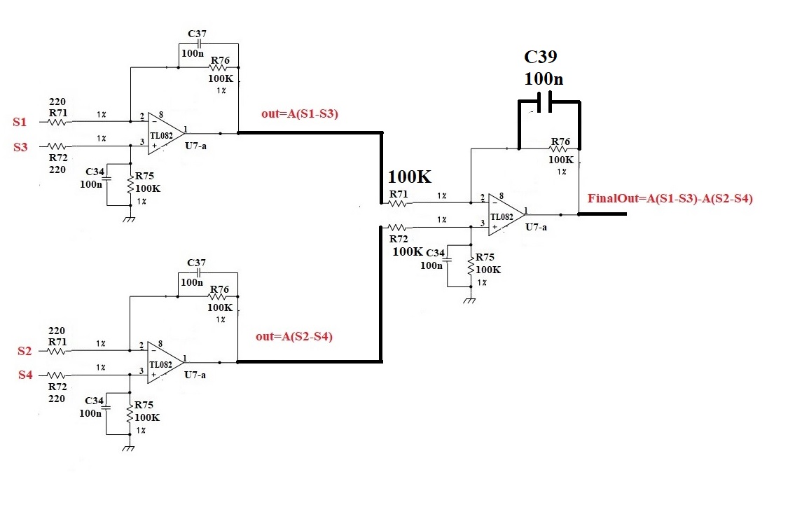

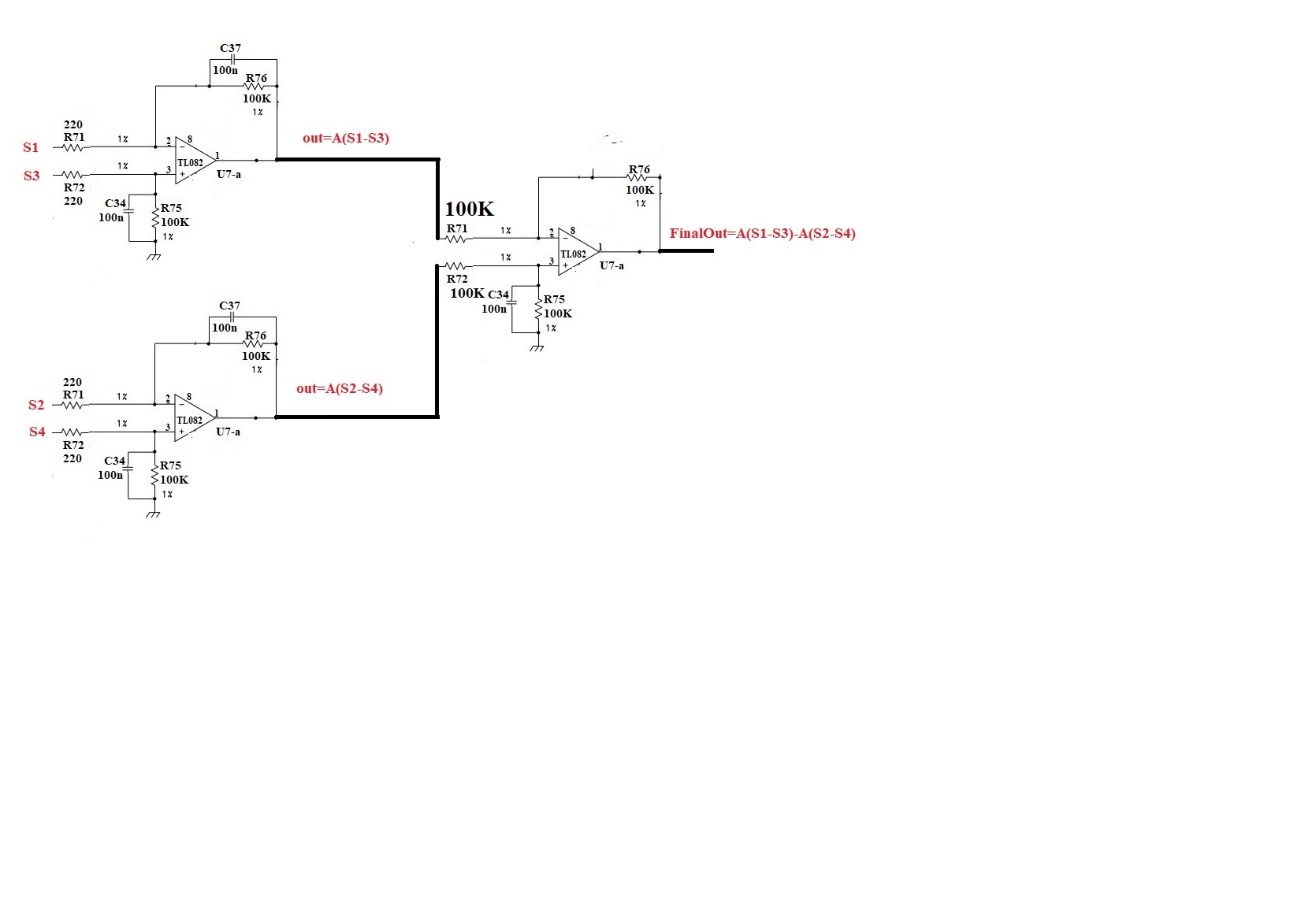

                          I have a request, is it possible to see attached (A1(s1-s3) - A2(s2-s4)).
                          Do you think gain of final stage should be 1 to do final subtraction or it's better like other 100?

                          • Not really sure.
                            Why is there a 100uF cap on S2-S4 input?
                            With this method of GEB typically the GB sampling has a variable gain (panel adjustable) to set the GEB.
                            This can be the FB or input R.
                              Not really sure.
                              Thanks, which 100uf? i can not find the cap.
                              • Do you think i should put C39 or doesn't need?!
