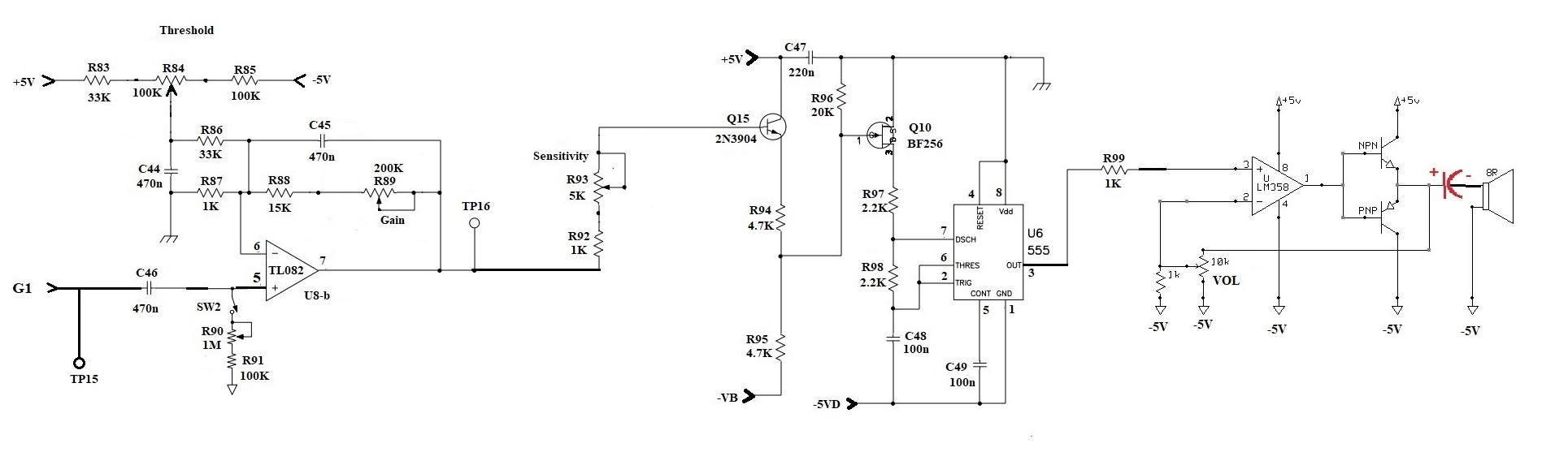

    I have a question about your Audio part. Do you think i can use a speaker or need to an audio amplifier (LM386)?
    [ATTACH]55359[/ATTACH]
    Not sure you will need to build and try it. I don't think this will drive an 8 Ohm speaker but maybe a higher impedance speaker.
    Due to case at 0V (B+) and audio out referenced to B-, I put a audio transformer, 1k:8 Ohm where the schematic indicates head phones.
    The transformer output then drives a low latency Blue Tooth transmitter.
    I wrote about this above.

      Actually, i'm going to build and to test three versions of Audio for my HH1: your audio, Mr. Mdtoday and the attached.
      After testing, i will tell you my results.
      Is it possible to see the attached, is it correct?

        Build it to find out. And like I said, it can depend of which speaker you use.
        Why don't you start a new thread in the HH1 sub-forum for all your questions and the results of your builds and tests.
        Then it is all in one thread instead of scattered through out the geotech forum and in the wrong threads.

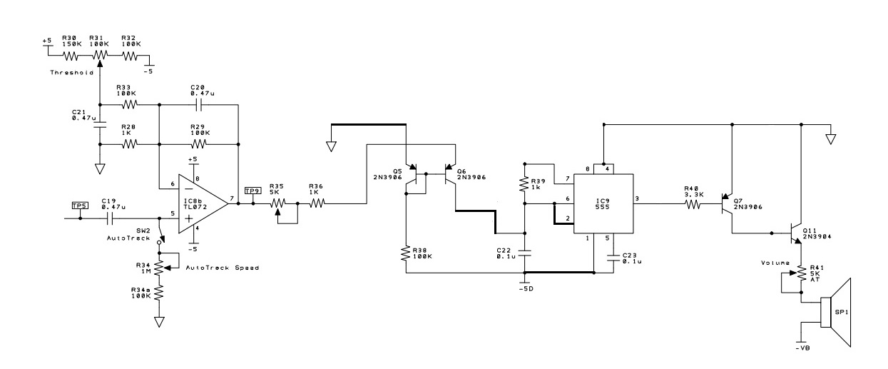

          See attached, i think it's more easier than other method for 8R speaker.

            The LM358 is easy to use and drives an 8Ohm speaker. So that is a viable way to go.
            Looking forward to your thread and what you find building and testing.
