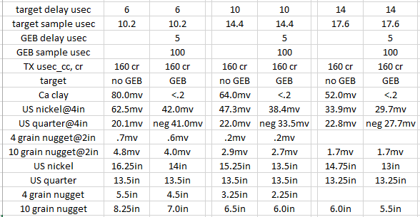

    We are doing the Same timing sequence- I do the EF sample just before the TX pulse and it is the beginning of the timing sequence.
    A big difference is that I run an adjustable GB and EF sample time whereas you seem to have both fixed to 100us plus the target sample.
    Whereas I have a Target sample and the No GB sample the same (15us) then as GB adjust is increased the GB sample and EF samples increase by the same amount.
    So with GB = 0: EF sample = 0us, TX =100us, Delay1, Sample1 = 15us, delay 2 = 20us, GB sample = 15us.
    With GB = 50us: EF = 50us, TX = 100us, delay 1, target sample = 15us, delay 2 = 20us, GB sample = 65us.
    This meets the diagram is Post #72 of: http://www.geotech1.com/forums/showt...-Balance/page3
    I do have most of the timing adjustable using either a trim pot or panel mounted pot int the processor's ADCs.
    Either way, hardware timing or software timing we accomplish the same thing.
    Have you been able to Test the GB on mineralized soil? I haven't as yet so do not know if this GB scheme actually works.
    Have you tried slightly different timing, delays & samples, and tested on mineralized ground?
    The one thing I have found is with the GB sampling there becomes a 'pivot point' where high conductors cause a negative output from the integrator and low conductors give a positive output.
    Other variations of timing does not do this.

      In the chart you posted, what is the timing sequence when you have No GEB?
        What I don't understand, except by the equation stated, is how to do an EF sample far from the target sample when the GB adjustment goes to Zero?

          Mathematically, with S1 = main sample, S2 = EF sample, and S3 = ground sample:
          X = A1(S1-S3) - A2(S2-S3)
          which subtracts the ground sample from the main and EF samples before finding the difference.
          A2 is the ground balance control gain, Adjusting this will eliminate ground.
          Alternatively, you can also use this equation:
          X = A1(S1) + A3(S3) - A2(S2)
          where A2 = A1 + A3
          If you set GB to zero, then S3 = 0.
          Therefore: X = A1(S1) - A2(S2), and A2 = A1.
          Then: X = S1 - S2, which is the situation where GB is off.

                              If GEB = 50us then S1 = 15us, S2 = 65us, S3 = 50us.
                              IF GEB = 0 then S1 = 15us, S2 = 15us, S3 = 0us.
                              This seems correct?
                              Question is: is S2 at only 20us after S1 effective for EFE?
                              Or: does the three Sample method really not work and four samples are needed with the last two (more than 200us from the first two) widths be varied as GEB adjust?
                              Since the HH2 timing is microprocessor controlled it is easy to program or change any timing we can think of verse hardware timers that are hard to make big changes to.
                              The ease of changing timing allows easy experimenting based on theory and discussions. If it does not works then just re-flash the processor with the code that does work. I can go back to the simple two sample (target-EFE) in less than a minute.
                              I had thought of using part of a second HH2 PCB to add a GEB channel but if GEB can be done with just software and pulse timing why add the additional hardware. If this proves to work then any of the processor controlled single differential integrator PI detectors can use this scheme to add GEB. This is the purpose of this thread and the discussions herein (and maybe added to the Third edition of the your book).
                              • #60
                                In the sampling integrator, different signals produce different effects. If the integrator is non-lossy and the input signal is "DC" then integrator gain is linear with pulse width. Earth field is the closest thing you have to a DC signal. Target signals are exponential and ground is 1/t, so integrator gain is non-linear with pulse width for those signals.
                                In most PI detectors EF cancelation is done with late subtractive samples that exactly match the early samples in pulse width, because EF is considered "static" over the course of 200us or so. Ground & (most) target signals have decayed away so they are unaffected. If the PI design uses static target & ground pulse widths and analog gain for adjusting GB, then the EF pulses are matched to the T & G pulses and subtraction takes place in the channel integrators, where the same gains are applied to T & G signals, as well as EFT and EFG signals.
                                If the PI design uses a variable pulse width instead of variable gain for GB, then the EFG pulse width should track the G pulse width. If you want to use only one EF pulse, then the math is simple: the EF pulse width should be equal to the difference in the ground-minus-target pulse width. That is, if the T pulse is 10us and the G pulse is 40us, you need an EF pulse of 30us, and added to the T signal. If adjusting GB changes the G pulse width, then the EF pulse width also has to change. All this assumes both signal channels have the same gain; if they don't, then the EF pulse width has to be adjusted to compensate for the gain difference. This is why most PI designs use separate EF samples, each one fed through the different T & G channels. It's easier.
                                Thanks for the improved explanation.
                                I did once upon a time fiddle about with GB using variable pulse widths and only one EF, but it was tricky to implement, and the results were not that good.
