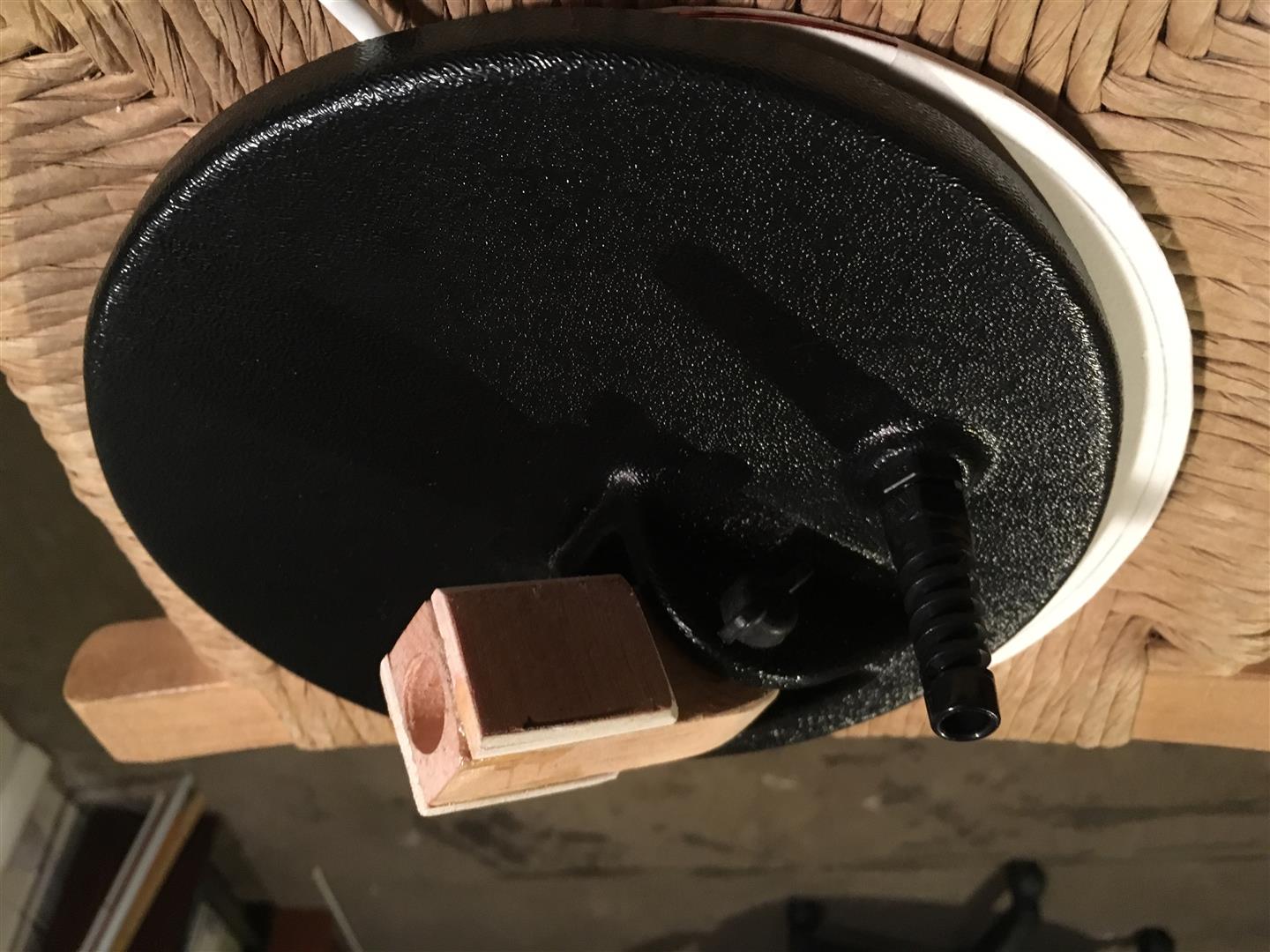

      20cm (8") Concentric coil
      This is another type of Induction Balance coil consisting of an outer TX coil and an inner RX coil. The IB is achieved by winding a few turns of the TX around the RX coil but in the opposite direction. This Balances or Nulls the TX magnetic field in the RX coil.
      Don Bowers explains building these coils very well here:
      https://sites.google.com/site/dbcoilshells/home/resources/building-concentric-coils
      His coils are for VLF MDs but construction is the same. I just calculated the coils to get around 400-500uH inductance for a PI MD. This turns out to be 27 turns, #28 enamel for TX- 470uH, 4.3 Ohm, 33pF. The RX is 42 turns, #28, 406uH, 2.8Ohm, 58pF. The Buck coil worked out to 7 1/4 turns, 15uH, 0.63 Ohm. Since the Buck coil is wound in opposite direction it subtract from the TX coil inductance. Therefore the effective TX coil inductance is around 450uH. The RX coil inductance is a little low so I may add a few more turns. Some have tried making the RX coil inductance up to twice the TX which increases the RX Signal, sensitivity, but this also increases any Noise pick-up.
      Don sandwiched layers of foam board as a coil form. But since I needed way less turn for a PI coil (much lower inductance) I used a single sheet of 1/4" foam board and filed away to foam with a small round file. This created a groove between the cardboard outer layer and a perfect form to wind the coils.
      Balance is Tuned by observing the signal at the Pre-amp output on an O'scope and moving the Buck winding lead until it is just over balanced. This is seen as a high level at the beginning of the TX period but dropping to zero before half the TX period is over. See picture " Coils close but over (Large).JPG" in post #6 above). The reason to 'over balance is the phase' information that I plan to measure in an upcoming PIC code version.
      The Foam core coils were then put into Don's 8 inch Clam shell.
      Coil Photos:

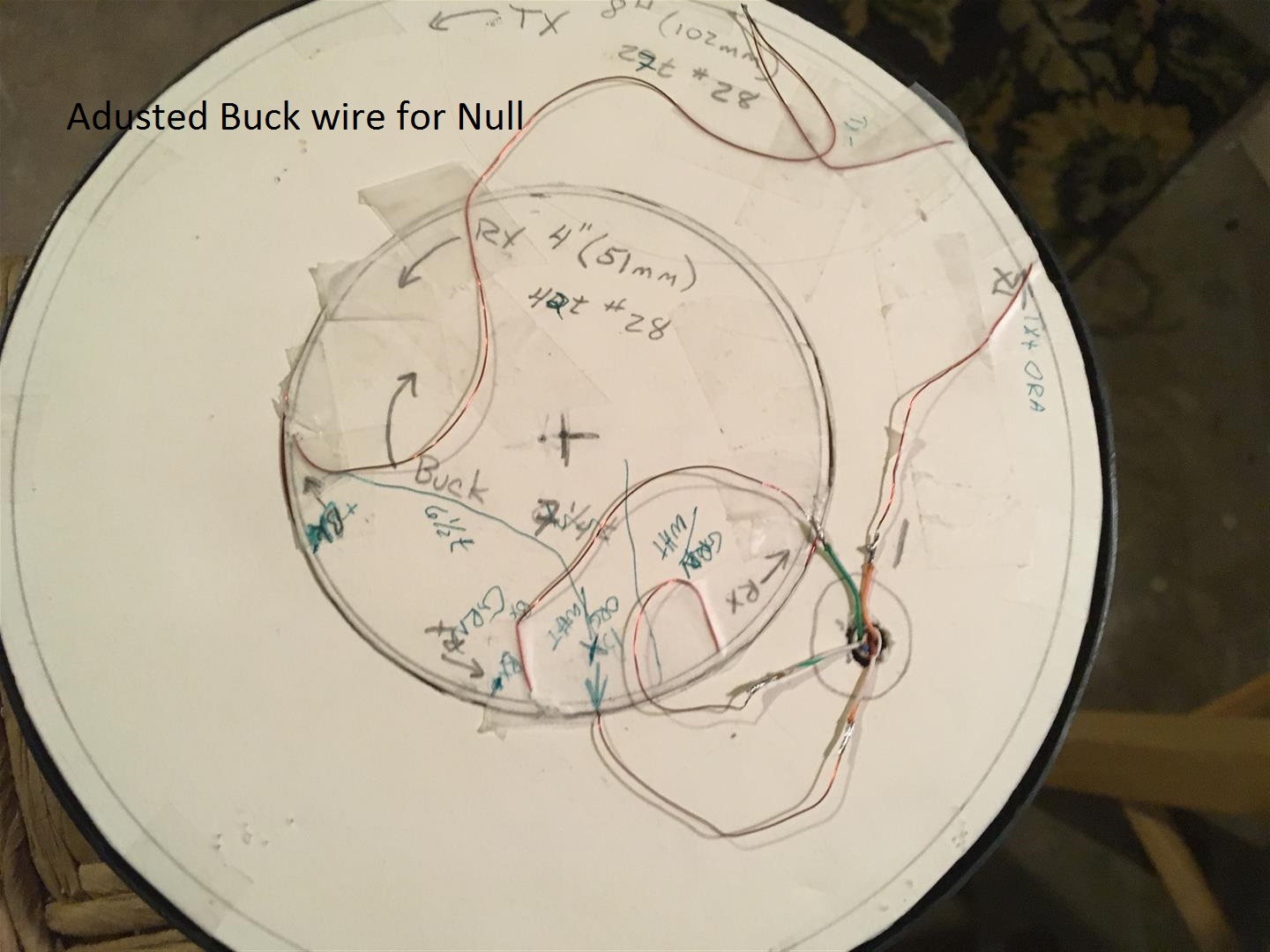

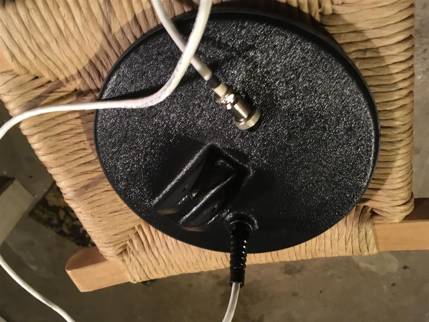

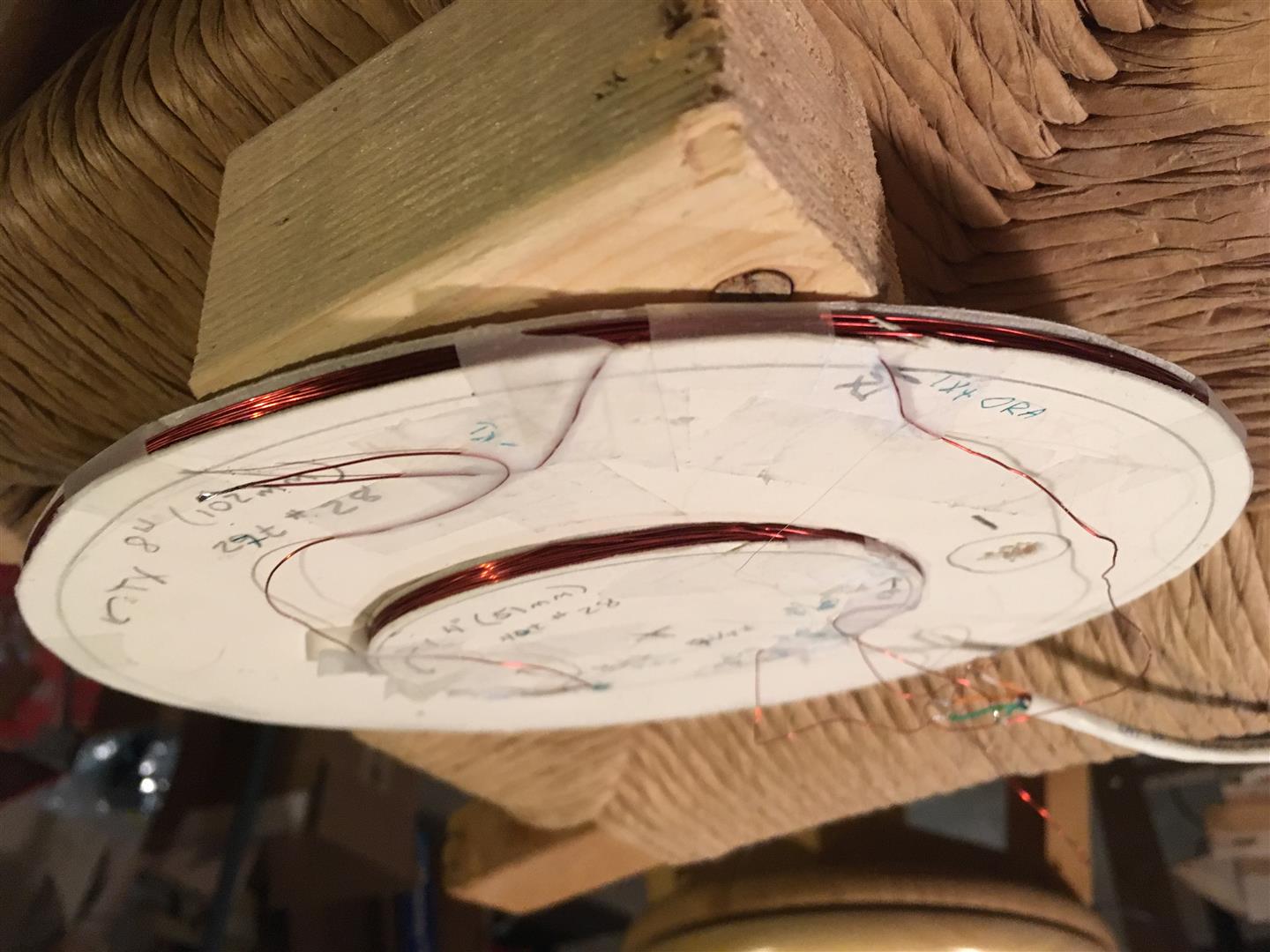

        Coil Photos:

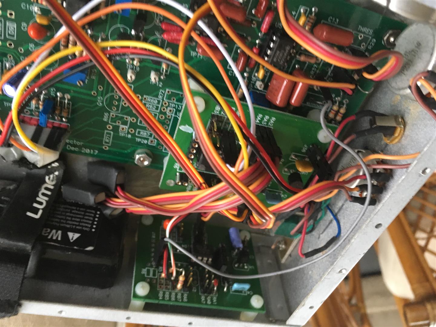

        PIC VCO board mounted inside case. Upper, left on side of box.

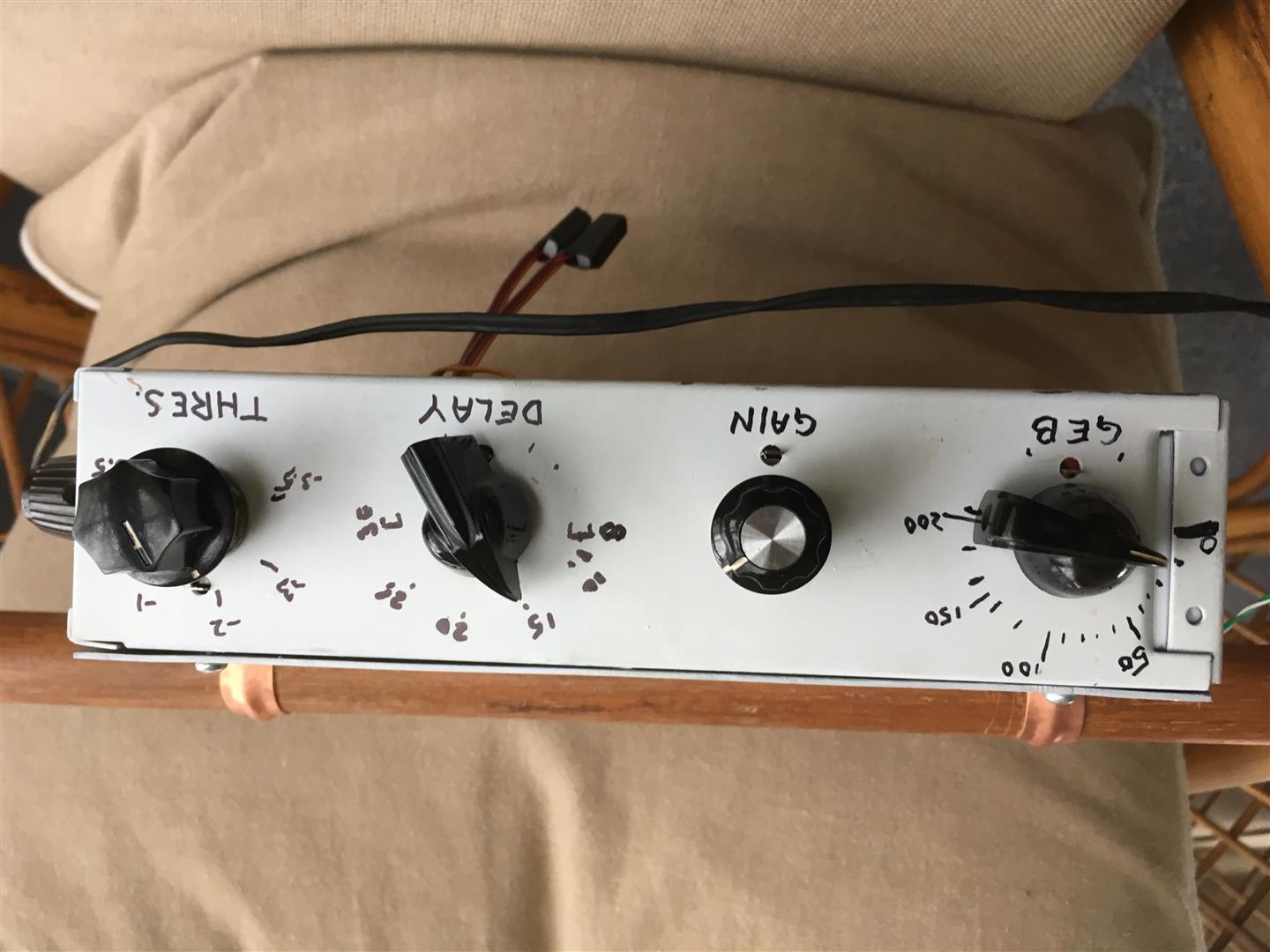

        Main controls with calibration marks. GEB & delay are marked in usec. Threshold marked in SAT amp output Voltage.

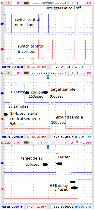

                        Including a picture of control sequence I use. Control sequence is correct, times might be a little different.

                          Your control sequence/timing looks very close to what I am doing.
                          TX - Delay1(8-35us) - Target sample (15us) - Delay2(20us-yours is 5.4us) - GB sample(15-200us) - then the EFE sample just before the next TX pulse.
                          With GB off, normally there is a lot more than 20usec between target and EF sample.
                          I have thought this but haven't seen info on how the timing should change.
                          Typically timing sequence without GEB is: Delay1 -Target Sample - Delay2 (100-400usec) - EFE sample. This is what I used in the first Code posted which just emulates the hardware timing of the original Hammer Head.
                          At least with using a microprocessor any timing scheme is pretty easy to do.

                              We are doing the Same timing sequence- I do the EF sample just before the TX pulse and it is the beginning of the timing sequence.
                              A big difference is that I run an adjustable GB and EF sample time whereas you seem to have both fixed to 100us plus the target sample.
                              Whereas I have a Target sample and the No GB sample the same (15us) then as GB adjust is increased the GB sample and EF samples increase by the same amount.
                              So with GB = 0: EF sample = 0us, TX =100us, Delay1, Sample1 = 15us, delay 2 = 20us, GB sample = 15us.
                              With GB = 50us: EF = 50us, TX = 100us, delay 1, target sample = 15us, delay 2 = 20us, GB sample = 65us.
                              This meets the diagram is Post #72 of: http://www.geotech1.com/forums/showt...-Balance/page3
                              I do have most of the timing adjustable using either a trim pot or panel mounted pot int the processor's ADCs.
                              Either way, hardware timing or software timing we accomplish the same thing.
                              Have you been able to Test the GB on mineralized soil? I haven't as yet so do not know if this GB scheme actually works.
                              Have you tried slightly different timing, delays & samples, and tested on mineralized ground?
                              The one thing I have found is with the GB sampling there becomes a 'pivot point' where high conductors cause a negative output from the integrator and low conductors give a positive output.
                              Other variations of timing does not do this.
                              • #45
